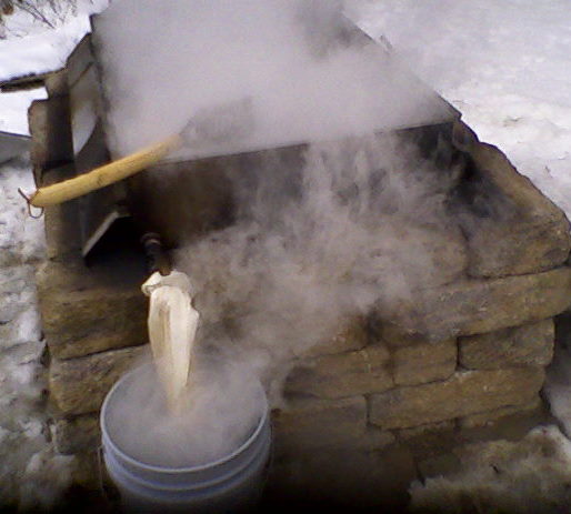

I'm pretty low on my leftover syrup so I'm making more had taps in trees for two weeks almost now and have almost enough to last for 2 years again. I thought people might like to see what I'm doing. see attached pics.

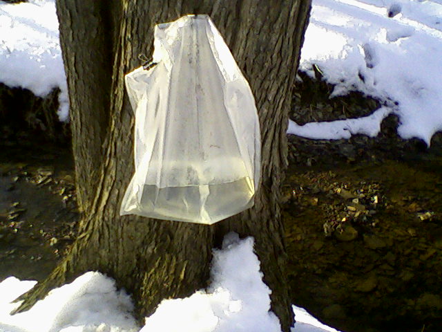

sap bag on tree hanging get 1~1.5 gallon a day from ave tap
running into a 5 gallon bucket using taps and tubes
boiling sap into syrup

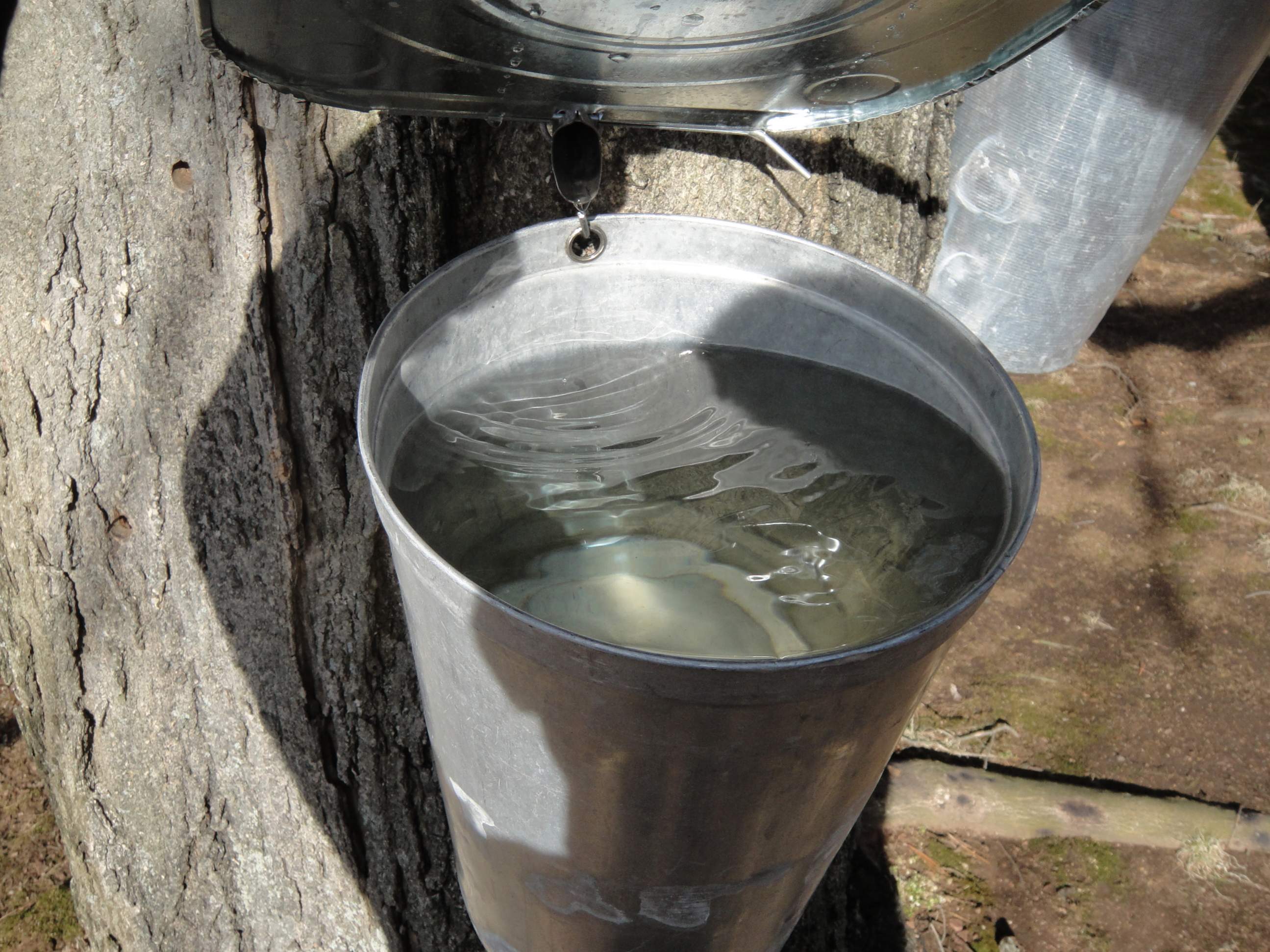

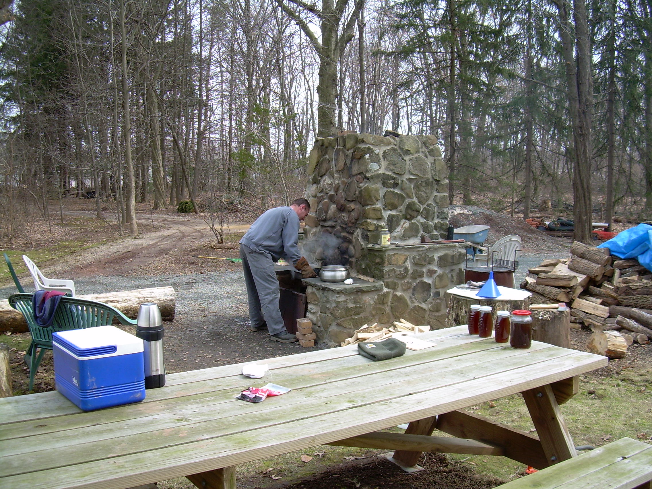

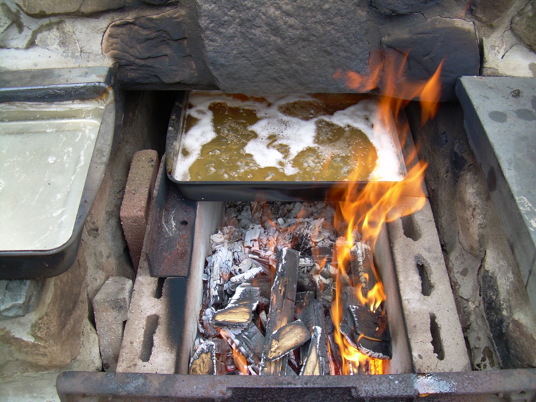

Looks good, I just started fooling around with making syrup last year when I tapped my one maple, got enough sap to make almost a gallon of syrup.
This year is bad we have had above freezing temps every day now for close to a month, even the nights have not gotten below freezing for a couple of weeks. I just tapped this week and hardly got a gallon of sap:(
I think I missed the boat by a couple of weeks, I just thought it was way to early for spring in the first week of February. Maybe I could buy some sap from a bigger operation, I do love maple syrup.
these pics are from last year.

It could be that there is some freezing that keeps the sap flow down in AM some but normally the tubes being smaller melt faster than the large wood tree,
This is the first year I tried the bags, there is a harder time pouring the sap out of the bags, I get a lot of spillage and bark bits in the sap from them. The bags also are up hanging off the tap where sun gets on them and will cause more bacteria to grow faster.
anyhow I cant really say if I get more from the taps & bags or taps lines & buckets. I have larger trees tapped on bags in more remote area than the smaller one from tubes... I have been getting close to 2 or more gallons from a single tap on the big tree in the pic.
it sets on top of the creek so sugar content may be lower.
the guy that got a gallon of syrup from one tree, not sure how as it takes 30!45gallons of sap to make one gallon of syrup, though thisis to grade where as boiling to lower sugar content is possible.
I boil to temperature 219F +/- a degree which is old way, new way is hydrometer but they are expensive and easly broken... dont ask how I know :eek:

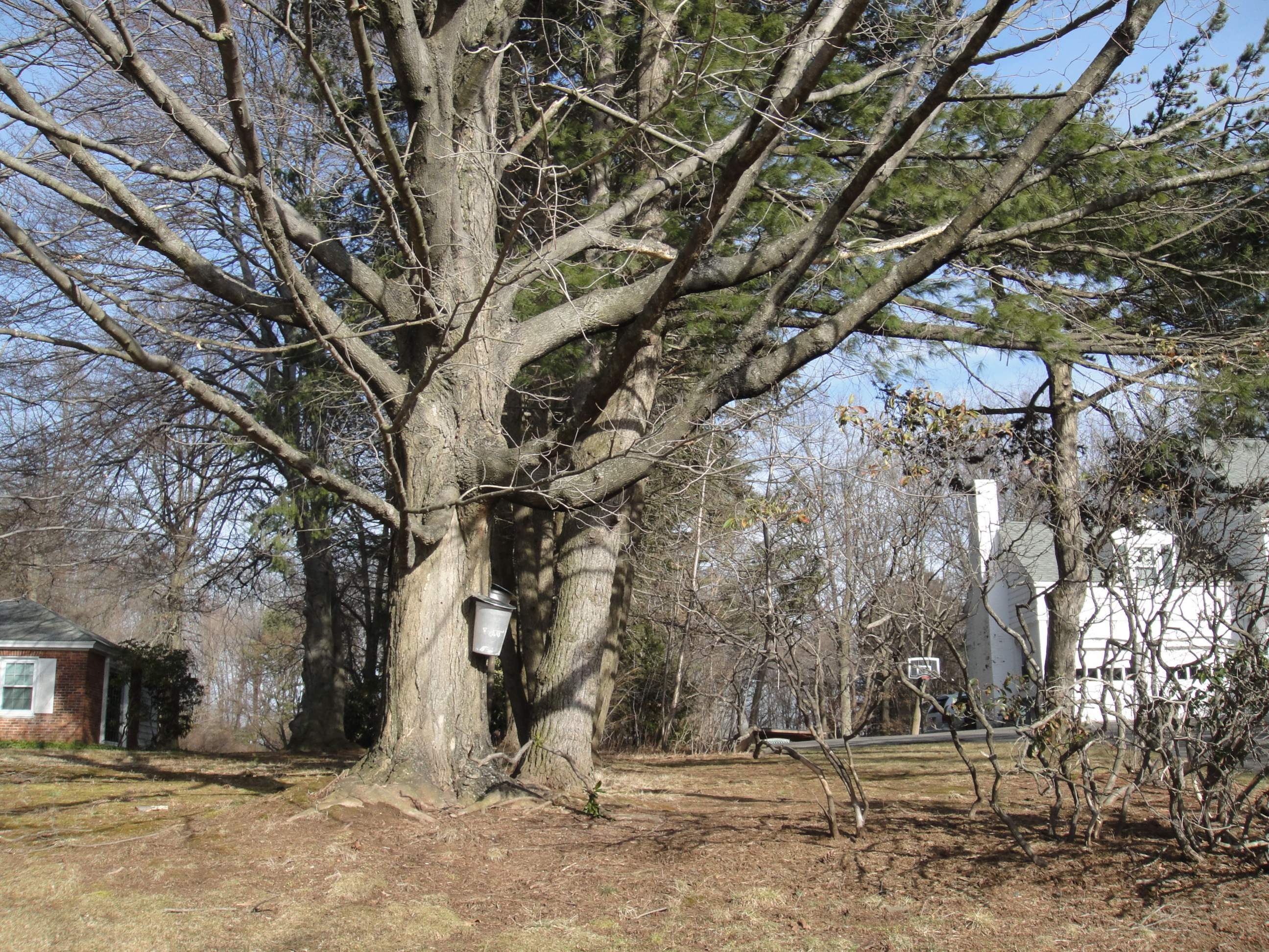

Not quite a gallon, but yeah this tree was great last year, easily got over 30 gallons of sap and had a high sugar content.
I've got all oaks and pines on my property, this one maple is right on the border line but the south side is on my side :)

Supposed to be warm tomorrow so I will be checking everything. I am also going to go from propane to wood for the fire source. I need to build a wood fire burner of some sort...
thinking a 55 gallon drum cut in half length ways with an opening at the top towards the closed end for the pot to sit - feed wood from the front.

How about just a block or brick walled arch, easy to build and adjust as needed, not sure how the barrel would work.

Hollow blocks will crumble from the heat sometimes so be careful you don't want to lose a pan full of syrup.
I have a stone BBQ fireplace, it's not the perfect set up but since I already have it I use it, I choke down the width with blocks. The idea is a long narrow fire chamber to really concentrate the flame and get it licking the bottom of the pan over as wide an area as possible.
Good luck,
JB.

Was a great day yesterday, Sat, high close to 50, my pails were overflowing by 3 in the afternoon, that's 5 gallons from 2 pails, last year I had 3 pails on this one tree so you can see not to difficult to get a gallon of syrup from one good tree. Don't know if that's extraordinary for a tree to produce this much sap?
My problem is storing it long enough to make it worth while to boil, it's so warm in the day it's hard to find a cool spot.
JB.

That looks like a good tree, I think the large # of branches probably helps with the amount of sugar & sap it needs/stores for spring from the year prior. I have seen a lot more sugar from yard trees though.
