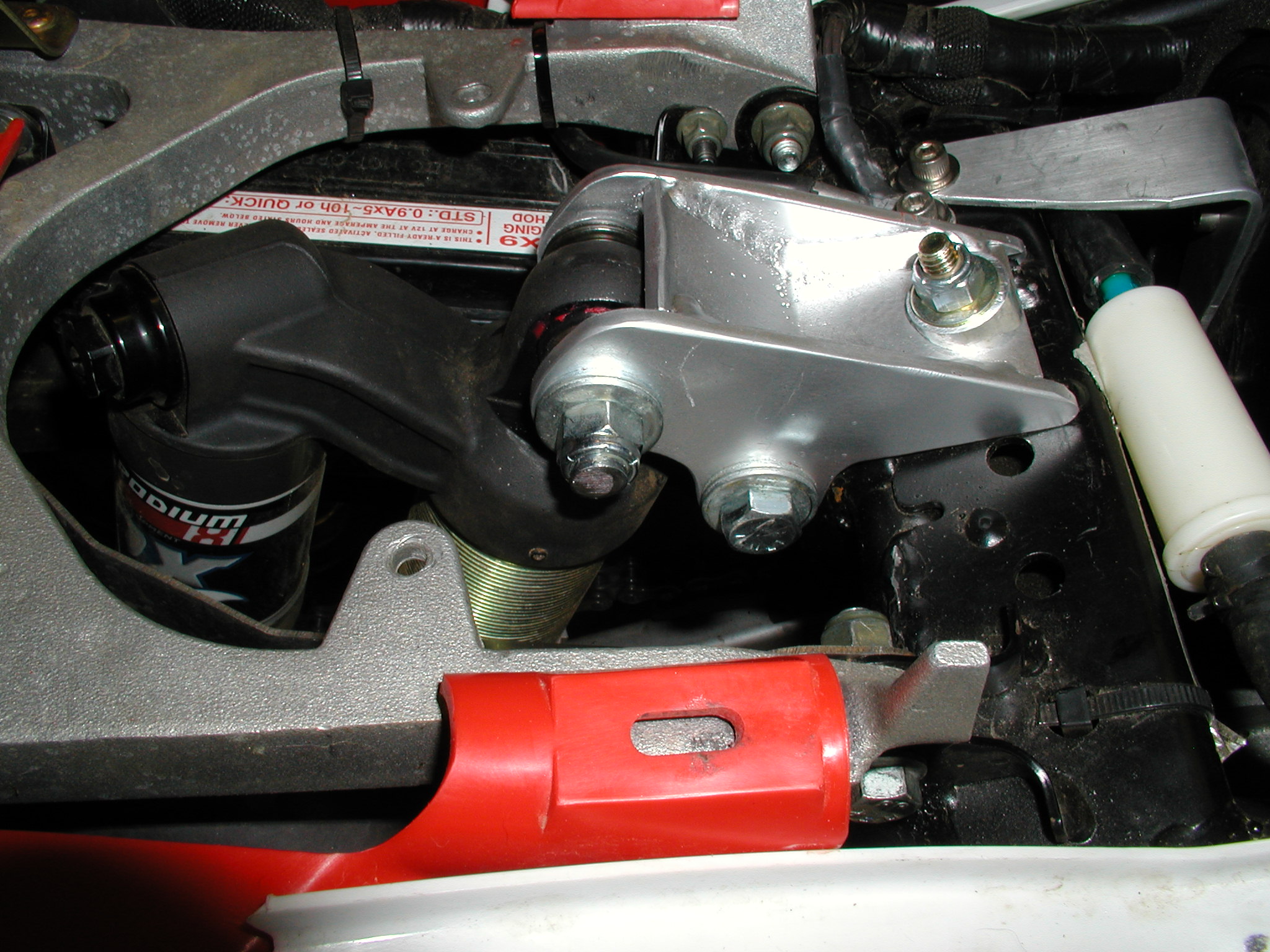

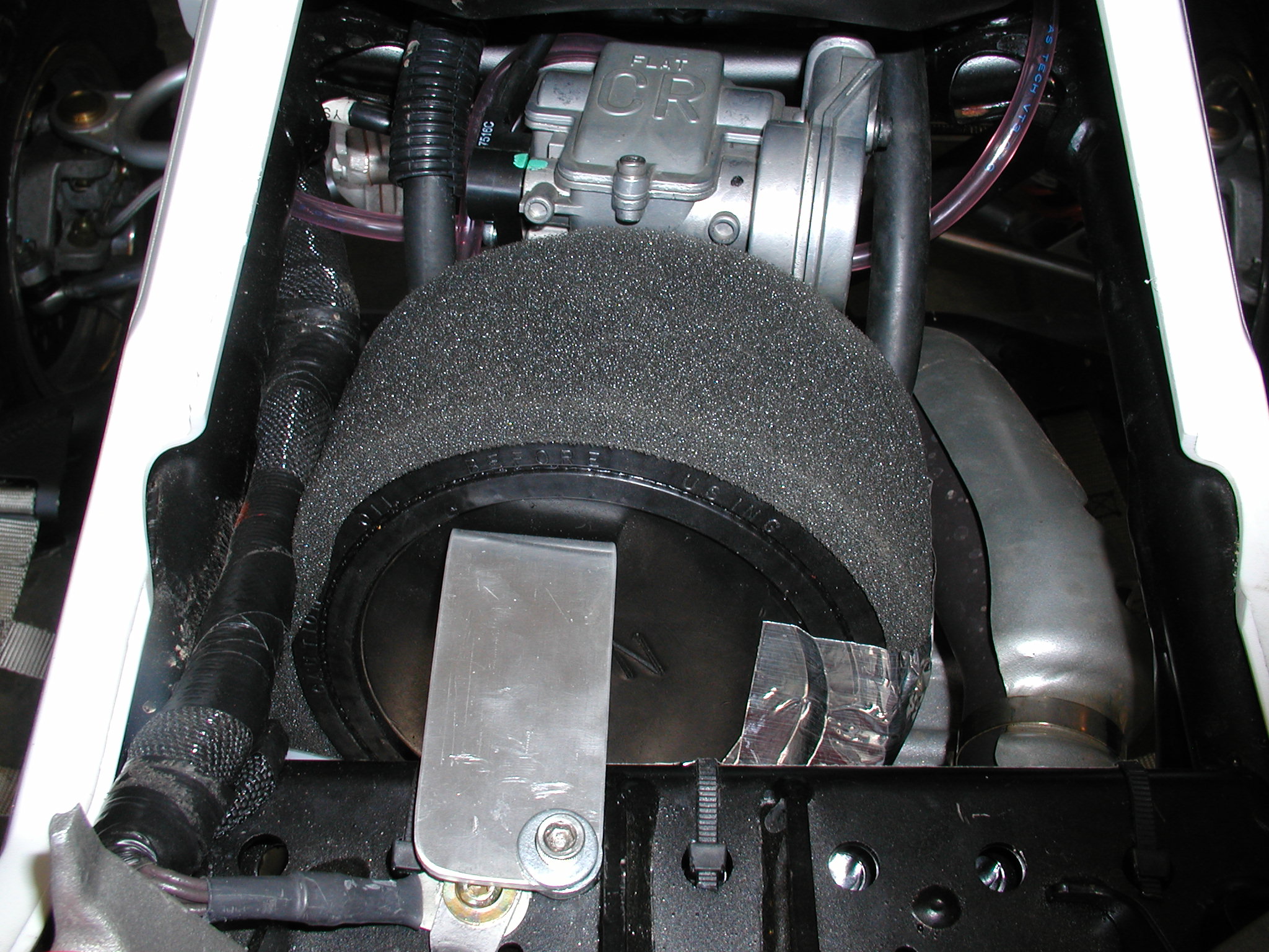

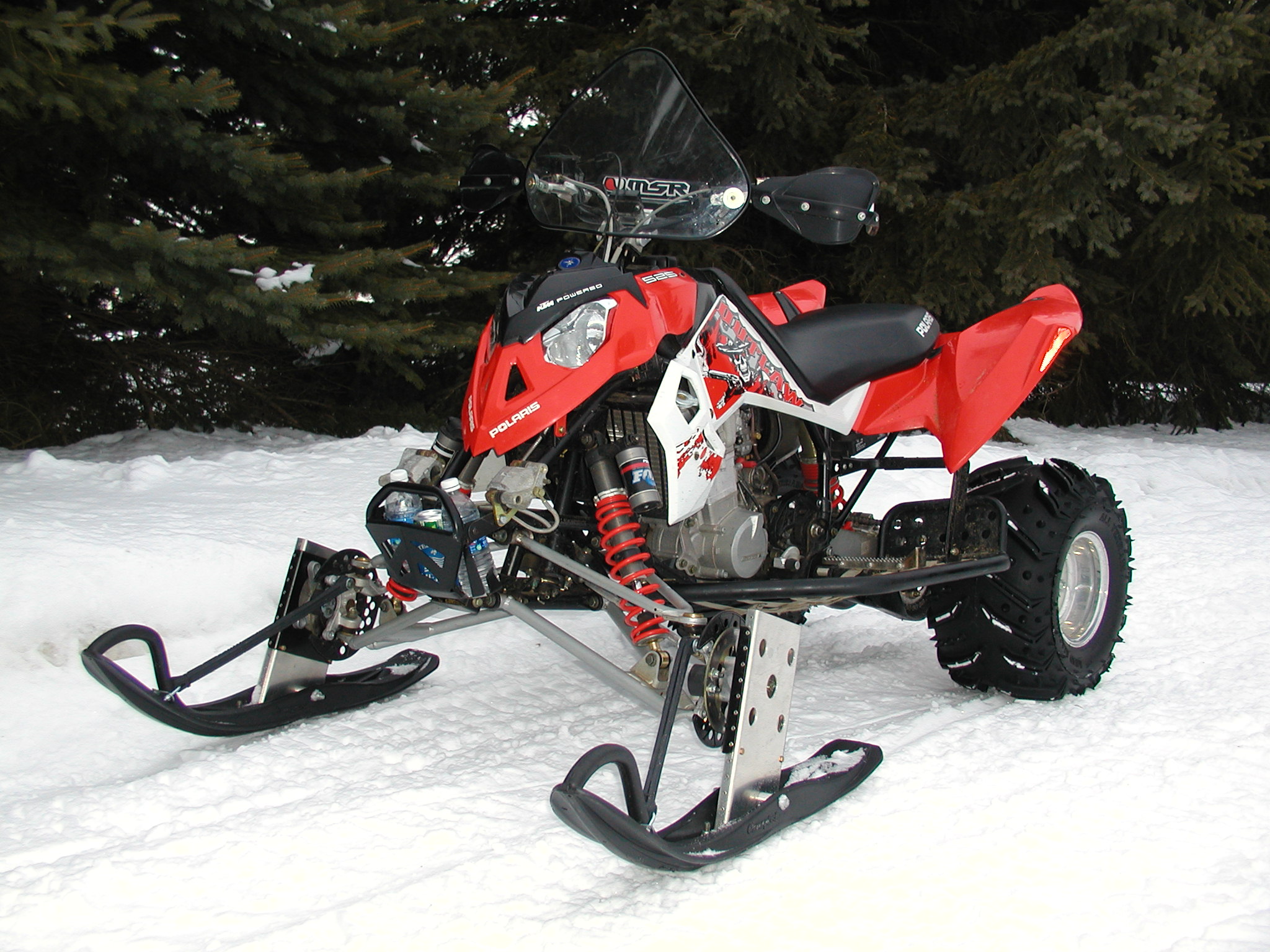

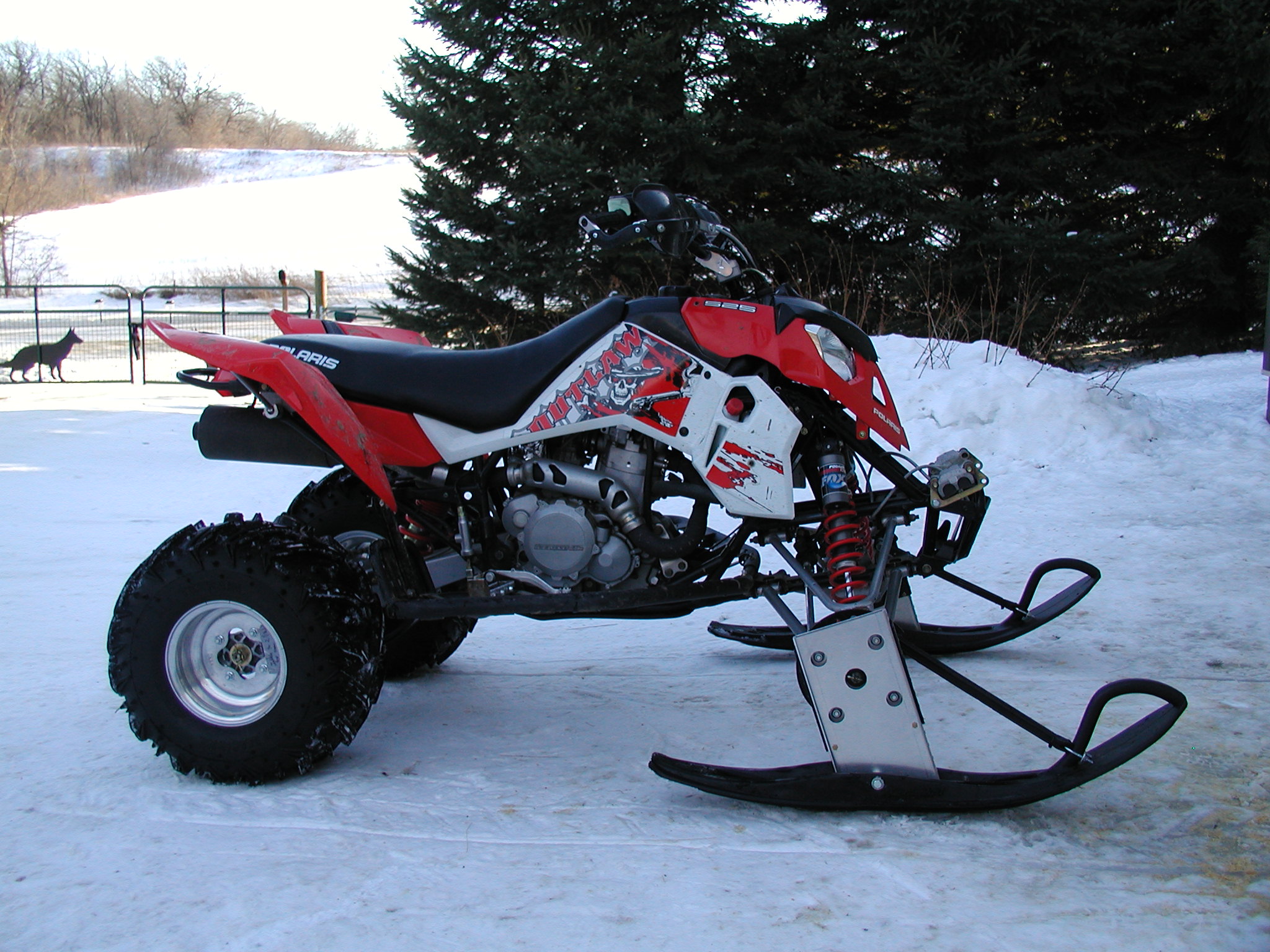

P1010224.JPGP1220254.JPGP1010172.JPGP1010230.JPGI still ride sport atv. I have a 2008 Polaris Outlaw. Its KTM 525 powered. Its faster than any human needs in the woods. So of course I had to improve it. I took off the cruddy airbox that was far too tiny, and replaced it with a K&N round plus dry foam over-wrap. Once rejetted, this setup is like running a bare naked carburator. And I re-mounted the rear shock to lower the ride height an inch or so, with a custom upper bracket. But the coolest thing is I made skiis for it. Then running an oversized mudder tire on the back with 0.75 pounds of air in them, and it goes like mad in the snow. Might have a couple pics here...
