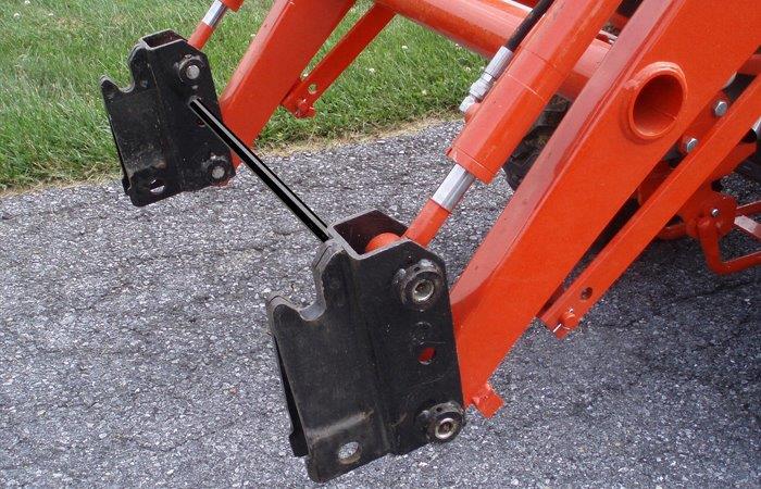

Just acquired a 955 Deere with a 70A loader. It has the old style bolt on mount. As I prefer the quick change system I have on another tractor.... I was wondering if anyone modified or bought components to change.
   / Anyone change their bolt on to a quick change bucket mount ? #2
Almost any non quick change can be converted to quick attach. I’ve done a few.
Some are relatively easy, some difficult and some “don’t bother”. A lot depends on the original configuration and what style QA you want to match or convert to.

I built a loader and bucket for our 4110 Deere. New Holland had the simple attaching point, an angle V bracket at the top and a slanted entry at the bottom. I used 3/4" rods through the mount to secure it.
I was trying to find a simple way to attach this 70A loader bucket without cutting the ears off completely while retaining a angle bottom locking point. Not an immediate need but still requires some thought to make it solid yet simple.

I had an 855 and wanted the SSQA. Found a thread on this site of someone who had built one....way beyond my capabilities. Searched for a commercially available kit but could not find one.
In the end, the JD loader had so little capacity it did not make sense for me to have a custom one fabricated.

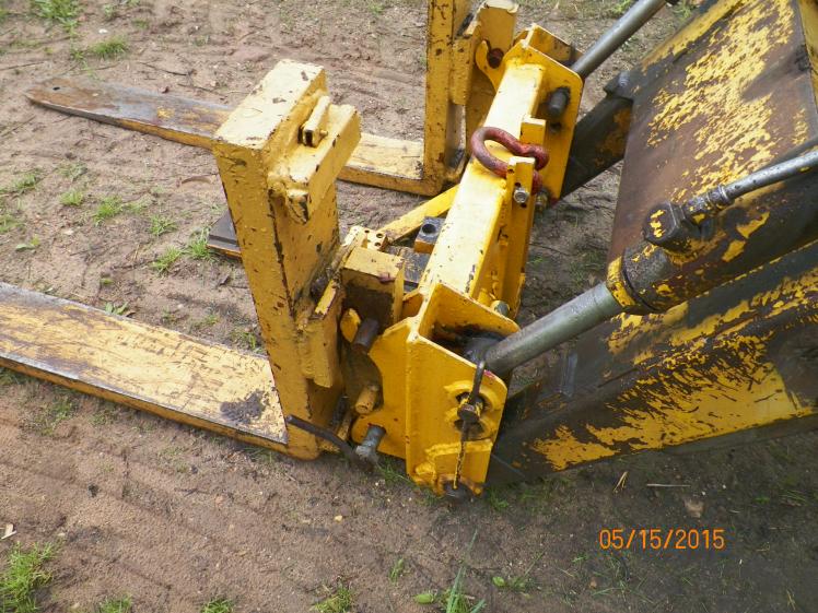

This project is on my list of things to do. My goal is to build a semi quick attach for lack of better term. Something I don't have to modify the bucket and fork carriage I already have. I'd have to dig up some old pictures but it basically has a U shape on top that hooks onto pins that are left in each attachment. You still have to add the lower pins by hand but having the attachment hang from the top pins in the U shaped piece will line the bottom up.
Is that what you're looking for or are you trying to go with a skid steer style where you have to weld plates to the attachments?

Check out how JD did the 240/245/265 loaders. Bucket has top pin welded in place. Loader has a U to pick up the top pin, and a vertical pin, inboard of the boom arms, to lock the bucket on. Vertical pin is square, spring loaded, and engages a "loop" on the bucket.
