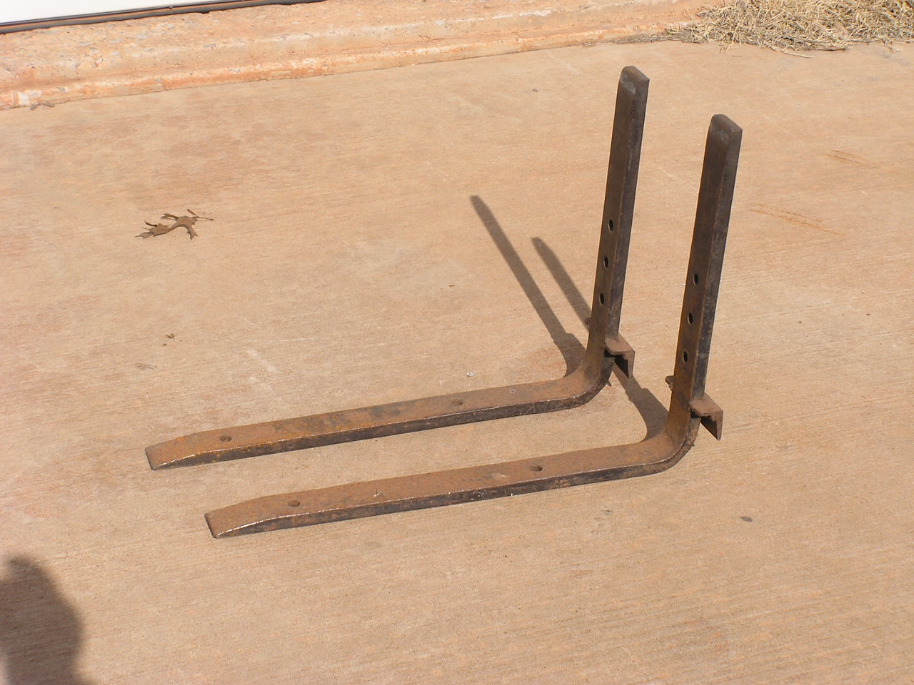

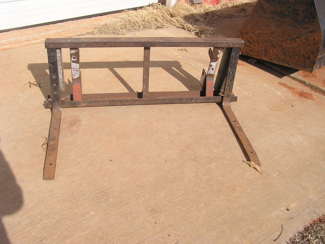

You might get some ideas from this pin on frame that I built many years ago, for some bolt on Brinly forks.
Welded on angle iron to hold the bottom of the fork.
