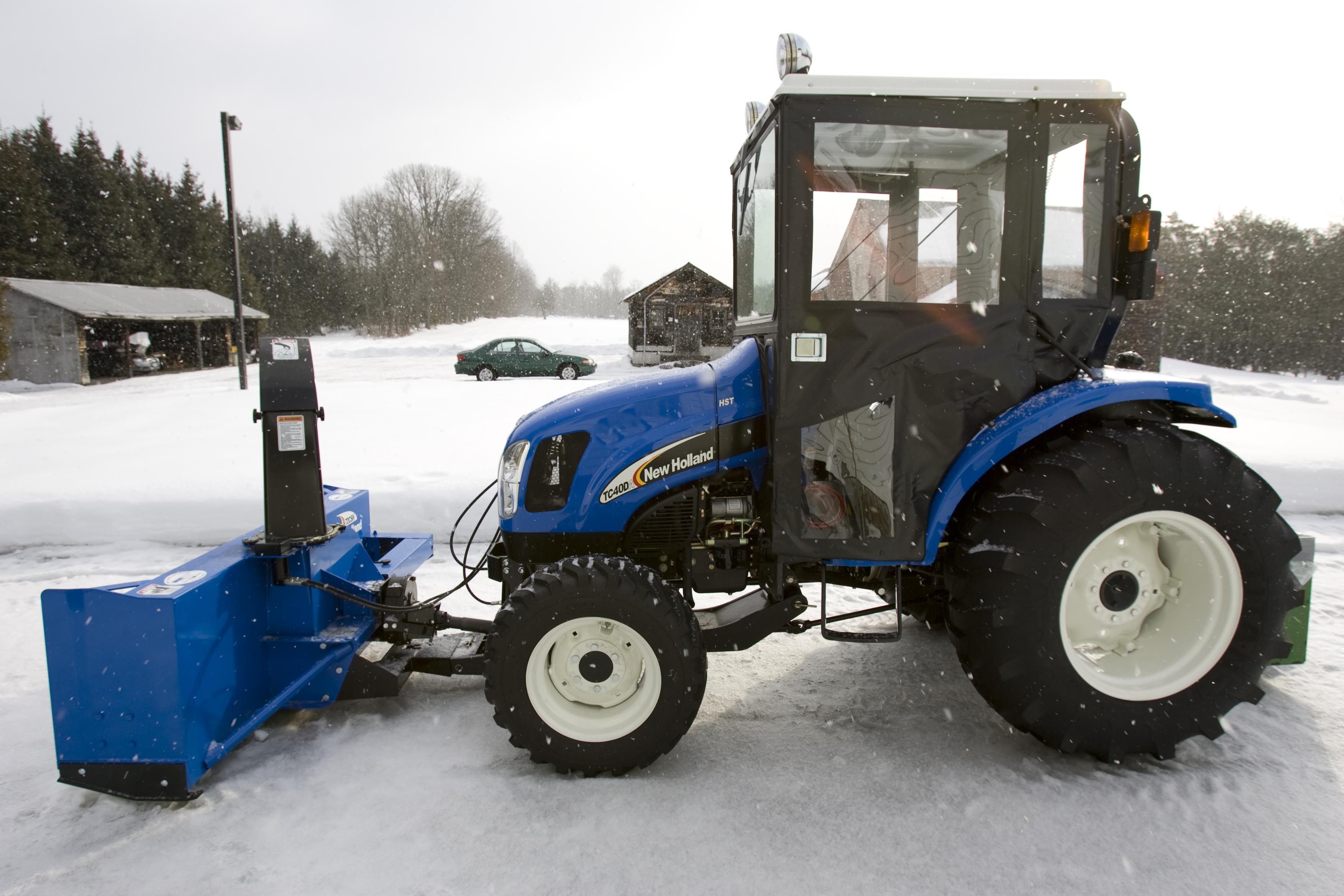

Just picked up an old 7 1/2 foot plow and had planned on using a QA plate w/ the FEL. However, I'd rather have the plow closer to the front of the tractor. Done a lot of searching here and have found several threads in other colors (especially green) on home built sub-frames. I know NH makes a front mount plow, but haven't found much info on that. Has anyone with a blue tractor used this method for mounting a plow?

The only thing I can tell you I had a TC 40 DA with the front snowblower the subframe was the same for the front plow and Broom attachment, you could take it off during the summer or leave it on quite sturdy and around 265 pounds the brackets would be left on and they would not interfere with loader , I would try to mimic that design so the plow is not pushing on anything that it shouldn't be. I'll see if I have some pictures of the old TC 40 subframe and I don't know how much it cost I bought it as a package deal with my snowblower. As far as making a connection to the subframe I'm sure that would be no problem. I was thinking about doing it myself, rather than put a plow on my loader arms take care

Pictures would be great. I don't know if they still sell the frame, but I would love to find one or build my own. As always, the cheaper the better.

here are some pictures I posted on this site. I'll try to find ones of the actual mount itself, but you get the general idea take care

That really helps. I didn't expect it to be so low - or solid!
