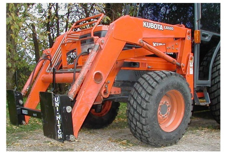

There are a lot of manufactures of QA (universal skid steer) adaptors. I got a Kasco, Unihitch from my Kubota dealer. Around $500.oo… See attached picture.
What ever make you get you will love it and you will be able to swap out buckets forks boom attachments or almost anything made for most skid steers. You will come across a LOT of different attachments that you can accumulate just because you can now use them. You can also weld adaptor plates to your original bucket, or get pin on adaptors for the bucket… I have yet not had a need to use my factory bucket as my 4n1 is so much handier. KennyV.
