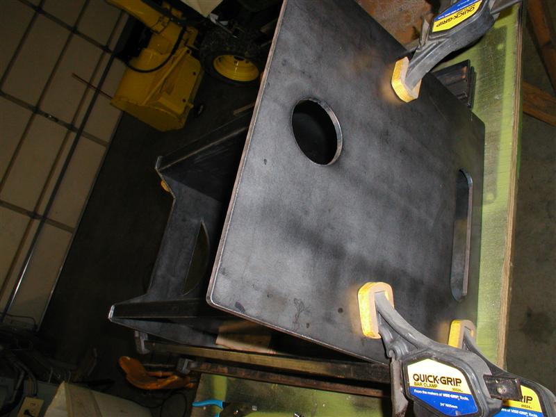

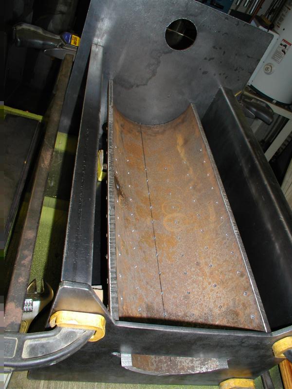

Living in southern Minnesota, I started one with the intention of burning dryed shelled corn in it. I stopped construction before finishing the burner assembly itself. I decided to instead build one that burns cob corn. Cob corn can be simply dried in a crib for a month or two and will then burn well. The cob itself also adds a valuable source of heat. Cob corn is so much cheaper than shelled corn it is rediculous. The cost of drying shelled corn is too high now with high LP gas prices. I figure I could raise about 5 acres of scrubby corn, harvest it on the cob with simple equipment, dry it for 6 weeks in a crib for free, and have a winter's supply of heating fuel. To do this I must overcome one remaining challenge: handling of the cob corn. It is very convenient to auger the shelled corn, metering it into the stove burner automatically bit by bit. But cobs are a challenge to handle. They don't auger unless your auger is about 16 inch diameter. So I am back to the concept phase of the project. I am attaching a photo or two of the original design burner, for shelled corn burning. The parts are jigged together but not welded in these photos. They never did get welded, still laying around the shop in a pile.
Why not just coarse grind the cob with the corn on it after you dry it?Problem solved!
   / Anyone biuld an Outside Water Boiler Wood Heater? #9
Grinding the cob. That's worth considering. Dry it on the whole cob, then first thing when removing if from the the drying crib run it thru a grinder and into an auger, then on to the stove. Interesting. Will be thinking it through. Thanks!
