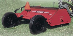

If you are still shopping and want a heavy duty flail mower you should also look at the Hiniker 5710 flail mower.
It is a six foot cut flail mower with cup knives and it can be ordered with a ratchet jack or a hydraulic lift adjustment
for the cutting height.
It is a towed flail mower with CV joints to allow for tighter turns. Using a CV joint/RZeppa universal joint is a bonus as it
will wear much less than a standard universal joint and it also has an overrunning clutch to protect the drive line and
tractor.
tractor.
I wonder what the HP requirements are for the Hiniker 5710 flail mower?
I didn't see it listed on their website.
Carey
