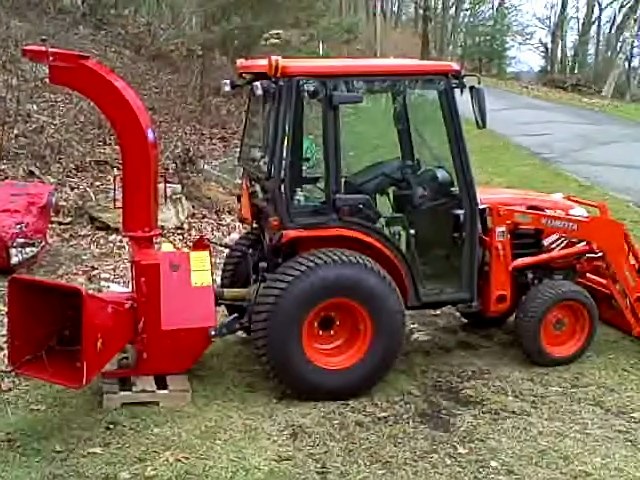

   / Anybody with a B26? #6
If you want me to post a photo of the hitch on my B3030 let me know.
