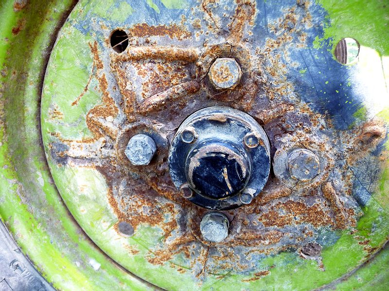

Yep.
Both front wheels on the YM240 (YM2000) when I bought it. Cracked, welded, then cracks continuing to grow. One of the wheels has "$20" on it so it must have superceded an unrepairable wheel.
I bought a pair of good wheels from the regional VN import wholesaler and installed one when I had a flat tire fixed. The wheel in this photo was then re-used to make a grinder pedestal base. I'm still running the other one, the "$20" wheel. It hasn't gotten worse in the 18 years I've owned the tractor. I can't imagine what the prior owner did.
p1640879rcrackedwheel-jpg.222147
