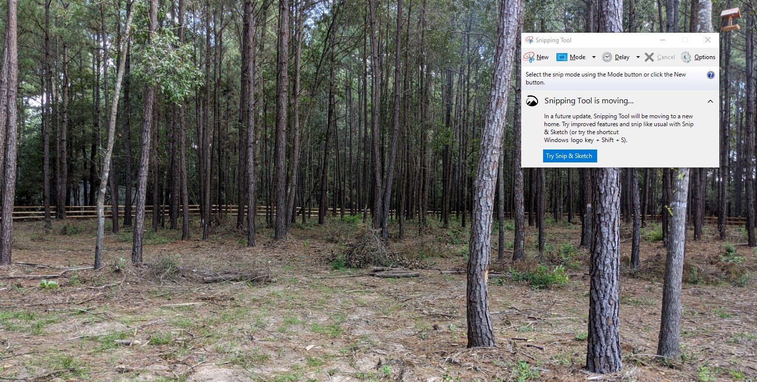

New here and a new owner of a small BX1880. I figured this thread would be a good place to start
Hoping someone can help me on deciding if a Flail Mower is a correct choice. My front yard is St. Augustine Landscaped which the MMM is working just fine. The back is... a project. I have been taking down some of the small Pines every weekend and base cutting the stump (a stump grinder is on my TO DO TO RENT list) so there are plenty of obstacles and plenty of other trees.
I need to do some light clearing but the back is a bit rough. The forestry mulcher and back hoe made some pretty gnarly ruts.. but I do not want the brush to come back with a vengeance. The small brush hog would be too difficult to maneuver around and I have read that the Flail can do light brush and saplings. Nothing bigger than the size of my pinky in width. Additionally we have been working on getting those vines pulled from the trees, so I am hoping the flail can eat those up. I have no qualms about taking it slow either. They Landsdown Moody dealer has a nifty little 40" flail that the 1880 can run, just want to confirm it can do the job. (tried to attach the picture, not sure if it worked.
*note this is North Waller County Texas and the soil is super sandy and soft; almost annoyingly so. There is also a good layer of mulched wood partially rotted; hoping that will be no issue for the flail.

I can circle back another year owning my FM62 Woodmaxx on a BX2200, and it's a great machine. This year I mowed a neighbor's plot of about 3 acres with 1-2' high grasses and the machine handled it fine. I mowed it the same pace as I was mowing my lawn. Maybe bogged down 3-4 times, but some of the stuff I was going through was some weird twiny grass.
One thing to note about flail mowers is you need to keep them slightly raised, or the skids will line or divot the ground when turning. I was watching those videos, and those users were putting a lot of lateral stress on their machines as they turned.
As far as I'm aware, flail mowers are meant to go in a straight line, then you pick it up slightly while turning to avoid this.
