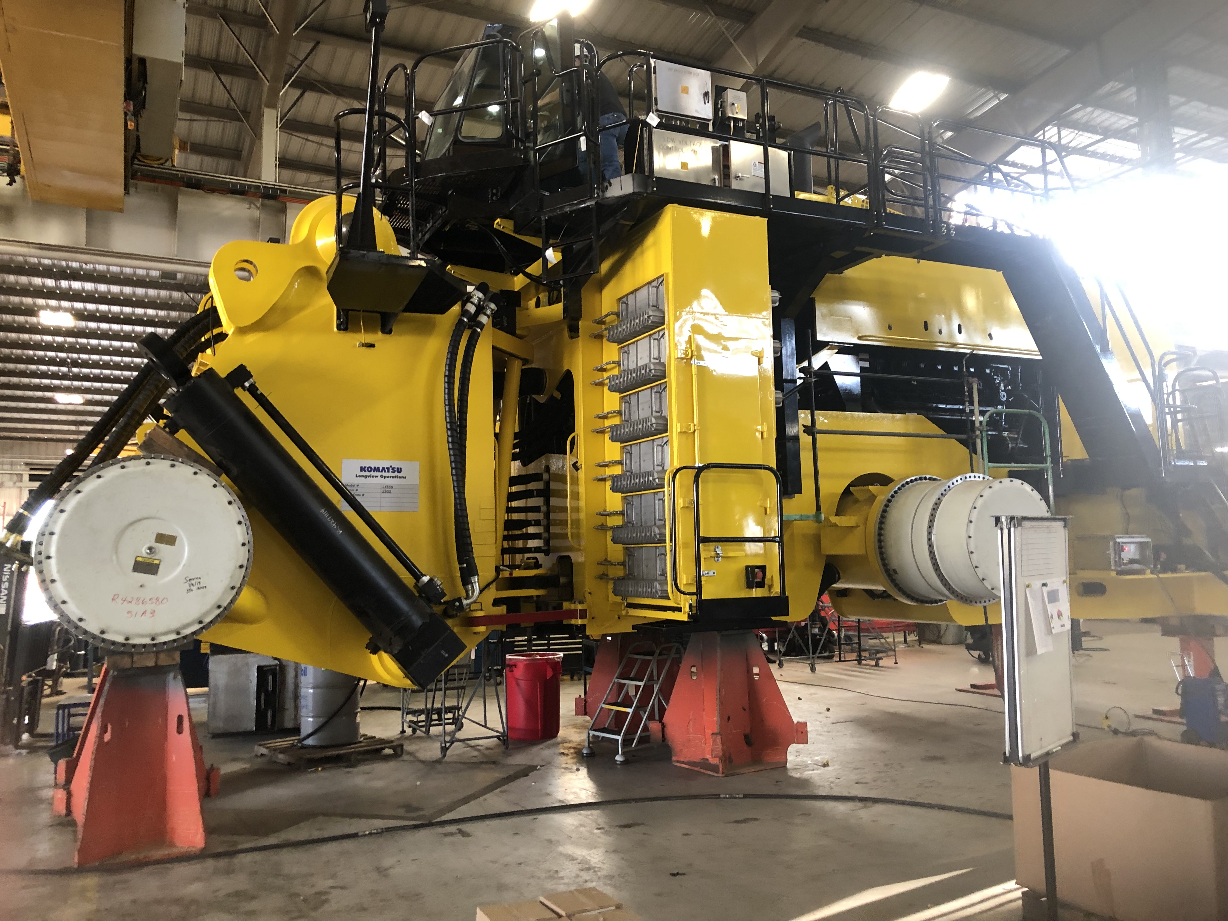

I'll give you a clue... it's hollow, the fillet welds at the corners are 2" (look under my hand) and it's fully hand welded.
   / Anybody recognize this part? #2
Looks like an excavator thumb. But hand welded?
   / Anybody recognize this part? #3
That's modern art. Actually a mustache from a new age work of art downtown.... Pretty impressive.
   / Anybody recognize this part? #5
It looks like a part from the latest EA WICKED Grapple.
Your Komatsu Visitor helmet is a big clue though.

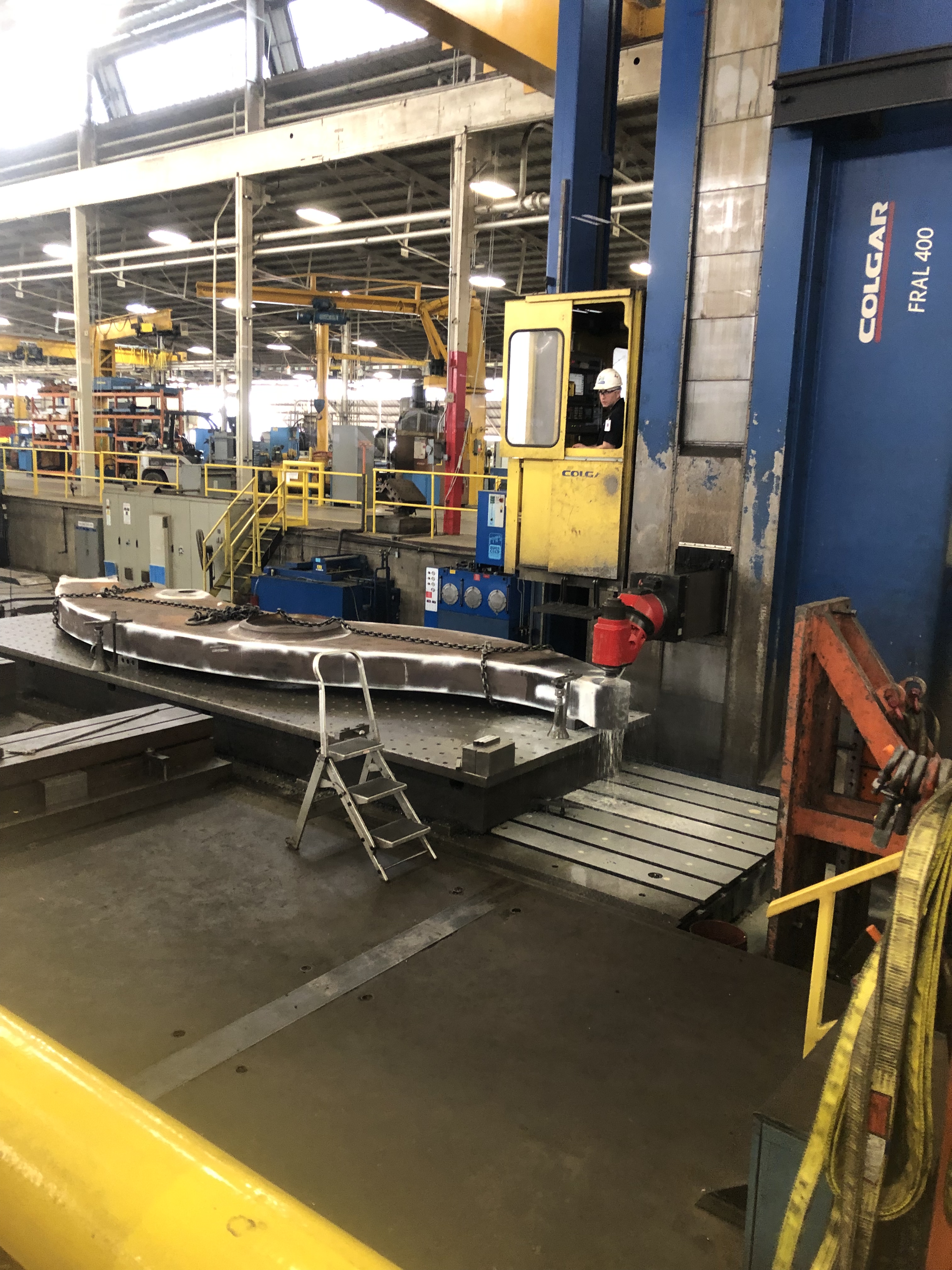

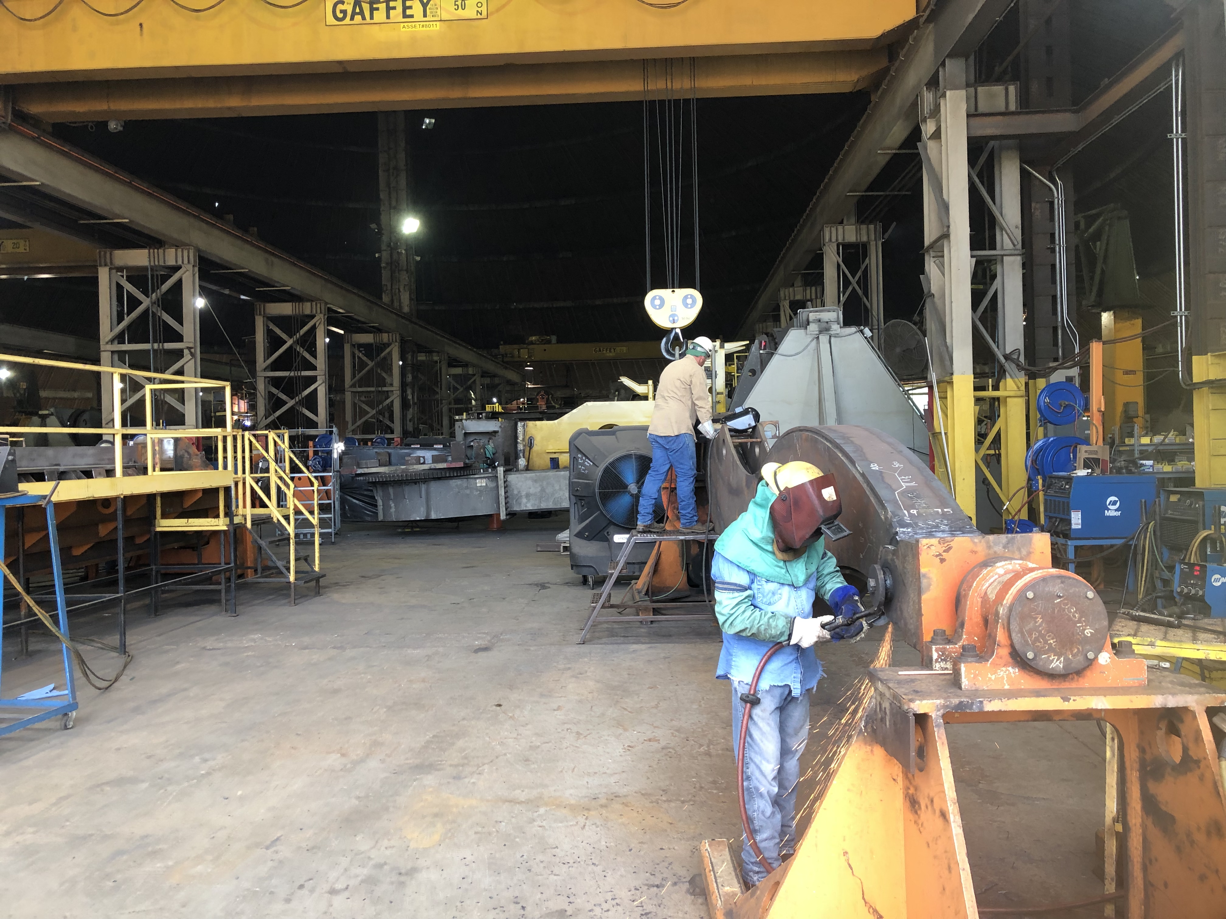

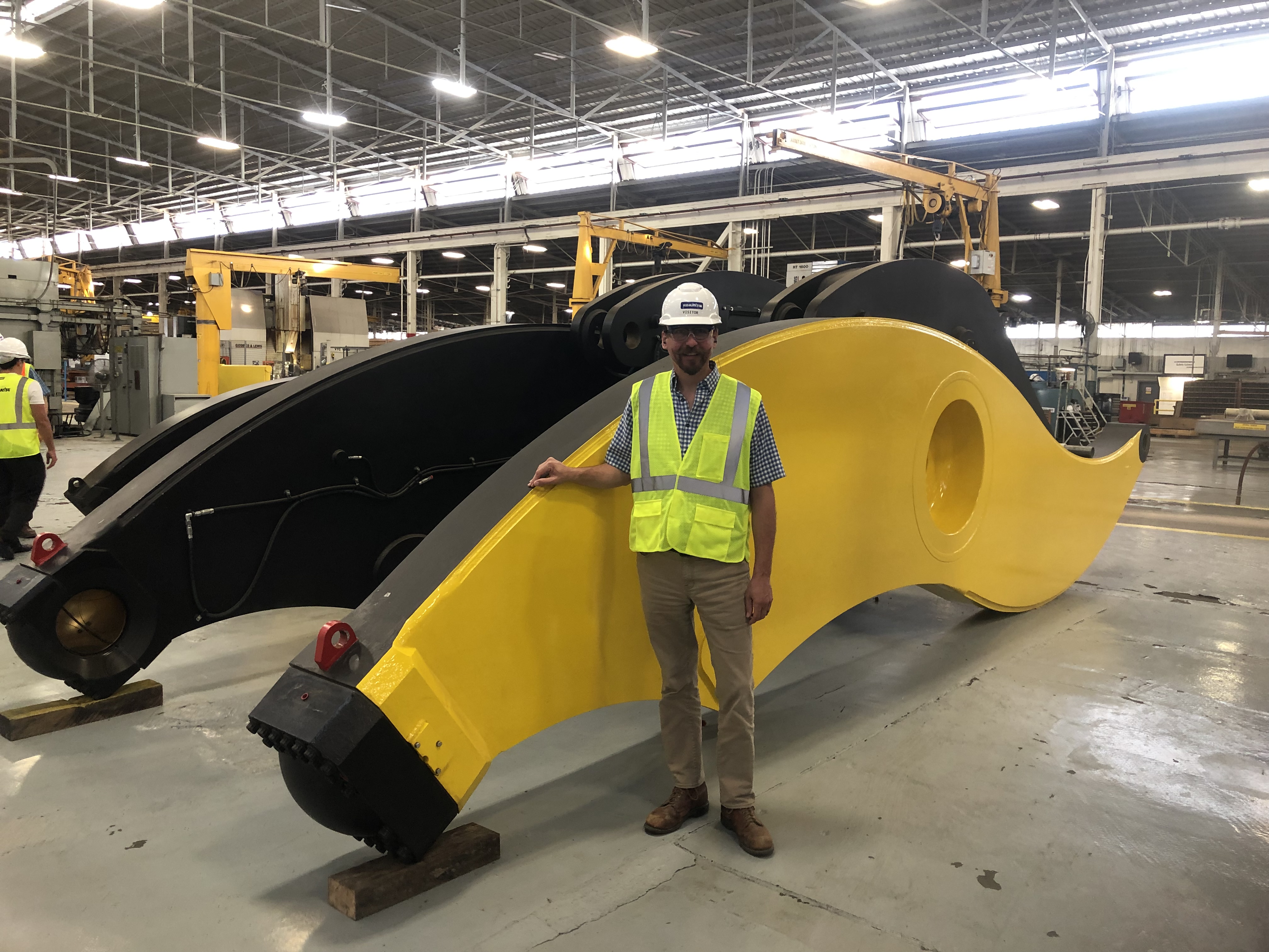

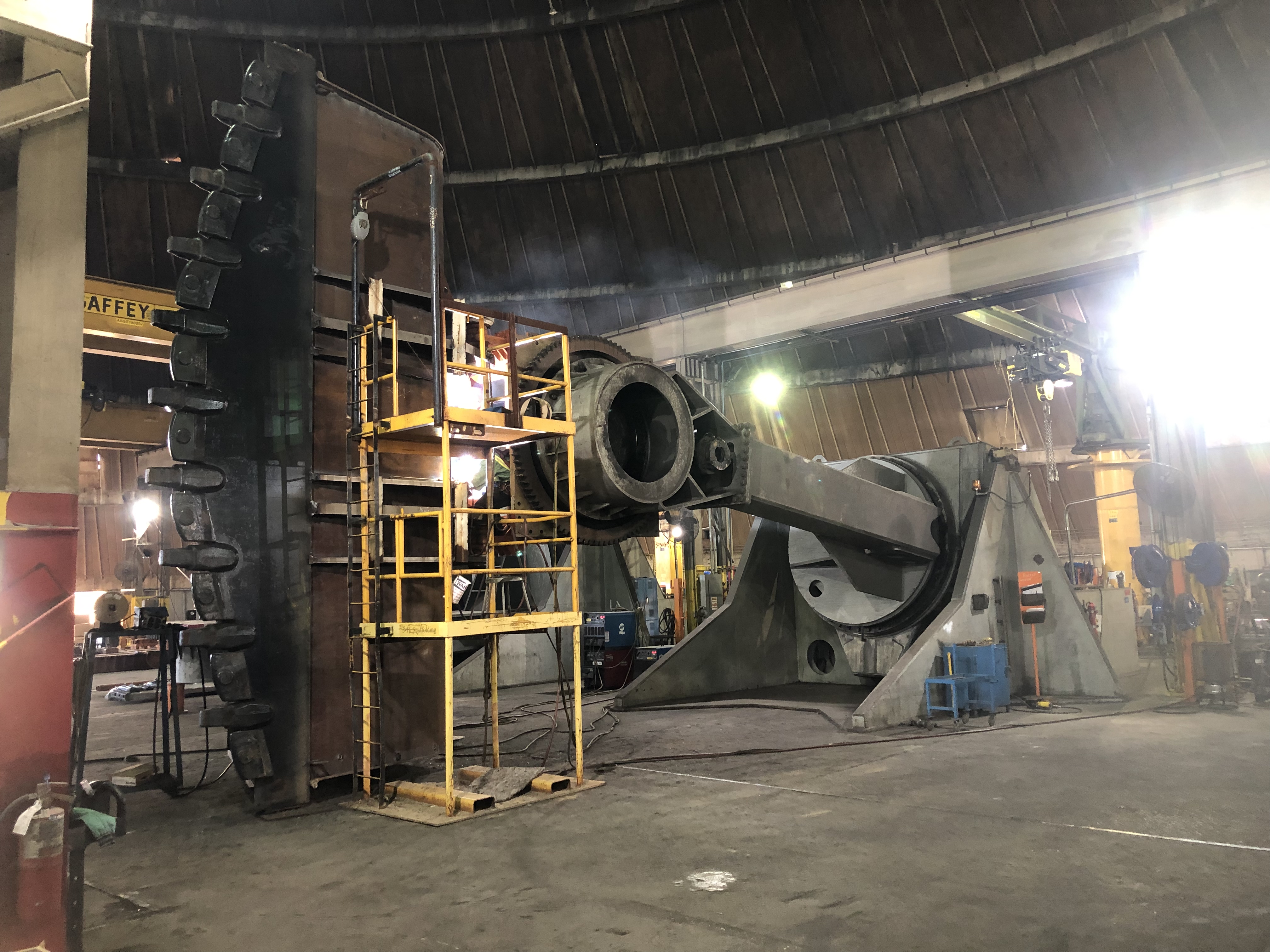

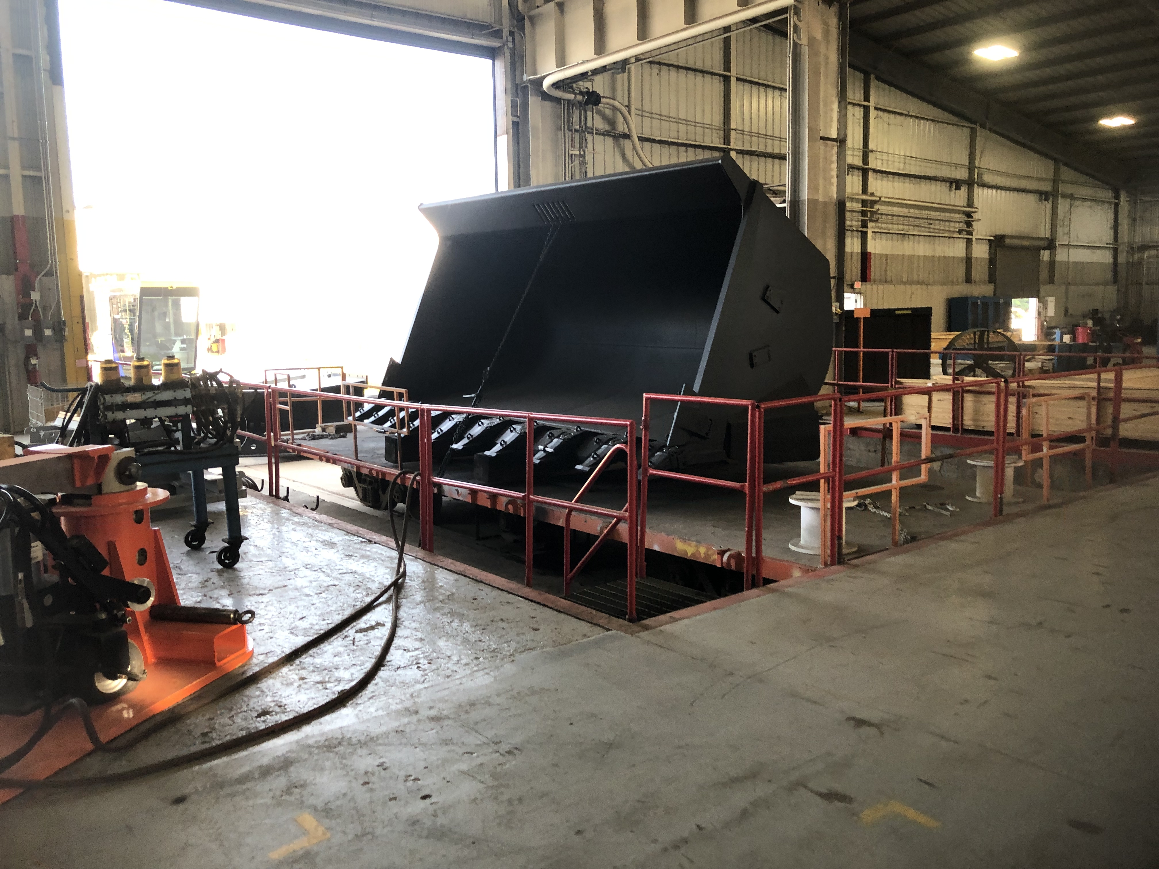

   / Anybody recognize this part? #7
The scale of that is insane!
Personally, i've never seen a "ride-on" mill before, but they have one.
The rotator holding the bucket is used to minimize the need for out of position welds. The typical welder setting was 400a at 36v. The bucket in the photos is the "small one" at 36 yards.
