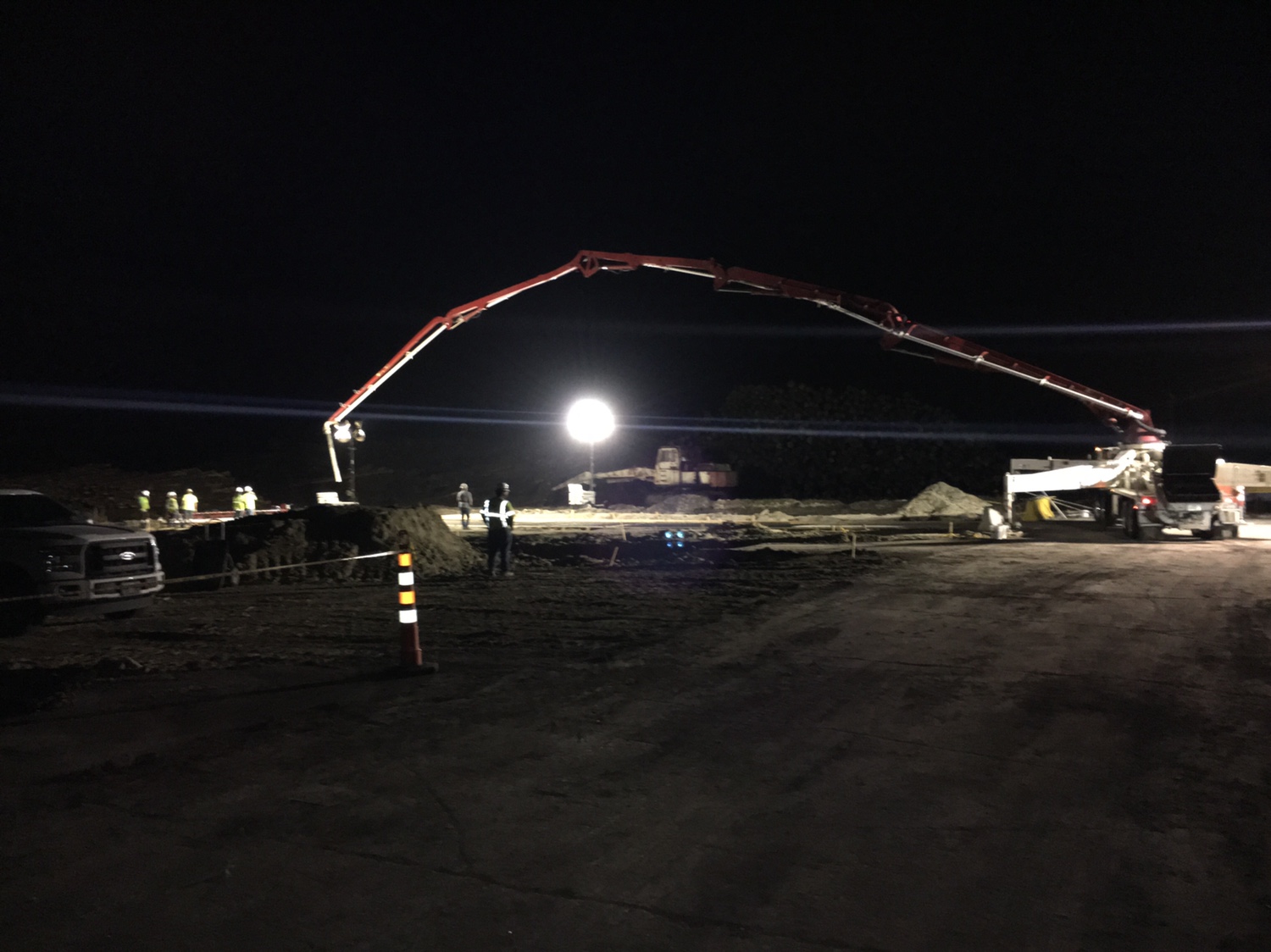

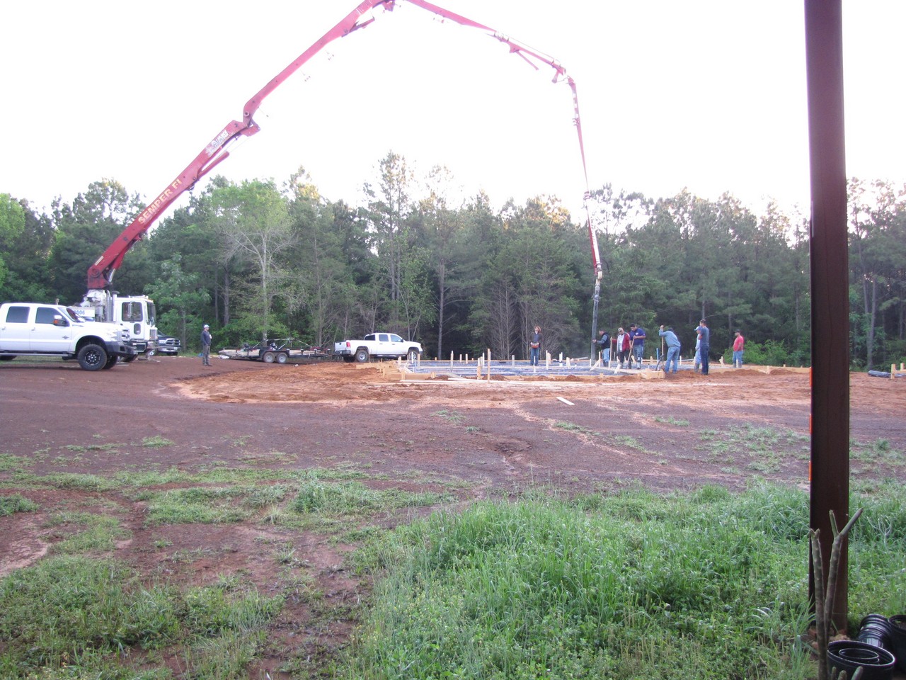

Pumper trucks come in different sizes, I know they can reach 100'.

From the front of the pumper truck to the far edge of the slab is around 80 feet.

This one would reach 120’. I don’t remember the boom length but it was ridiculous.

ABSOLUTELY.....have it pumped!!!
