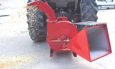

If your pine tree limbs are not big in diameter, you can have a small size flywheel such as 3/4" thickness and 20" diameter. Casting and its balancing this flywheel will be most difficult part of your work, but this is not necessary. Cut it from a thick plate by a plasma cutter, weld some wings on its back of flywheel and balance the flywheel assemble. Since you cut it from homogeneous plate, balancing will not be difficult. Then, get a hard material (best is "improved" grade 8) to machine its blades using a milling machine. Then, take the blades to a heat treatment furnace company to harden. Then, final process is grinding them. Mount the blades, flywheel, 2 pulleys (diameter ratio about 2 for 540 rpm) on a strong frame. Another important thing is alignment of forces; should be in the same axis not to cause vibrations and moments on the bearings. That's all. If these seem to be too much work, I can send you my home-made chipper (see attachment.)

Yeah, it's too much work. Just send me yours.
