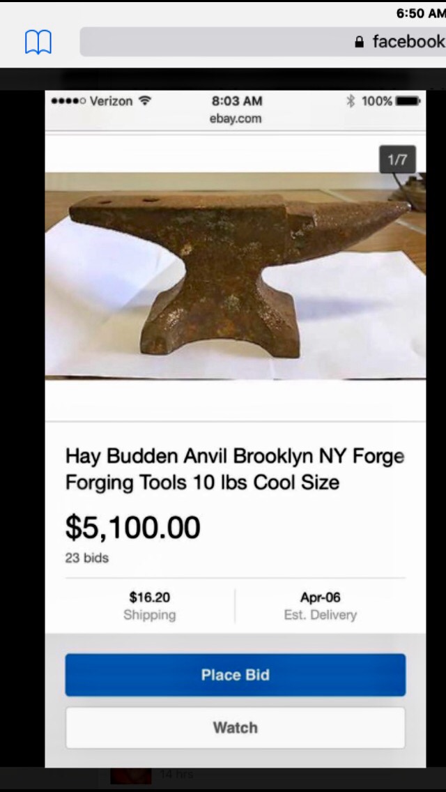

And just for fun here's a current ebay listing with 4 days to go on bidding. Yes that IS the correct weight. NOT a misprint.
Terry
It's the price that seems a bit weighty to me!
