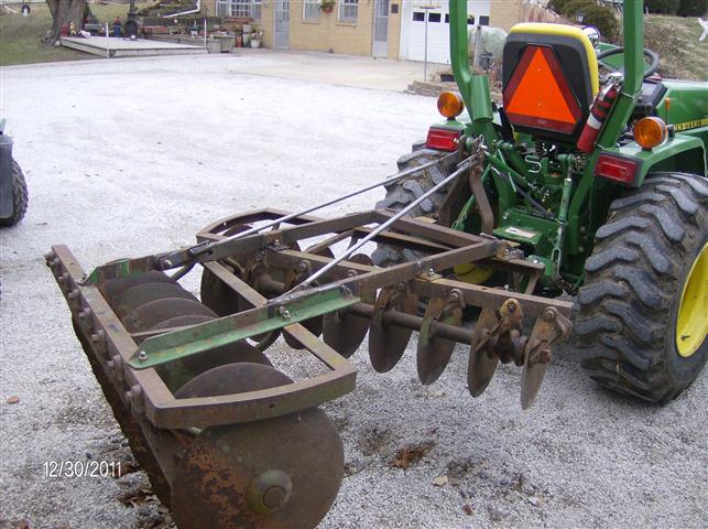

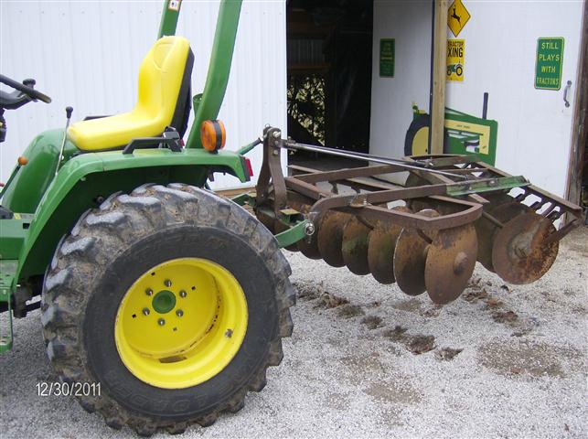

Not from ground up, but I used parts from an old JD drag disk to make my offset.
Not pretty, but it gets the job done! ~~ grnspot

I like that! Does the offset pull any different from the tandem. I noticed that most offset disc have wipers. Why is that?
As far as pulling, about the same as the tandem. Most better quality disks will have scrapers.
Mine could stand new blades (I just used the best of what I had), but I really can't justify the cost for new ones no more than I use it! ~~ grnspot
