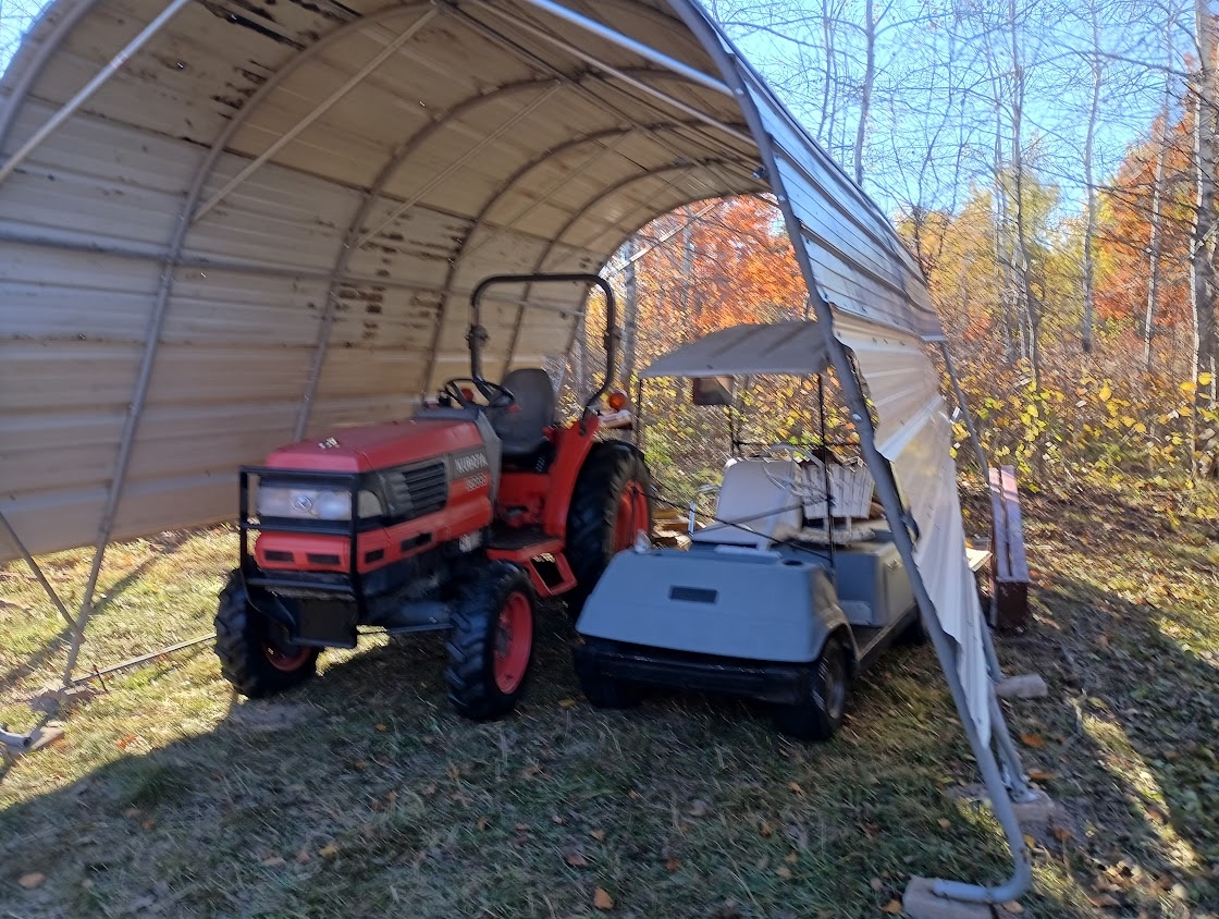

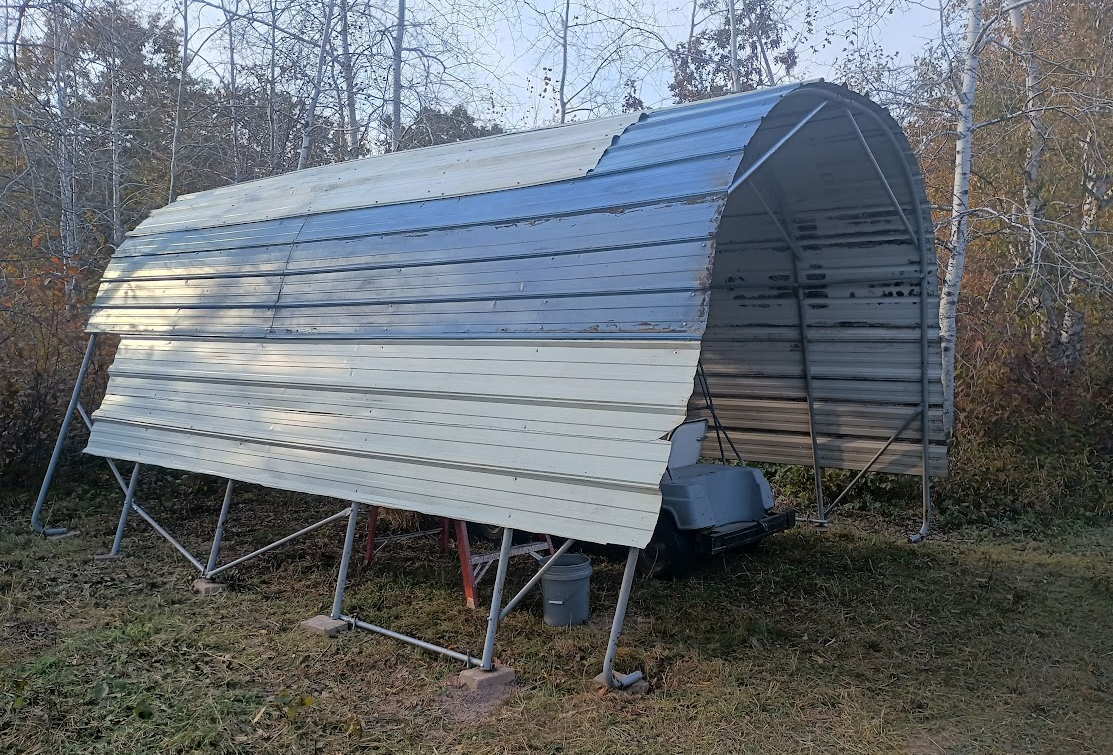

I just cobbled together a shed for my tractor at our hunting land. I bought a Shelterlogic 12x20 frame from my neighbor for $25. My other neighbor gave me some random tin for free. It's not pretty, but it is functional. I would like to paint it one color.
Has anyone used a Cheap Cordless Paint Sprayer for oil based exterior paint/enamel? I don't have electricity there, and this option would be easier than a generator, compressor and a spray gun.
Here's the shed:
Here's the type of spray gun I am considering:

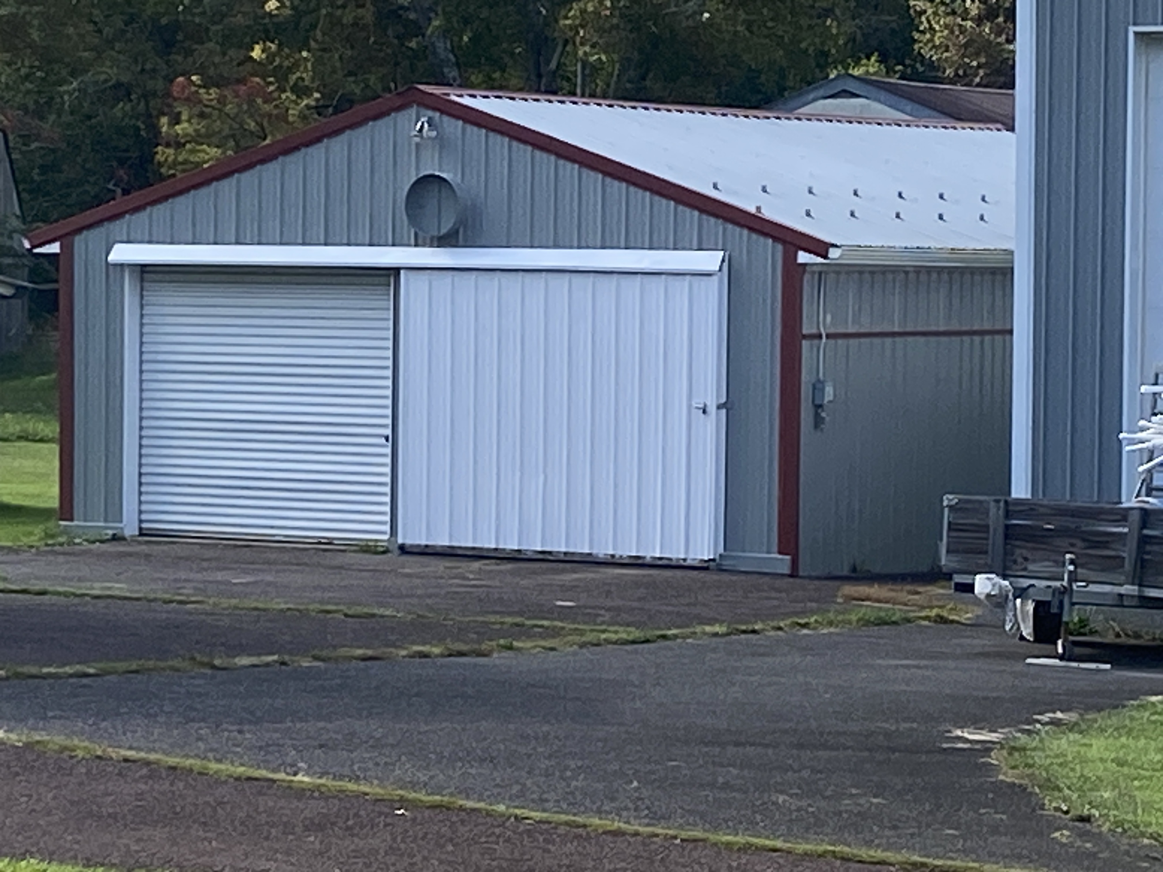

Last year I painted this 24 x 40 ft, barn with the HF electric sprayer
I used Rustoleum thinned with acetone
The HF sprayer is 110 volt but the cordless sprayer should work just fine
Here's the shed: View attachment 1511099
Here's the type of spray gun I am considering: View attachment 1511100

Actually, I want to paint it a color that blends in better.
