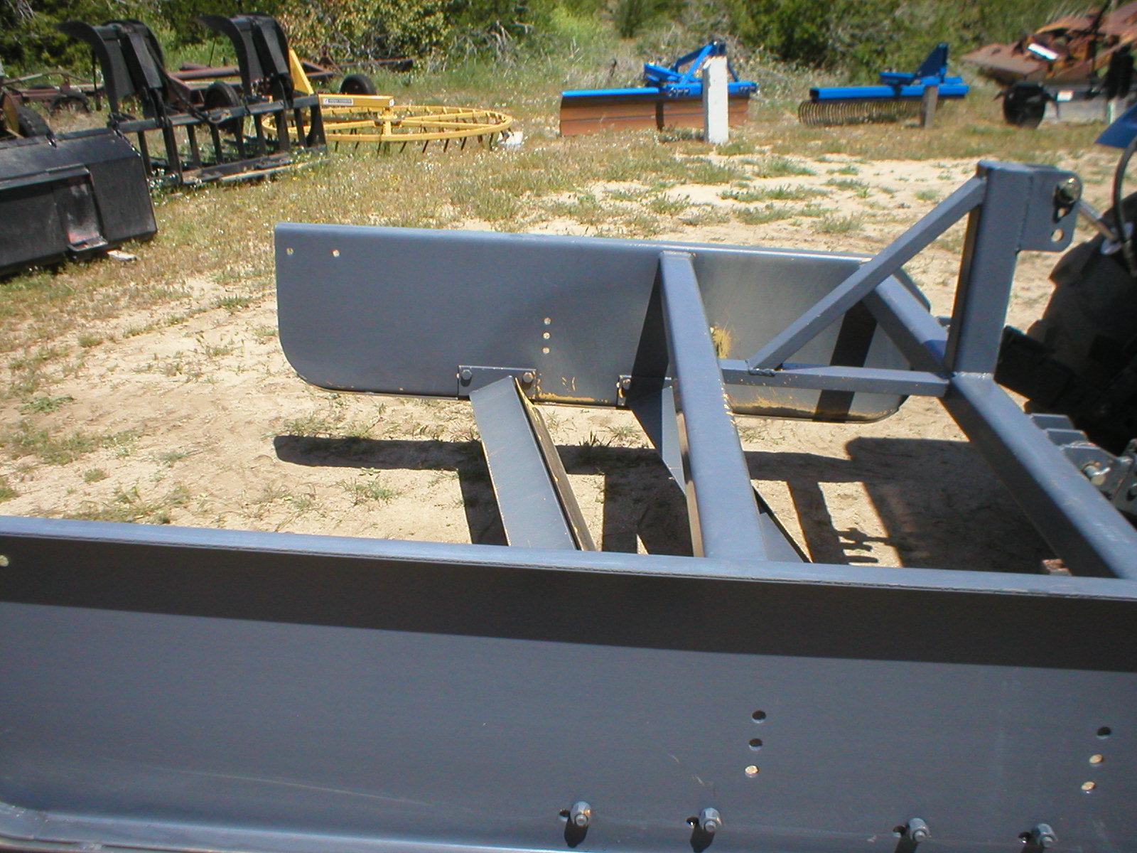

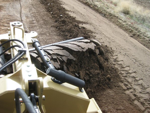

I don't have an RBT55, but I do have an RBT45108 and I run it behind a 75hp 12,000lb machine. In heavy grading, as in making new roads from virgin soil it sort of is like the tail wagging the dog. The 45 series is rated for a 125HP 15,000lb machine. The 45 has the largest offset of any of the Land Pride blades at 35". The RBT55 series only offsets to 33". The 55 series is obviously heavier duty within additional 529lbs of weight comparing the 9 foot blades. The moldboards are the same, so the difference must be in the 1/2" larger dia cylinders and how the hitch is made. From the 45 series on up all are cat 2-3 hitches. I guess it all depends on how much your new tractor is actually going to weigh and if you are trying to go with the 120" blade.
Good luck, you won't go wrong with any of the blades that I have mentioned in my opinion. ;)

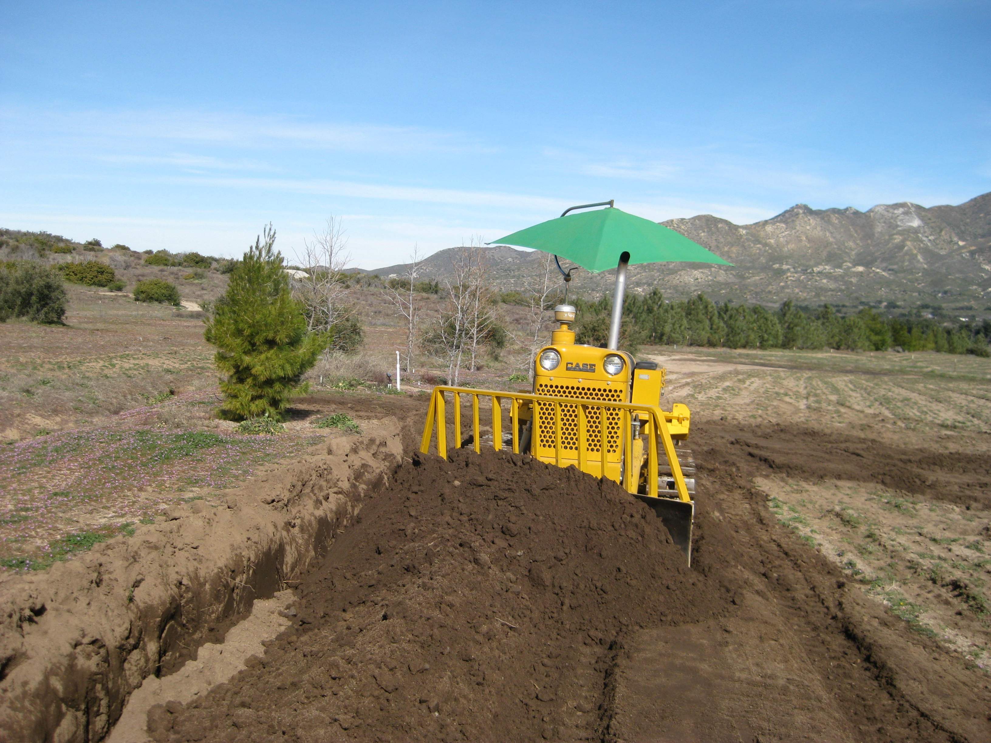

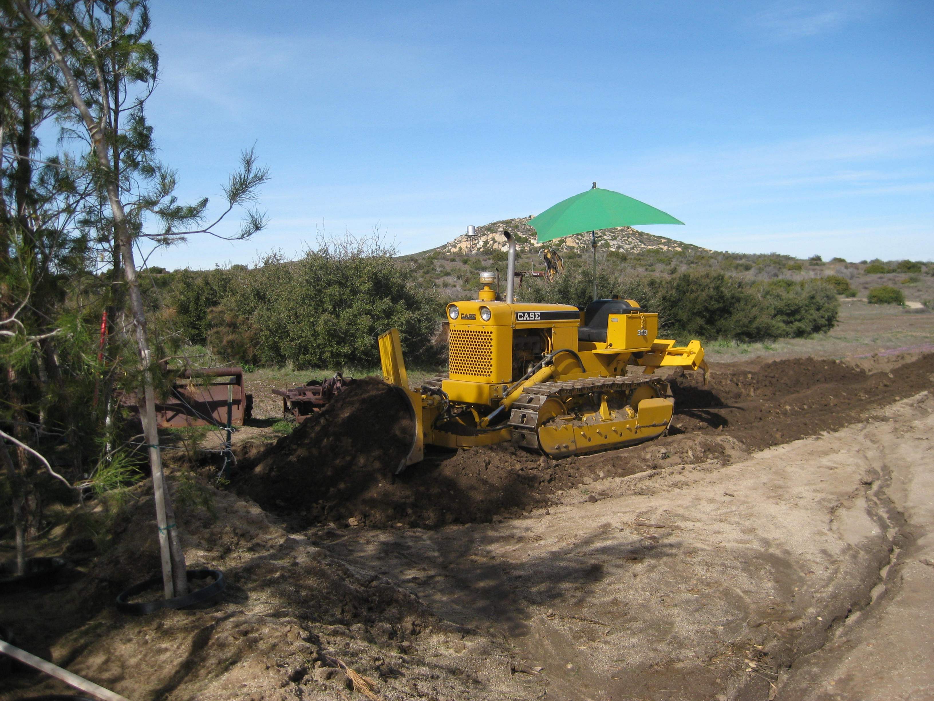

   / Anybody have a Land Pride RBT55 Grader Blade #6
Brian.
That Case looks real nice, reminds me of using my old Deere 450. Every now and then I wish I had another small dozer.

Firstly by the picture of your grader blade in the picture above which looks huge compared to the size of your tractor, does the blade only weigh 1166 lbs (529 kg) as it says in the catalogue?
Secondly everybody has told me and what I have read is, you get the best grading result the heavier your blade is. That is why I was looking at the RBT55 at 1753 lbs (795 kg) although I think the consensus is that an 8' blade would be better than a 10' blade which was my original thinking as well. Wouldn't I be better with a heavier blade provided the tractor can handle it?
