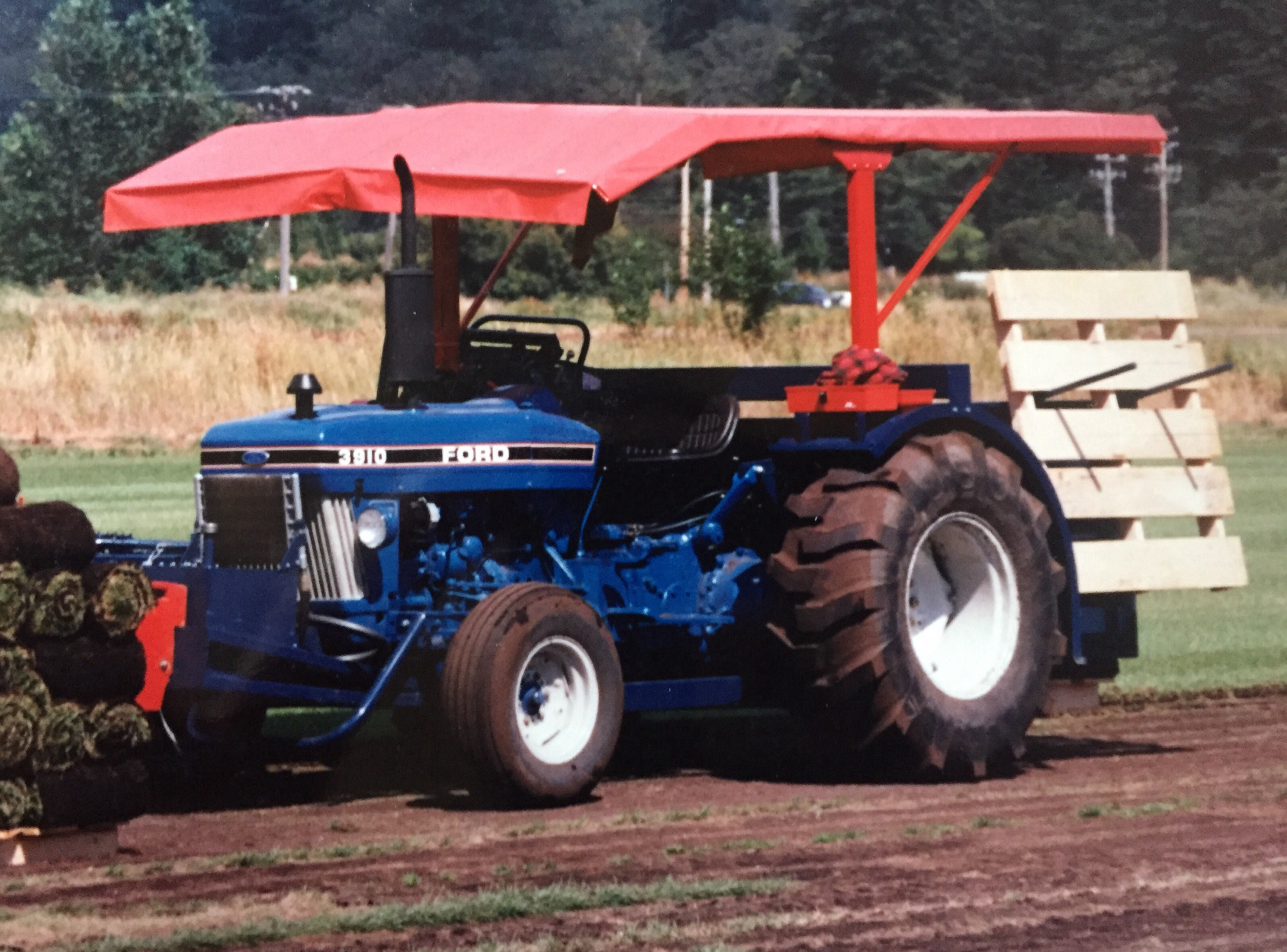

I didn't bother building a sod cutter. I bought this one in 1990.
