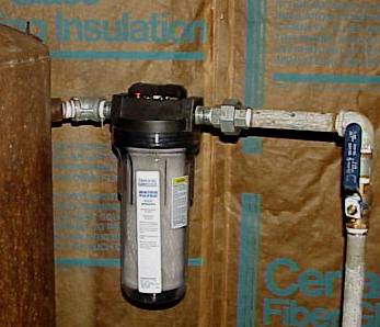

I know very little about wells and zero about packed wells but our well pumps a small amount of sand so early on I had to do something because the washing machine fill valve stuck in the fill position because of a sand particle but we caught it before any damage was done to the house.
Knowing a little about specific gravity, in the well house I installed a recycled hot water heater as a sediment tank and that took care of that sand problem reaching plumbing components. That was bout 30 years ago but since then I've installed a filter just down stream of the sediment tank to remove anything with a specific gravity less than water.
One other item during construction, I separated house water from outdoor water and that modification should help the filter change frequency in your situation for outdoor use.

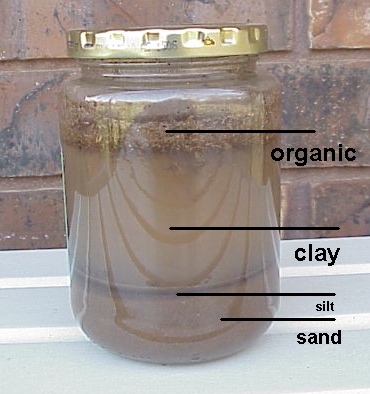

Pictured is a soil sample that shows some information about the weight of certain soil particles compared to water weight. A similar test of your water may indicate whether a sediment tank would benefit.
