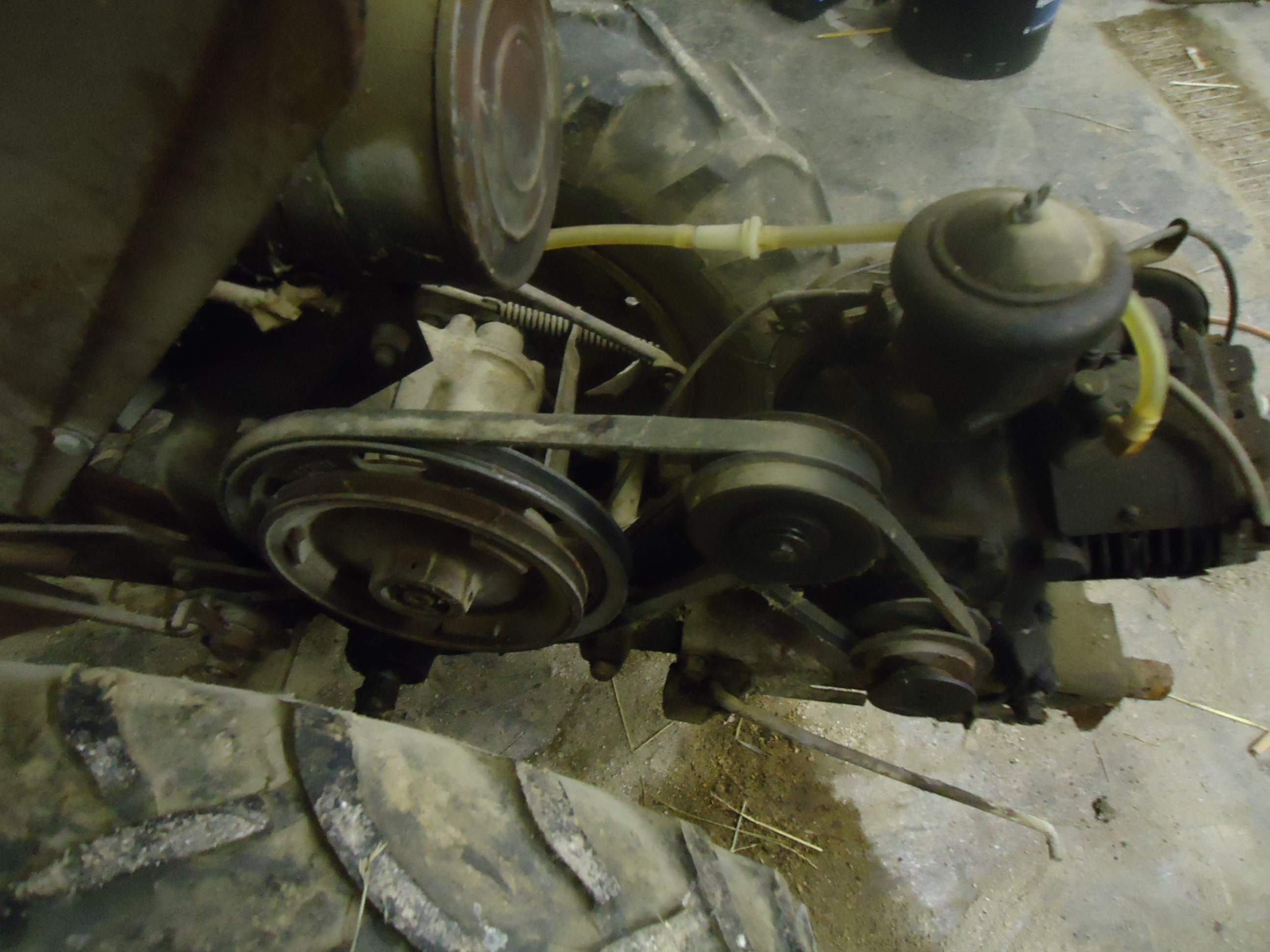

Any help would be greatly appreciated. I have a David Bradley 5HP Special garden tractor. When the clutch is engaged it LURCHES forward and the travel speed seems too fast. It makes plowing, harrowing, etc., very difficult because it is hard to keep up to the pace of the machine. The clutch is either "engaged" or "not engaged", there is no way to partially engage the clutch. I was wondering if replacing one of the gears would help to slow down the ground speed? I am not aware that this model of DB tractor had a speed changer. It does have a reverser. Thanks for any help on this; if I could slow this thing down a little, it would be much more pleasurable to use.

Had a David Bradley about twenty five years ago and it was old then. Cannot remember if it was belt or gear driven, but to slow the tractor the engine gear should be smaller and or the driven gear should be larger:thumbsup:
   / Any way to gear down/slow down David Bradley tractor? #3
The orignal David Bradley had an engine pully with two different grooves on it. One of the grooves was for a higher ground speed and the other one was for a lower ground speed. If yours doesn't have this pulley, you can find a different pulley to change the speed a bit.
The later David Bradleys had a variable speed pully arrangement on them that allowed a pretty wide ground speed variation.

If you could find a donor model with the complete speed reducer, you could mount it on yours. They simply clamp to the frame, between the engine mount, and differential. I say complete, as the lever and rod, that activates the pulley mechanism mounts on the left handlebar, so as to change on the go.
I've got a Special 5 myself. Never had any problems when cultivating to just creep when plants were small. It pulls along great at just off idle.
I also have a rare '55 model Deluxe Super 3, with Continental AU85 engine. It was only made for 6 months. I've included a picture of the speed reducer pulley mechanism. If you enlarge the picture, you can see where it clamps to the frame.
