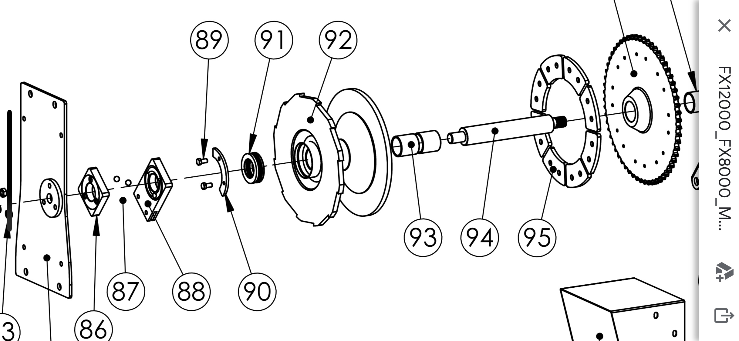

What's got me scratching my head, and I hope someone can post a picture of, is how the cable attaches to the drum. Wallenstein was kind enough to send me a PDF of the FX8000 and FX12000 operators / parts manual and there is a little part labeled the cable clamp I seem to be missing. What's strange though is the picture of the drum where this clamp attaches looks slightly different than the one in the PDF. :confused:
If anyone has one of these units and could snap a few pictures of that or can describe it to me I would be much obliged! I figure if I can't buy the clamp any more I can fabricate something.

You’re right about there being a hole in the side of the spool. From the parts diagram I’ve got though it looks like they had a way to clamp it to the spook without the use of a common cable clamp... but that isn’t a bad idea...:scratchchin:
You can see part #90 here is the cable clamp P/N LW1210

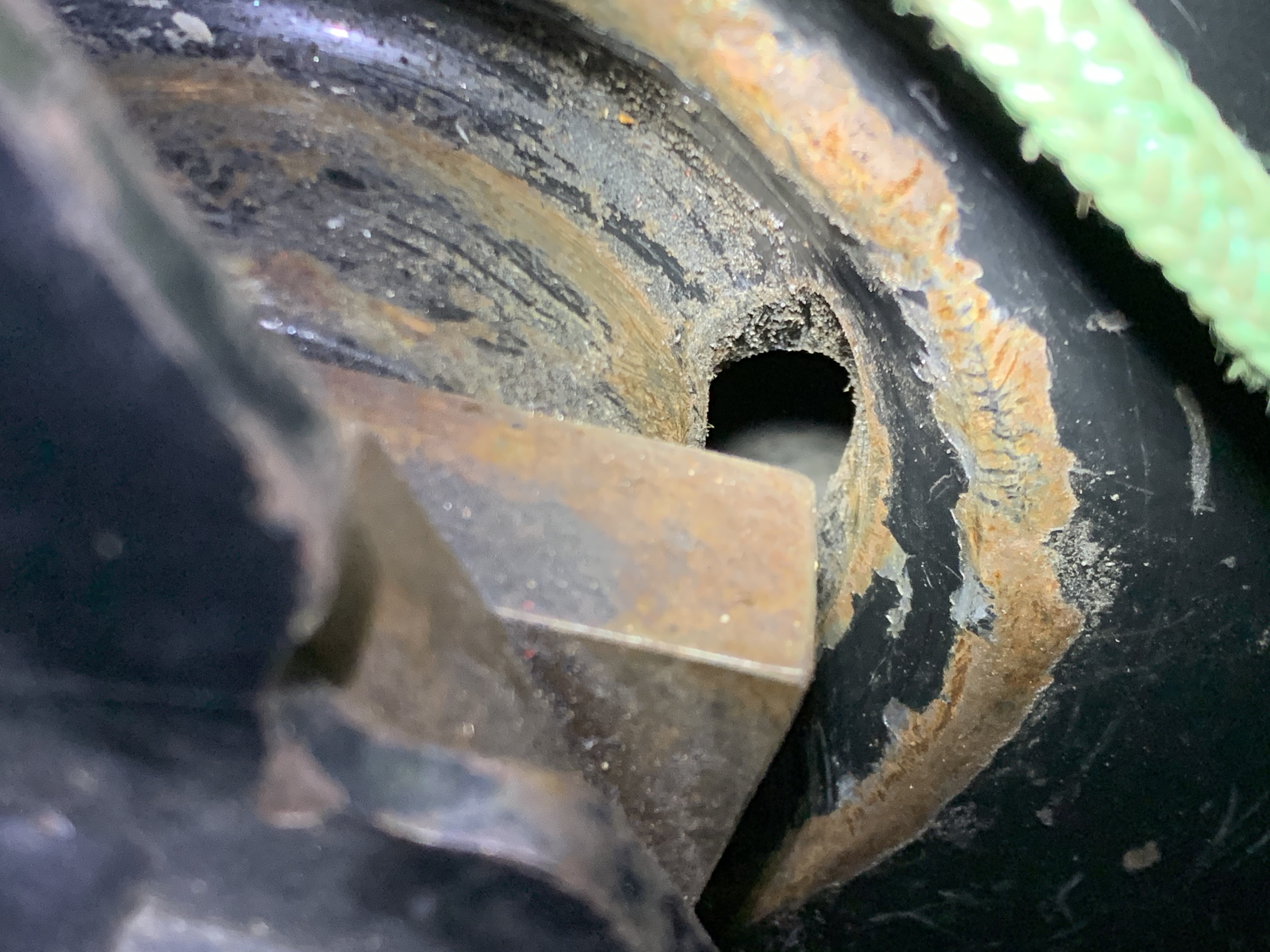

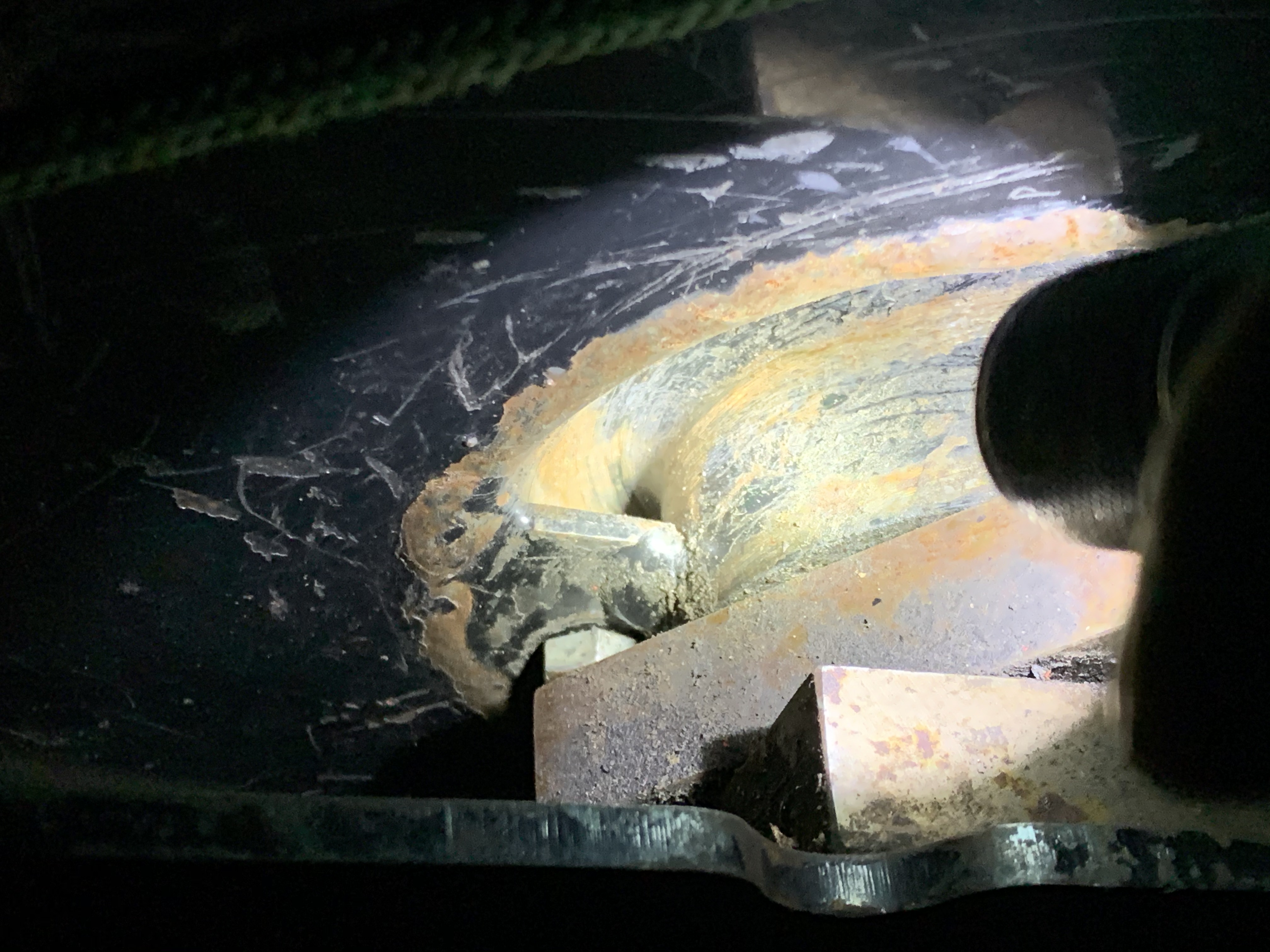

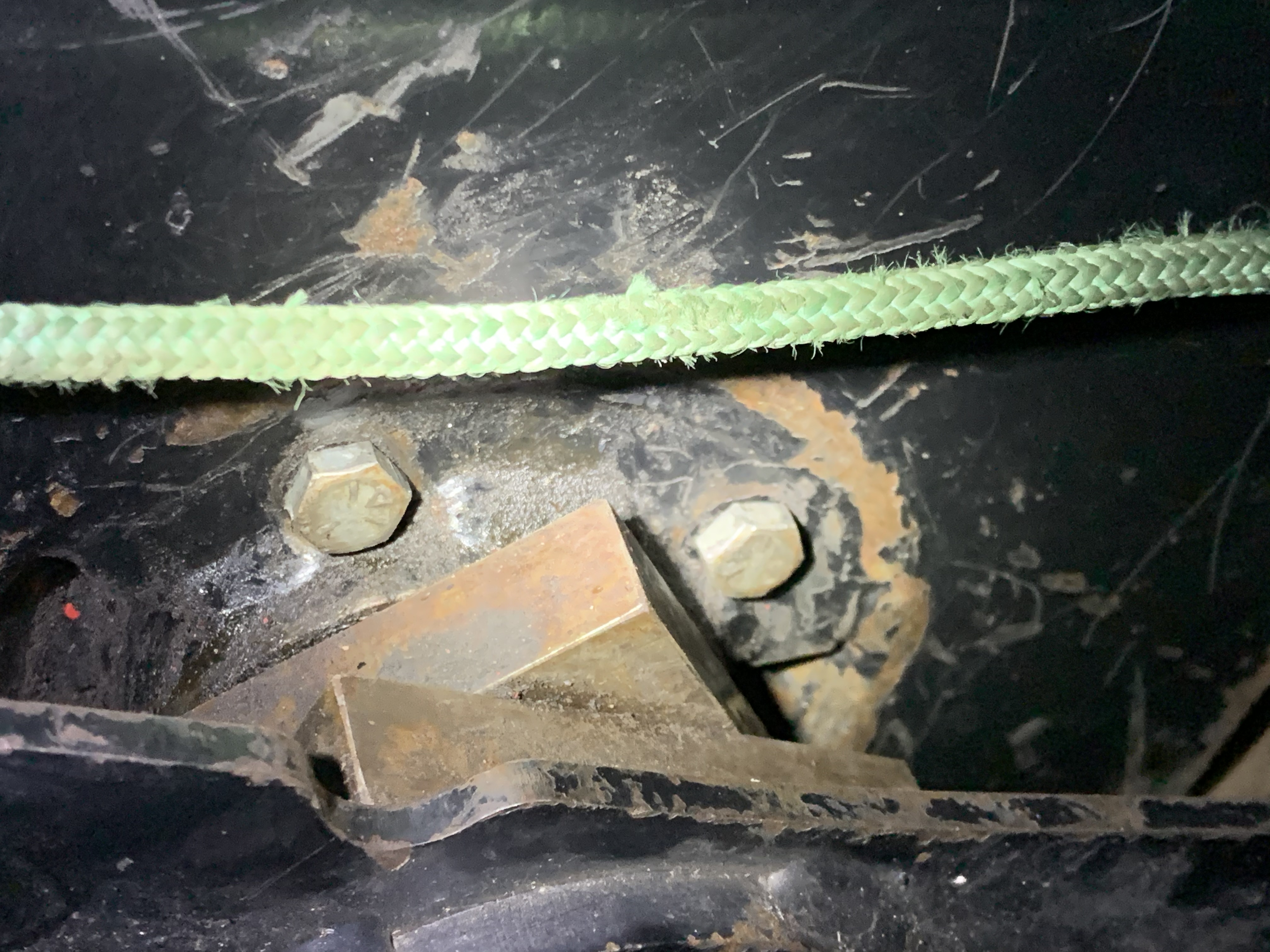

Here is what my drum looks like:
ABA658D4-5ECF-412C-91BD-55348815983C.jpeg93F69CD4-57DC-455E-93A6-ACE1BD6F6720.jpeg6C669D63-91F8-42E8-ADB0-AF97752C17AD.jpeg
