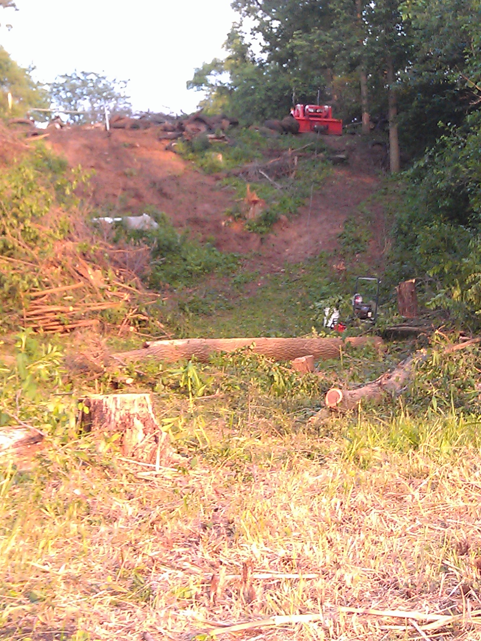

I'm moving to a new place with some steep hills where a 4wd Utility vehicle might be more usefull than my current tractor. I have a hydraulic winch and 12 ton logsplitter that I'd like to keep using when the tractor is gone. Are there any hydrostat utility vehicles out there that can be set up for power beyond? Around 4 - 6 gpm at 2500 psi would be plenty. It looks like the Kubota RTV X 900 (used to?) have a hydraulic accessory capability but it doesn't show up in the current specs.

The toolcat didn't look like it was set up to handle rough terrain very well and I need something that can handle a steep hill. hill.jpg
Here is the hill on the property. A mini excavator was able to get up and down using the bucket, but most other vehicles are probably going to need the winch. Maybe an old farm Jeep..
   / Any Utility Vehicles with Hydraulic Power Beyond? #10
Nice land. How often will you need to traverse that hill? Or other ones like it? Regular winching gets old fast especially as part of a regular path. If it's part of a regular trail, I'd be inclined to cut/fill/regrade that it can be safely done without the winch. If winching is your plan, remember that you could get any vehicle up there hanging off a cable...even a Civic
