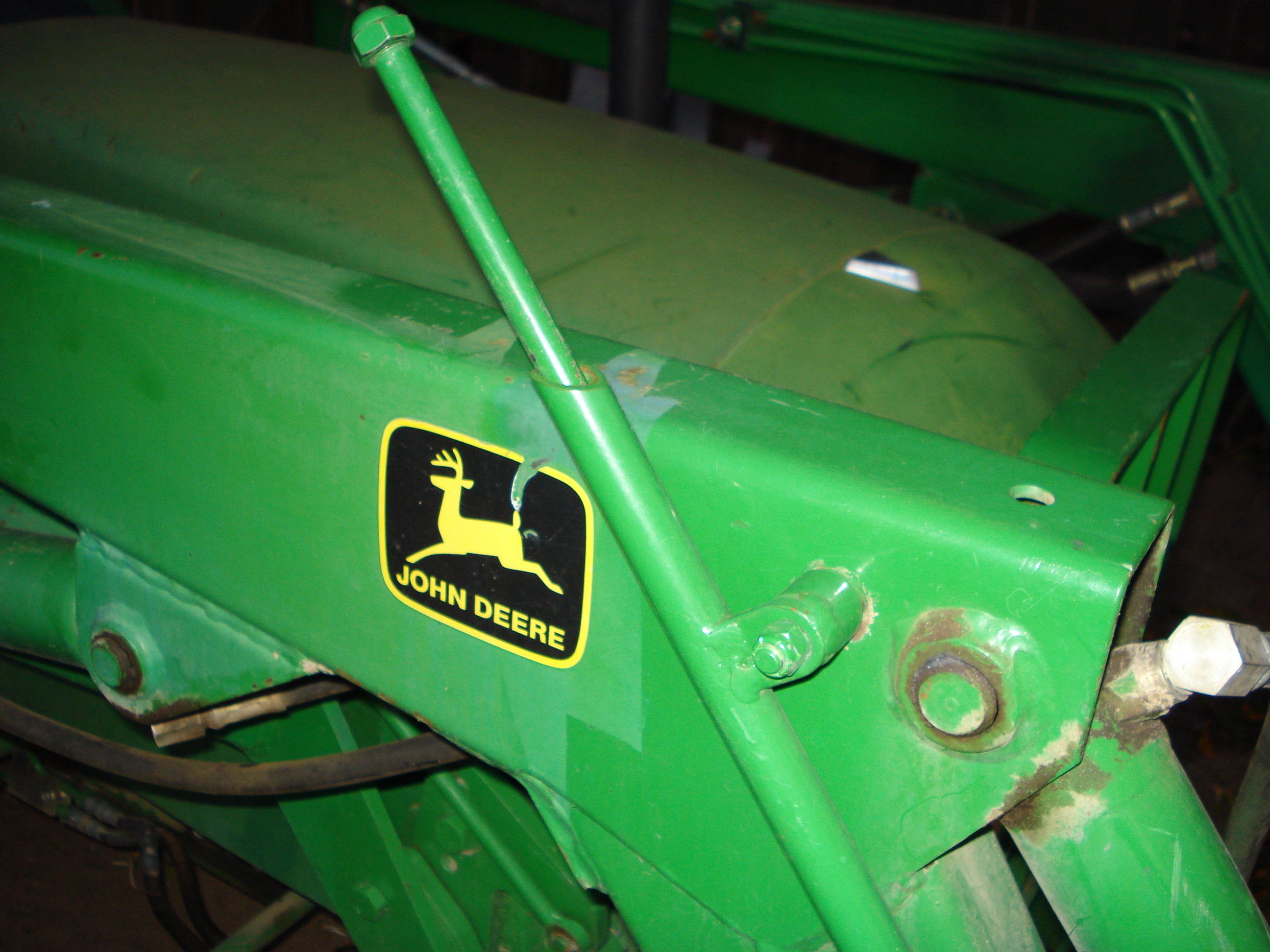

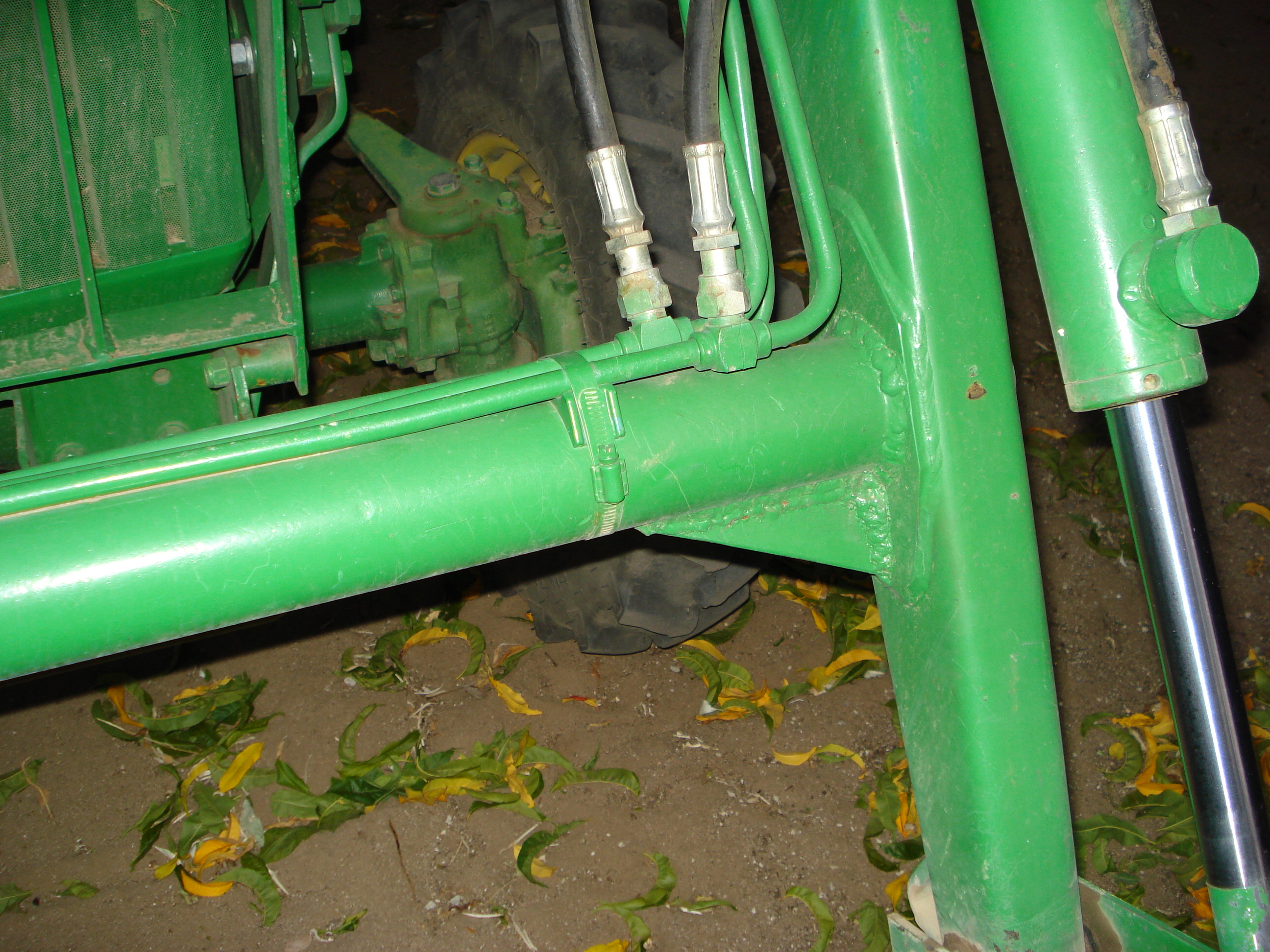

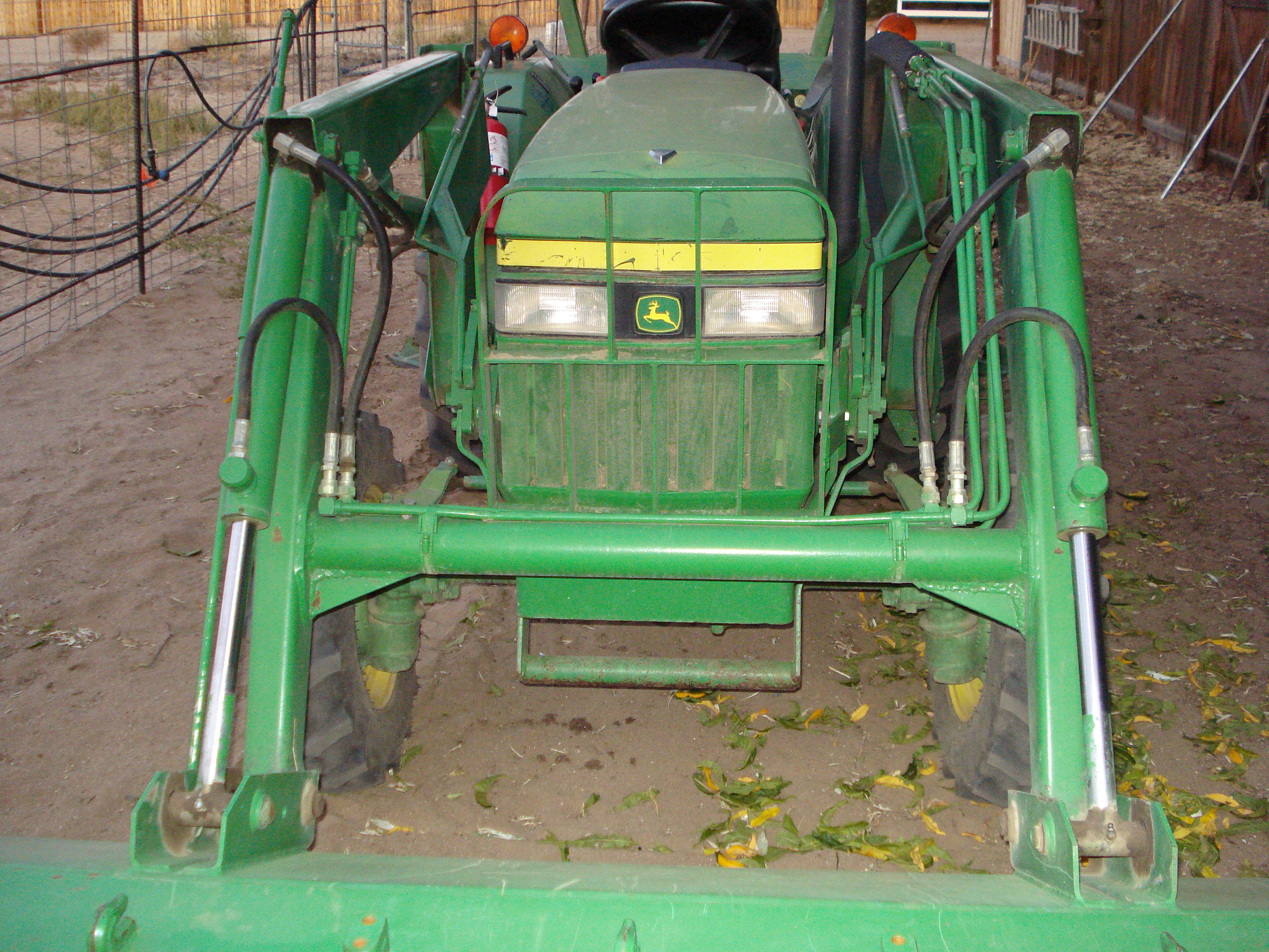

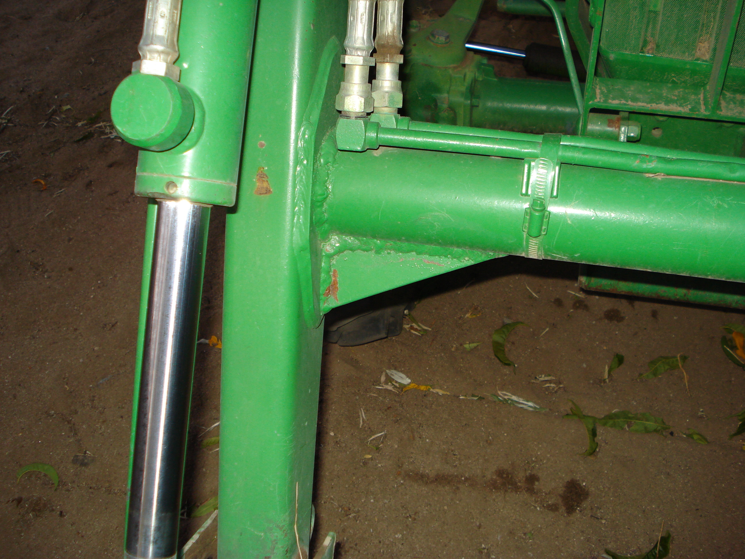

Of course, most different brands of loaders have different adjustment points. That was so for my loader as well. That said, I could not level my bucket on my newly acquired and much abused but new to me John Deere 970 with the series 80 quick detach loader. One side of the loader bucket touched the ground 2 1/2" before the other side. In the end I discovered that the tube that runs between the left and right arms was twisted due to abuse. The fix came down to taking a carbon arc air torch and removing the weld attaching this bent tube just behind the bucket on just one side The Cross tube itself was not twisted to bad, I was able to re-time the arms so the bucket was able to be level and tack weld in place on the second or third attempt. Once that problem was out of the way, I welded solid. Flaw in the design was to lite of a tube between the two sides and of course an operator that had some common sense. I fabricated some gussets for the cross tube adding some more structural resistance to twisting the loader arm cross tube again. I would not recommend this to the average owner, special tools, good welding and fab skills required for this job. Poor welds would be a safety problem that could cause big problems with welds failing under heavy loaded bucket conditions, could result in a death if not done right. Most local shops should be up to that job though it won't be a cheap repair. I'd be looking at that tube first after all of the adjustments are exhausted or at their limits. I can post pics if it would help. Also,being a green horn operator, I added a home made bucket level indicator. easy to do stuff. All welds 7018. Arc-air electrode is 1/4" carbon arc @300 amps and lots of air CFM. Did this repair more than 5 years ago by my records, has not moved a bit after the repair. Don't know what a SSQA plate is, this was a old school repair by removing the weld attaching the left side arm to this tube making it so I could "re-time the arms" back to the same place. Minor adjustments to the mounting brackets are provided in the mounting brackets. Makes me look at everything I lift with this FEL from this point on. I was not the person who bent this loader, but I want to learn from what I had to fix.
