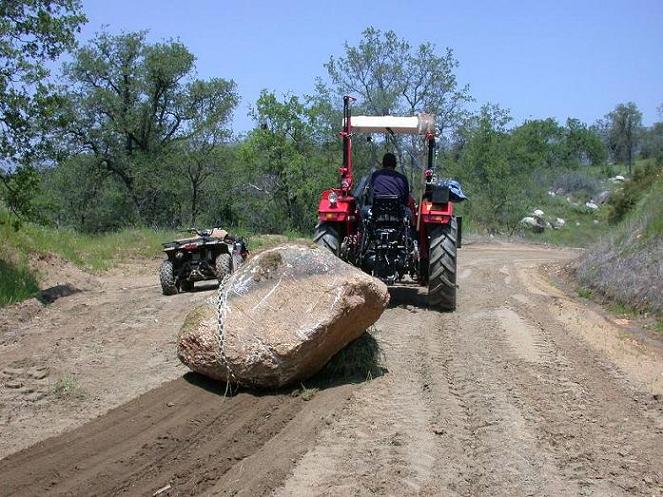

Funny this post went up while I was at the property. I tried chaining some GIANT rocks to move them. I had trouble keeping the chains wrapped around the darn rocks. Should have used the tire chain idea. Anyway, I finally got one of the big suckers out and had to drag it. I could barely get it started and rocked it about 50 times in all directions before she came out. It probably weighed between 2 or 3 tons because I couldn't budge it with the loader! It also left a 1 foot deep gouge in my dirt road.
