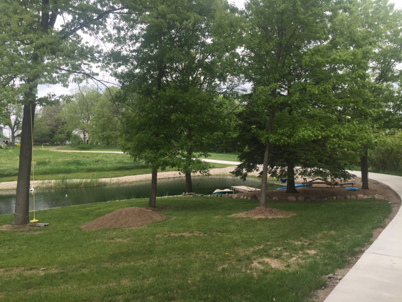

have a husky mz5225 that for the price I haven't been terribly impressed with. i have always lacked good traction. i put fluid in rear tires and am running minimum pressure. right now it is down due to a bad could and i borrowed my neighbor's simplicity zt and loved the traction it provides. my husky seems to leave marks at every turn where the neighbors was flawless. would getting bar tires help this? any other simple suggestions?

Traction on any 2 wheel drive vehicle can be improved with appropriate ballast. ZTRs with little rear overhang and a seat that is mostly in front of the rear wheels have poor traction. I would suspect that your neighbors simplicity either has the seat or the engine or both more rearward compared to your ZTR and this is the reason it has better traction. A simple fix is to adding an appropriate amount of weight as low as possible and behind the rear wheels. What amount of weight is appropriate is something you will have to determine. Adding weight behind the rear wheels counterbalances the weight of the deck, frame, casters and your body weight, which is mostly in front of the rear tires. If your ZTR is balanced poorly to start with, a substantial amount of weight may be needed. However, too much weight will cause the front end to get light. It may not be practical to add as much weight as you need but it's a cheap thing to try if you have some exercise plates lying around. Try adding one 50 pound plate to the bottom of the frame as far back as possible, test and go from there.

not sure degrees of grade but i do have a pond in front of my house that stays wetter than the rest. i like to mow this up and down the grade mostly for looks. i did notice the simplicity had the engine more rearward than mine. i am mowing 2ac+\-. i was aboe to put in about 2 gallons of washer fluid in each tires to add weight which helped a little. not sure if photos do any justice but i tried to attach a few to show what im dealing with.
