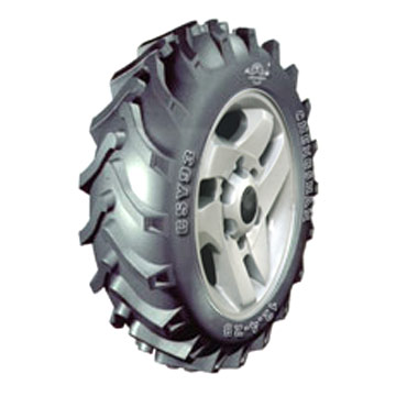

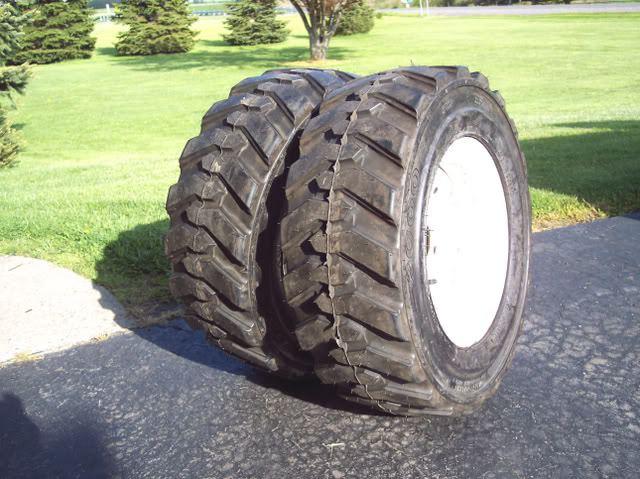

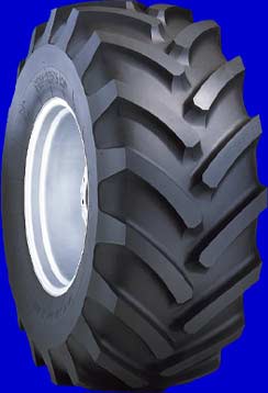

R1 tires are also call ag tire as in agricultural tire, 1st+3rd pictures.. also called bar tires.
R4 are heavy duty industrial tires, the bars aren't as deep, the sidewalls are thicker and stronger. 2nd+4th pictures
R1 tires are mainly used for farm jobs..ei: plowing fields..but they have very good traction..so if traction is the driving need..R1.
R4 tires are used for rough work.. you'll see them on backhoes and skid steers, they can take a lot of abuse.. and they are a bit gentler on lawns.. you said mowing, loader, brush clearing? sounds like R4 to me.
