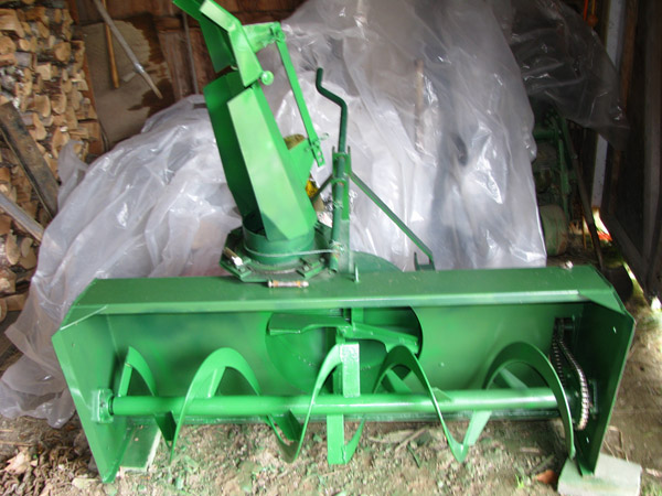

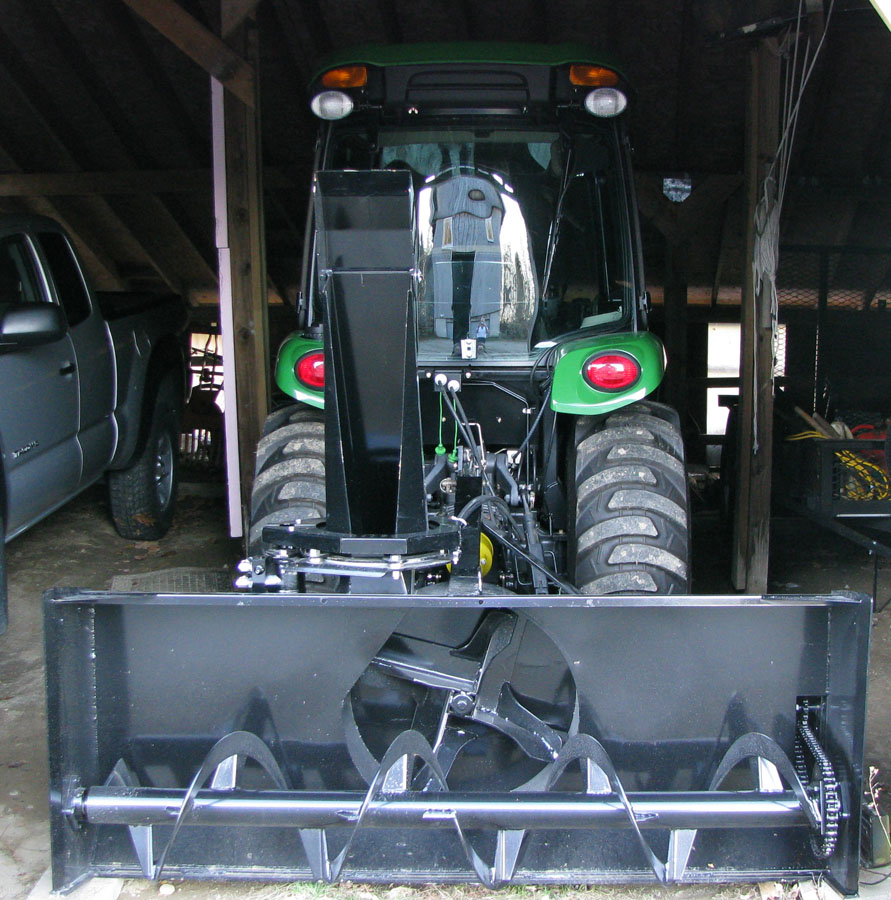

   / Any recommendations on 3PT hitch mount snowblowers? #10
I also own a Meteor snowblower...ran a 60 inch for 7 years..switched to a larger tractor and a 75 inch meteor with hydraulic chute rotation a few years ago...have never had a problem yet (knock on wood)
