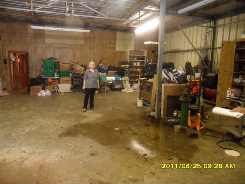

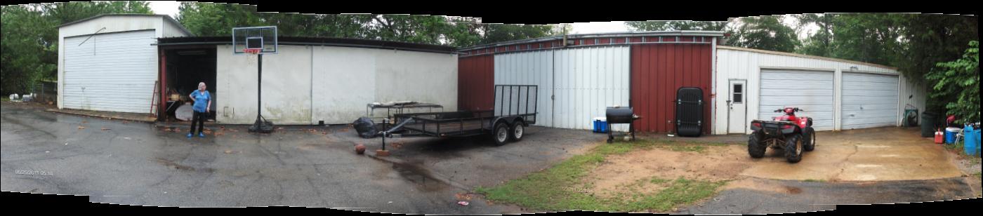

Along with my the property I'm buying I'm getting about 5,500 of warehouse space.
attachment.php
One shed has a lot of interior space, this is about 1/4 of it.
attachment.php

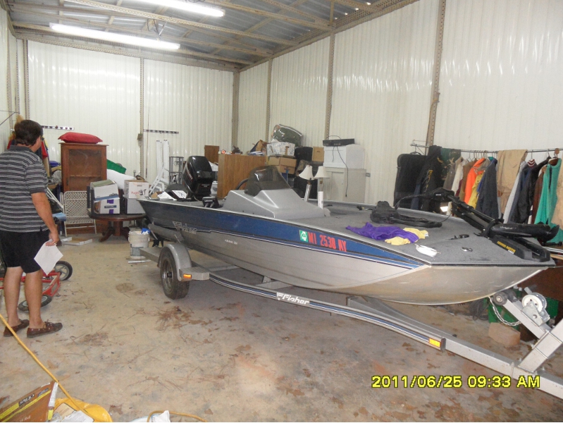

Another is an RV type shed with a high roof.
attachment.php
I've gotten permission from SWMBO to put a lift in one so I can stand up and work on my vehicles.
I don't really have the tools yet to build one from scratch yet so I've been looking on line for different lifts. most of my vehicles are small cars, with the exception of an E350 and a yet to be purchased 1 ton diesel truck.
So I'm planning on a max curb weight of 8,000 lbs.
It seems there are 2 basic type of lifts for my use - 2 post w/o an overhead bar and 4 posts.
Any recommendations on brand and type? I'm a little over 6' so I wat to be able to stand up.
thanks in advance.

I've been lightly looking at them too. Generally you will need 12' of ceiling hight to begin with if you want to walk under the vehicle.
2 post lifts eat up less geography on the floor, but you have to have sufficient concrete to bolt the to...At least 5", more is better. If you don't know, a 4 post might be better.
Most garages use the 2 post lift...The one thing I dont like about those is that you really have to watch banging the doors..but I suppose that is adaptable.
From what I've seen a nice one can be had for less than $2500. You may have to assemble though, and that can be a whole other story...The parts are very heavy. A large FEL or forklift is a big help. I've helped dis-assemble them and re-installed in a friend of mine's shop and it was a little squirrely.
You'll also most likey need 220V to power it.
Nothing like giving up the creeper...
Let me know what you do...Good luck
