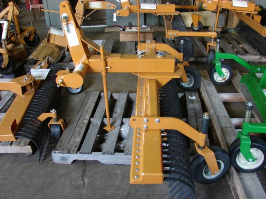

Hi I would like to put a stand on my Lineback SO 6' scraper blade ,so when I get my pat's easy change on my 870 JD, I won't have to look for A block every time I take it off, Any info would be great Thanks sleepydeere
   / any one put a stand on their 3 point scraper blade #2
Mine has about a 1 inch ID tube, with a crossbolt hole, 3 inches long, welded to the frame near the front. In this is a rod with some crossbolt holes and a foot on the bottom. Easy and simple.
Bruce
Here is one like it:

Yes I put one on mine,basically the same as in previous picture.

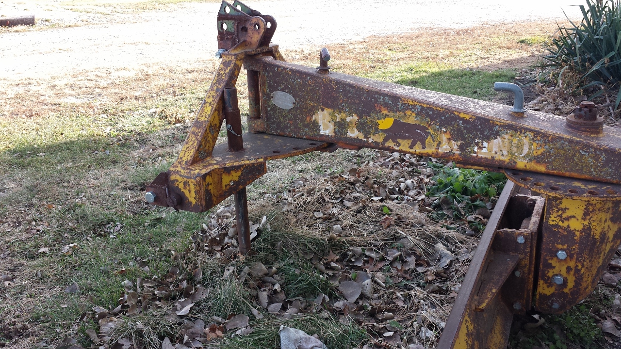

I made one out of square tube. Welded a short piece on similar to the pix and took a smaller size about 2 1/2' long for the leg. I welded a small flat on for a foot and drilled 2 holes, one at the top to support the blade and one at the bottom to hold the leg up while I am using the blade. I put a pin thru it like in the pix. Works pretty good.
   / any one put a stand on their 3 point scraper blade #8
I made mine out of pipe. One piece slipped into a size larger. Welded a 4" square pad on the bottom. Drilled a hole thru the larger piece toward one end. Cut a hole thru the blade platform, you could vary that depending on blade design. Measured the height I wanted it to sit and then drilled a hole thru the smaller pipe at the appropriate distance to get that height. Drilled another hole thru the smaller pipe that would carry it at a height out of the way for work. Took about 15 minutes. Wouldn't be without it.
