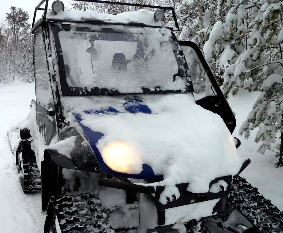

I have a Yamaha Rhino with an enclosed cab. I don't need a heater, I just want to keep the windshield clean. I plow a long driveway with it and snow blows back all over and sticks to the windshield. A windshield wiper would probably help too. Last year I kept paper towels with me and would jump out every few minutes and wipe the windshield down.

Are you speaking of the inside or out? We just retired a Rhino that was operated in the winter and had the same problem. I purchased a cab fan and added a wood clamp to it which held it to the roll bar. This helps for the inside and I carried a shammy for wiping it off as well. Anti-fog chemical wiped on it also helped. If you have a poly windshield, you need to be careful or it will be scratched up. On the next machine, we got glass. I can't locate a photo of our fan. Do note, the Rhino just has a stator which doesn't produce much power.

It's generally the outside that gets caked in snow like pictured above. Mine also has a poly window. I am wondering about the capacity of the charging system. I did some research into and it looks like I might be using every bit of power available to run one of these 300w heaters once you add up all the other power being drawn from the system. My plow is attached to the electric winch too.
