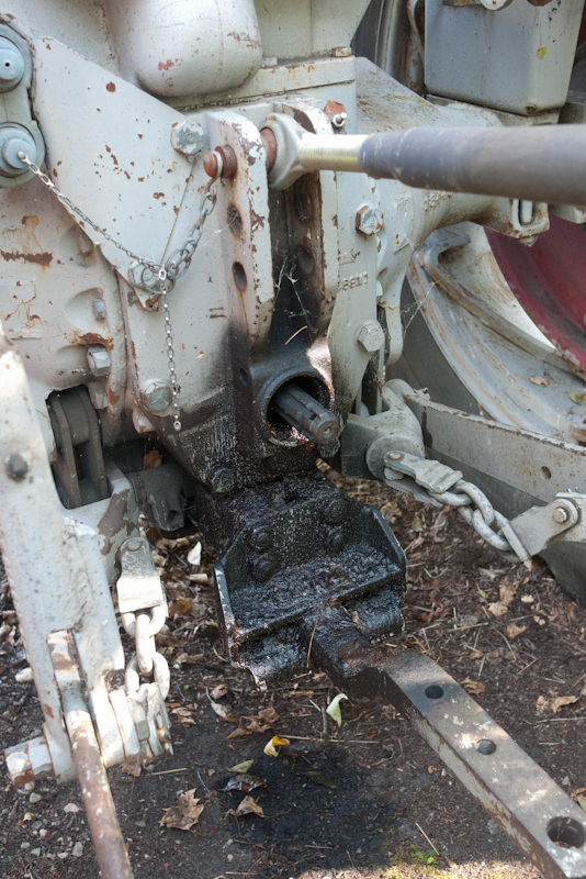

Hi Grove,
Seems the leak is around the PTO as you can see in this picture. Any ideas what this could be?
I did drain the oil and transmission fluid on the weekend and there was lots of fluid in the tractor. Will fill with new fluids hopefully this weekend and clean up the pto and see if the leak reappears.

Hey Paul, It sure looks like a pto seal leak. It's an easy fix if that's the only problem.(see 'replacing pto seal...' thread by Elkins45). It's not too hard or expensive to find out: pry out old seal (after noting how deeply it sits) clean up mating area, set new seal over opening ( some folks put gasket sealer to lubricate/secure outer rim of seal) and gently, squarely and evenly tap it into position using a hammer and block of wood. the wood spreads the hammer tap out over a wider area of the seal, keeping it square. Tap 1 side, then the other. Tap the top, then the bottom. The idea is to not let any portion of the seal get driven in too far in advance of the rest of it. Slow and steady is the rule here. If by chance this doesn't help the leak, another option might be to simply cap the pto off with a cover. If you're using it to blade or drag stuff, you don't need the pto!

Paul: Boy, is my face red! I described that procedure from memory (did mine in '03) and got to thinking that maybe I should actually go look at my tractor to make sure I told you correctly. Turns out I left out a major step. Not a difficult one, but a major one. The PTO seal is actually installed on the inside of that big rear plate. This is the big plate that has the upper link of 3-pt. on it. It's held on by 8 or so big bolts. That plate has to come off, then the seal is installed on the inside of it - flat side of seal pointing inward. The procedure is now the same as I told you w/ the added benefit of not having to work around the PTO shaft which will remain on the tractor. Be sure to clean it (shaft) off well, as you'll have to slide the housing/plate (w/ new seal) back over the shaft. Do this very carefully so as not to damage the new seal. It's a good thing you haven't put fluid back in yet because at least some would've needed draining to do this job. Also, there's probably a paper or cork gasket under the rear plate that if you can find a new one -replace it. If not, try to get it to stay on either cover or housing, then apply sealant.
