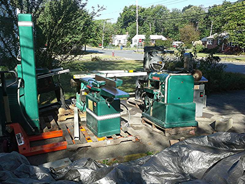

I've got to load my trailer (see sig) with a a bunch of palletized equipment and maybe my B7610.
I could put down weights, pallet size, etc.
I've the trailer specs. Length, axle placement, etc.

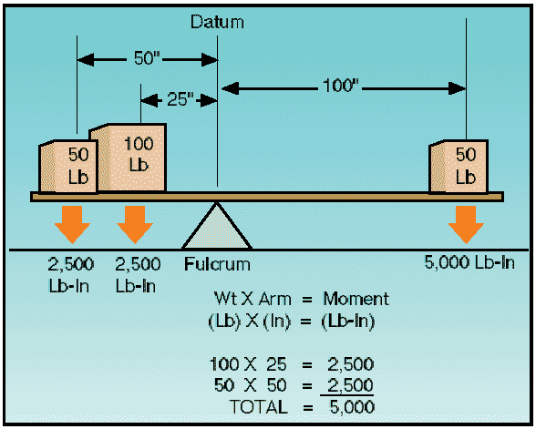

Is there an app I could use to guesstimate the tongue weight if I put the 700 lb bandsaw in the front and the 200 lb sander in the rear?
That I could move pieces around for better tungue weight?
Thanks
   / Any load apps for android?
btw what did you have to give for that nice vintange powermatic equipment?
About $1K after taxes, trailer rental, refreshment for loaders etc.
That's a 20" Powermatic 81 bandsaw
10" craftsman table saw
10" Rockwell/Delta Radial Arm Saw Model 33-732
Powermatic 160 Planer (16")
Delta 31-710 Belt/Disc sander
Powermatic model 60 (8") Jointer.
All 3 phase. Pulled from service because a school turned a woodworking shop into a computer lab. And all had been professionally serviced about 2 months before it was pulled.

Load the trailer until the suspension on the truck is level. Call it done. Center of mass should be about a foot forward of the front axle on most trailers.
   / Any load apps for android? #5
How it's done mathematically, where the fulcrum would be about 12" in front of the front axle.
I understand the physics, I was just wondering if there was an app already.
All 3 phase. Pulled from service because a school turned a woodworking shop into a computer lab.[/URL]
