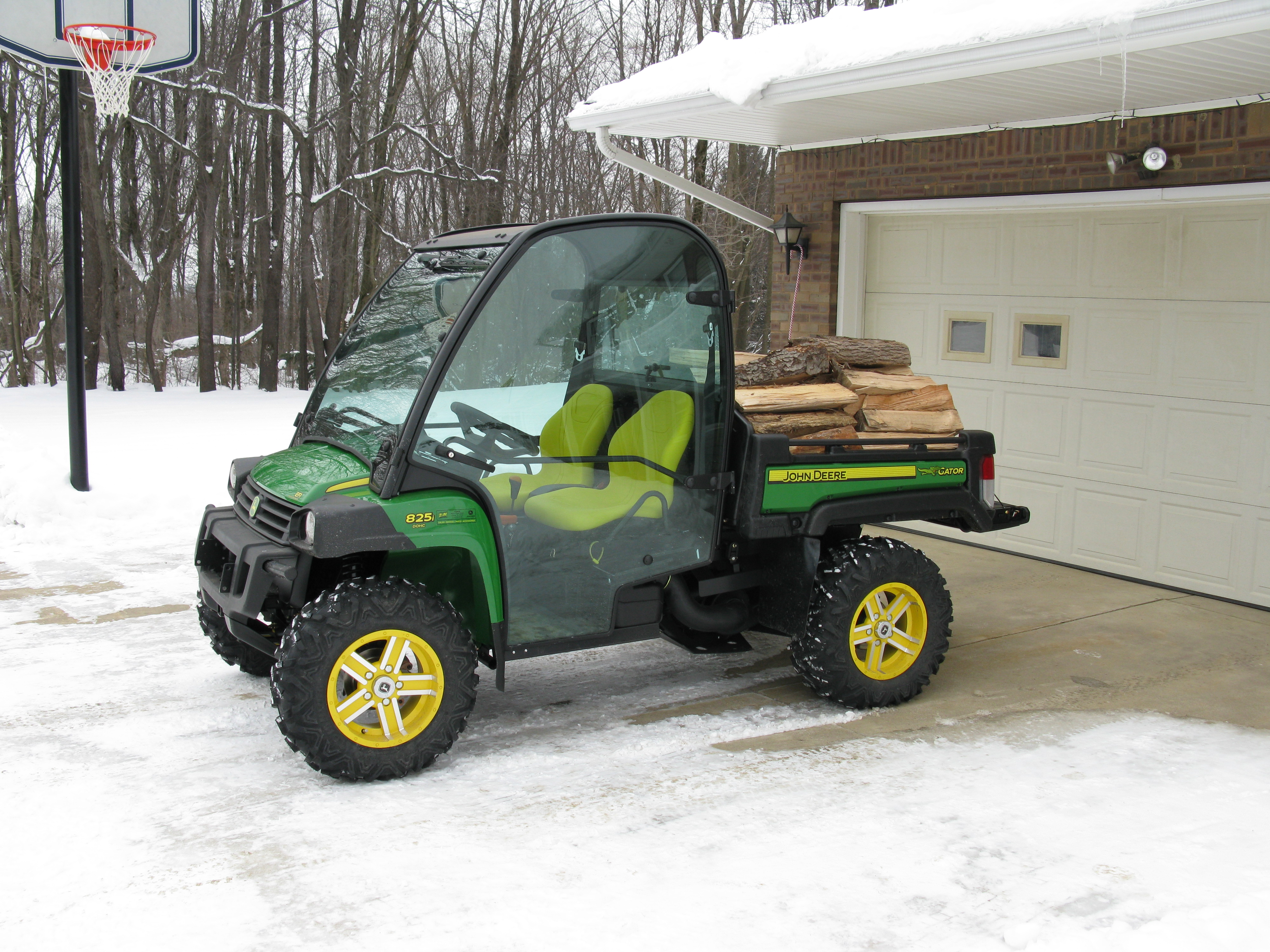

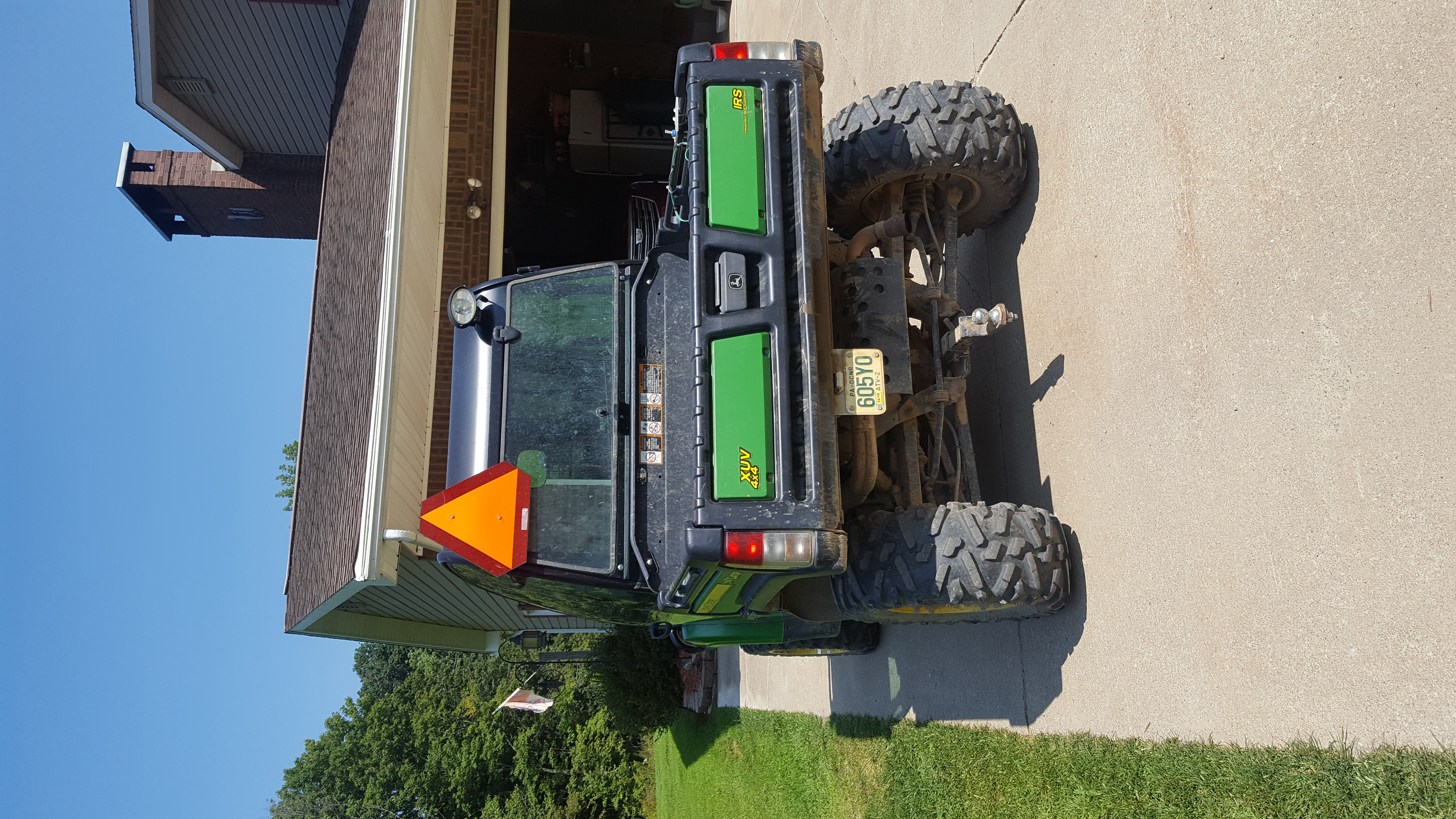

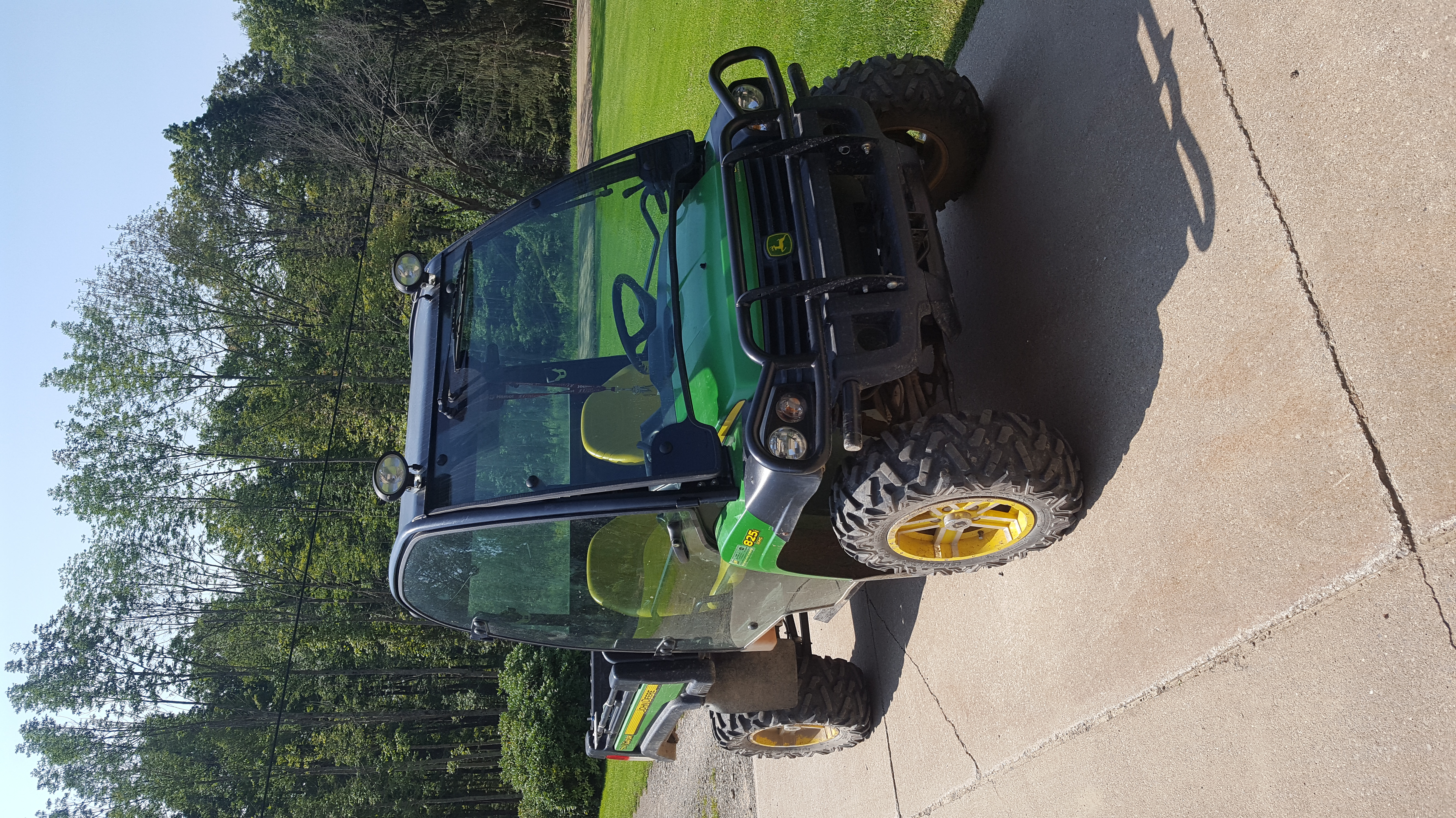

I have a 2010 Gator 825I. I have 7400 miles on it and 812 hours. It is licensed and insured. I had the extra 1 yr. plus the factory 2 for a 3 yr. total warranty. Part of the purchase was that I would install all of the accessories. Heater, power dump, turn signals and 4 ways, horn, extra lights windshield washer etc. I have put in 4 injectors not under warranty, now at $ 157 each. Two exhaust pipes, not mufflers, one under warranty and one I installed roughly $ 190. The head lights got contaminated due to front wheels slinging mud. They were replaced under warranty. I have since installed a rubber shield behind the lights. Brakes are still good, tires starting to wear but still usable. I have plugged I think 3 tries over this time frame. Only one needs sealant occasionally because of I think 2 plugs in that tire. The right front strut is now leaking and I need to replace it. Cost to me $150 approx. The yellow seats have started to crack at their heavy compression areas. I switched the seats, driver to passenger and visa versa several years ago. Now the driver's is looking like the passengers. Maintenance items, three fuel filters and 20 oil changes. So I have averaged about 40 hrs. per oil change. One coolant change. I checked the timing belt at 400 and it looked good guides and wear strips. I need to repeat that inspection now. I replaced 2 alternator belts. It does not have spring tension idler. I am afraid to over tighten the belt and damage the alternator. I have not replaced the drive belt. Have not replaced a light. Not one fuse has blown. All of the wheel bearing are good although none of the axles have ever been below sea level. It is an excellent machine for my use. One item to mention on the injectors. They fall out not because there are dirty and need cleaned but because they leak and there is no repair that I know of. Also the leaking shows up when I have trouble starting the Gator is a gradual thing just slightly hesitant at first and the more difficult later on, several or more cranks before starting. Therefor the injectors changes are one at a time. Because of the high OEM price I tried some after market injectors. It would start good and pull hard without missing but the engine would stumble at light throttle. It also started to fill the crankcase with un-burnt fuel. I then checked the ohm readings and the after market ones were 10.6 ohms where as the factory Siemens are 14.6 ohms. Lesson learned. Hopefully these details will help you decide. Later.
