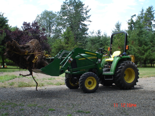

I've had mine for 2 years now with 230 hrs. on it
I use it almost to do anything I want and it always comes up smelling like roses
I like that its not to big to where the wife and daughter can use it so I can get the big stuff done when I get home
I pull a 5 ft bushhog with no problems even when helping out friends of ours with overgrown weeds that were over my head on the tractor
I've cleared tree areas by pushing them over (up to 4in dia.) about 3 feet high with the bucket and letting them dry out and then pulling them to the burn pile
great little tractor
wife doesn't know how we lived without it for the first year and a half
