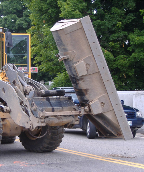

Something like this ?
Wheel Loader Side Dump Buckets
They work great for backfilling ditches, distributing gravel, topsoil, blacktop, etc between curbs and sidewalks ect.
Shouldn't be terribly hard to fabricate but as you can see, height is a concern and the side flow bucket mentioned by diesel scout might be a little more $ and fabrication , but might be a better option in your situation.

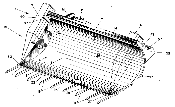

I just searched "side ejector loader bucket" and there are several patents for them but apparently such a limited market, no commercial ones. (second photo)
LOADER BUCKET WITH POSITIVE ENDWARD EJECTOR - US3750816 - Patsnap
