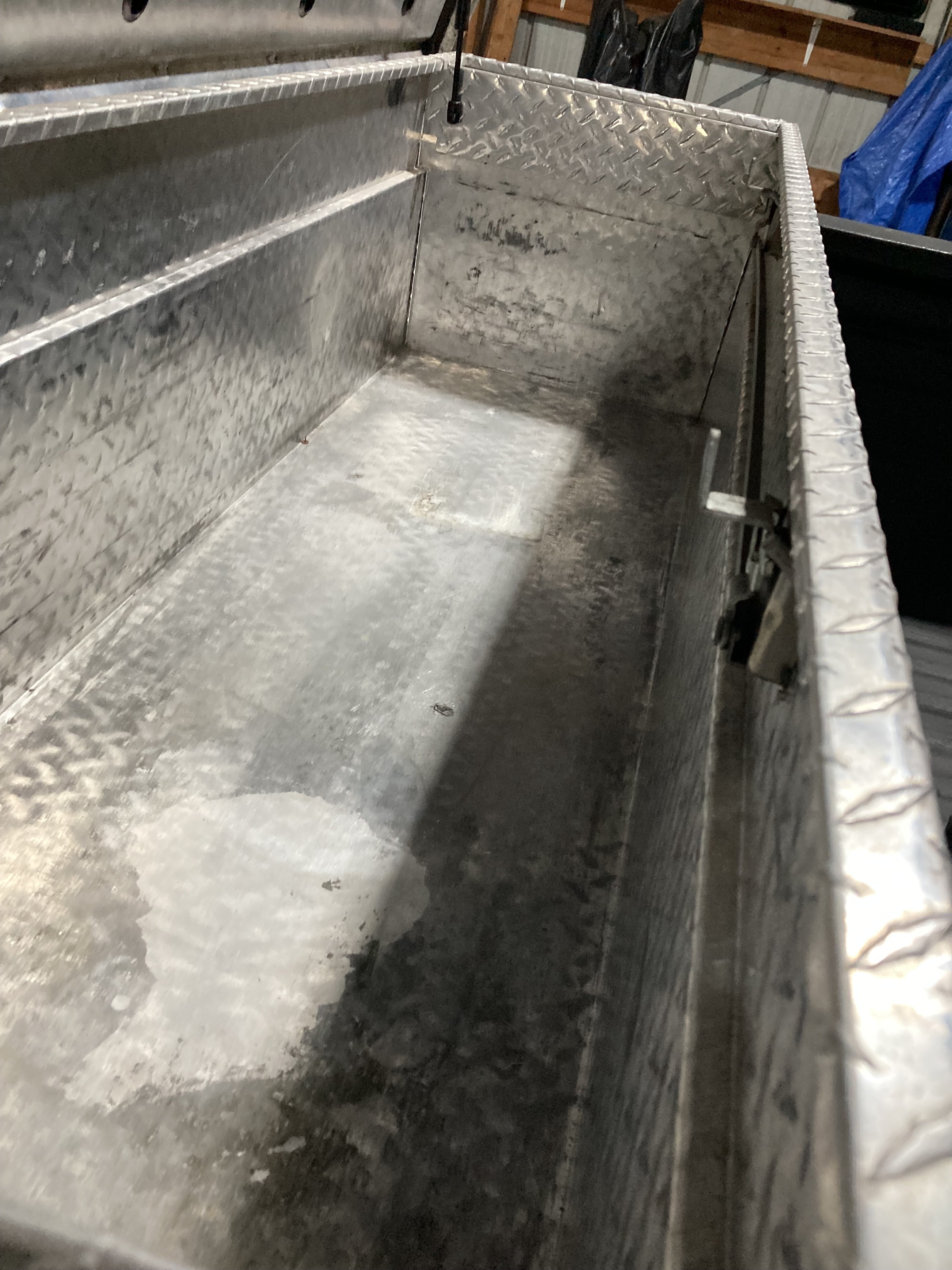

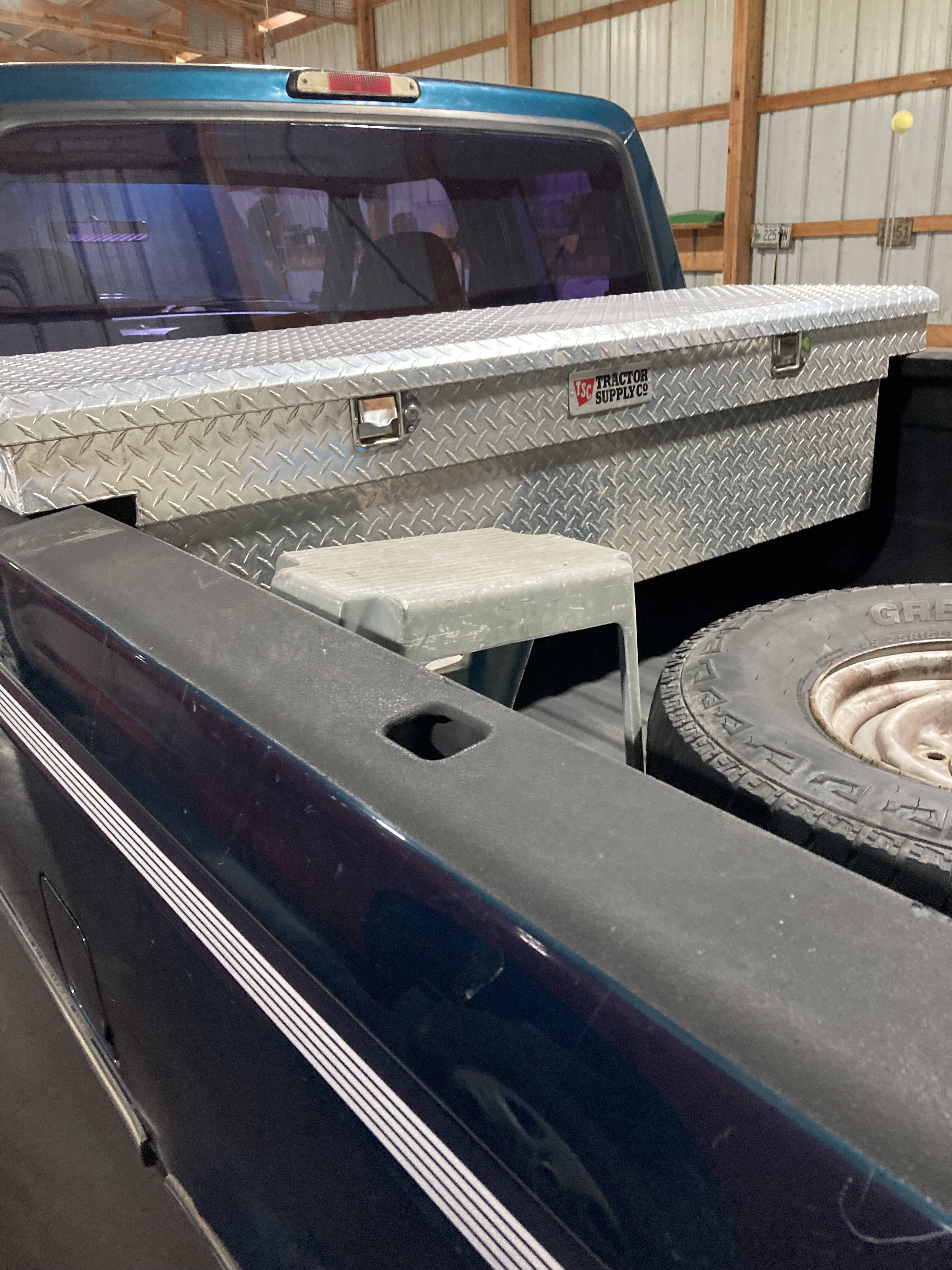

I bought a used truck bed toolbox because I could use it to secure chains, binders, tools and such when I go to auctions. I've never owned one before. It's great but is just a big box with no sliding shelf or anything to make it more useful. As it
There's a lip I am thinking of building a sliding shelf so I can store small tools and yet slide it out of the way but that's all I can figure out so far. Any ideas helpful.

Make a plywood box.bottom rests on inside rails.sides maybe three or four inches max.one bottom four sides and no top

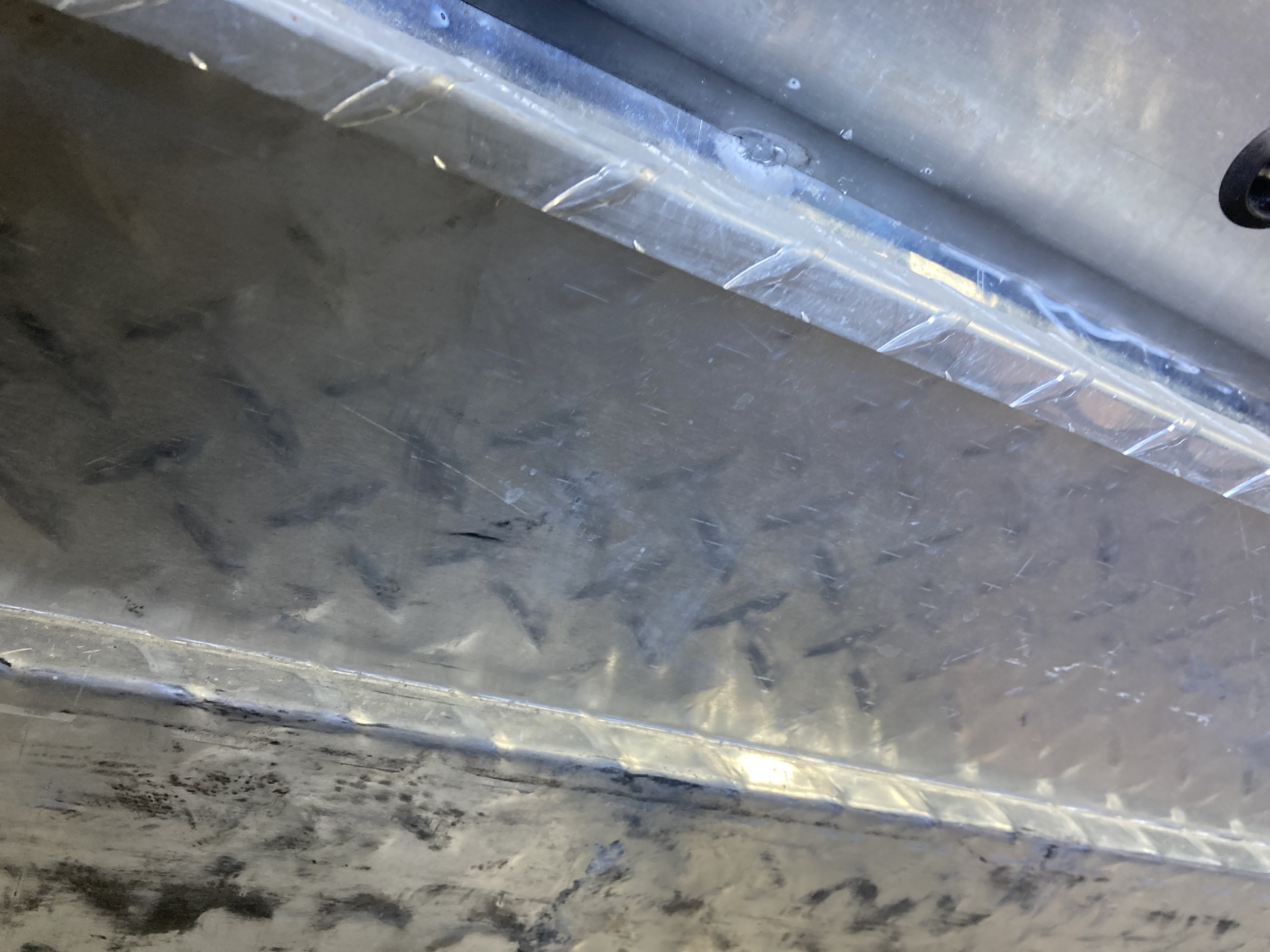

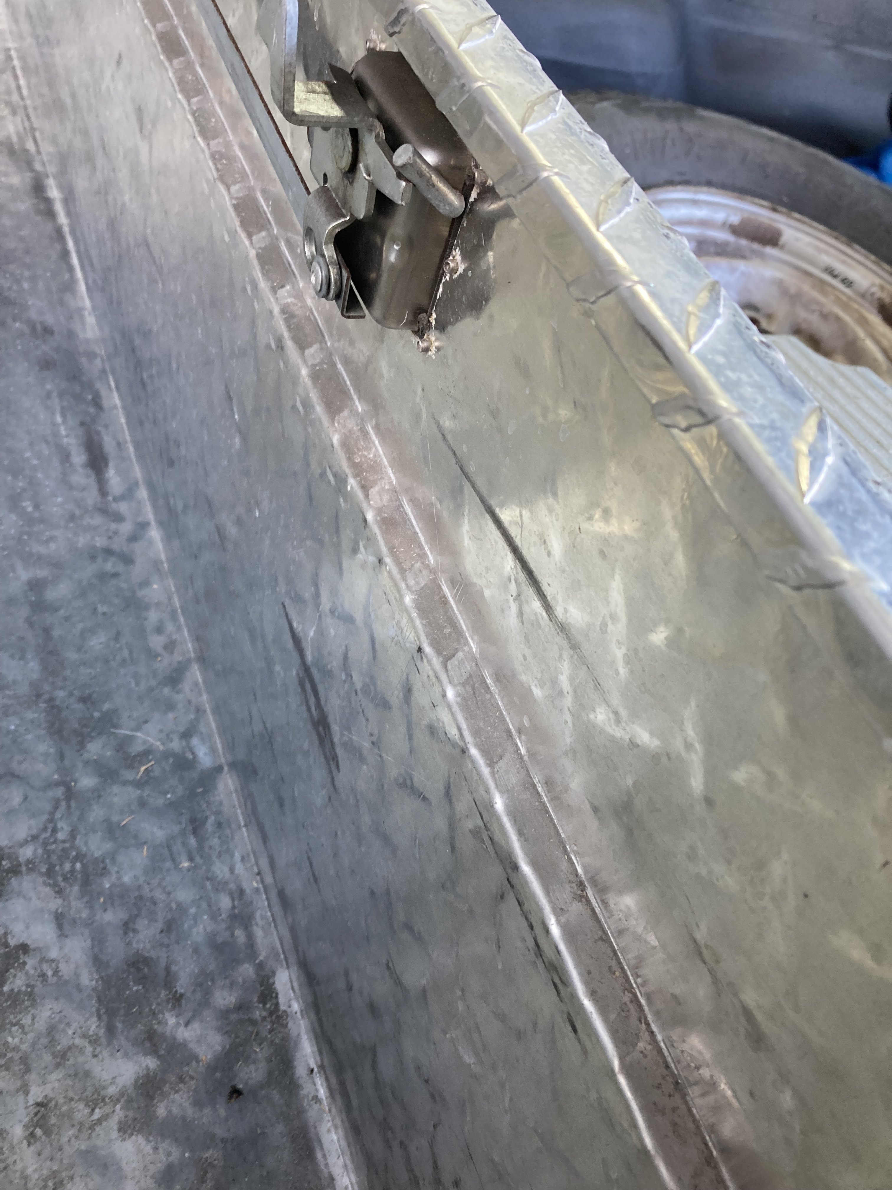

I started with that concept and when I went to cut the bottom of the box to fit, found that because of the top lip I was unable to cut one wide enough to gat inside correctly and sit on that top lip in the side of the aluminum truck box. I could insert a wide enough pice in on an angle but when I went to turn it flat, interference from the sides prevented me from doing that.
When I cut the piece a little narrower to clear the top lip, the plywood was maybe a half inch too narrow for the lip it would ride on and I didn't think it would have enough support, especially as it slid from side to side. I used 11/16" plywood. I tried to show what I mean in the pics below.
I suppose I could build a narrower box that fits in and uses screw on side pieces to slide on the rails and that would work. Maybe there's a better idea?

How about a couple prices of longer angle iron sitting on the lips and the box ends resting on the angle iron?

I have that same box, but gull wing top. It came with one tray that slides in the channel, so I use a short rubber strap to keep it from sliding around. Never made a tray, but you could also make one up and maybe use raised bolts in the top of the channel to keep it where you want it.

If I understand correctly, a fully completed box won't fit in due to clearance issues.
Cut the plywood to the width. Drop it in place. Make a narrower open bottom "box" to a width that will fit. Secure it to the plywood with Kreg screws or angle brackets. I would put a few dividers in the sliding box to keep things organized.
