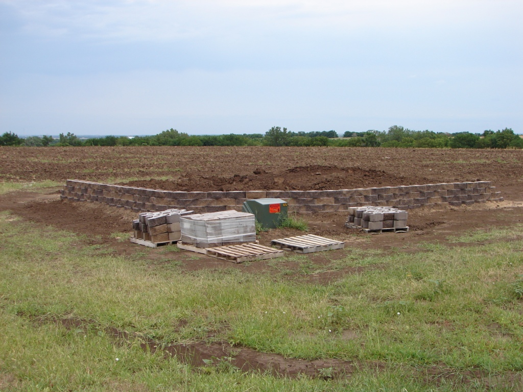

I'm not sure how much "a little money" is, but in my case I had the product delivered. The delivery fee was about $50 and there was no way I could get them myself for that amount. They sat the pallets where I wanted them and had the proper equipment to do so. unless you have a dump trailer with fold down sides, I think you may be creating a lot of work. Again, I don't know how much you are saving, by picking the product up yourself, but just something to think about.
