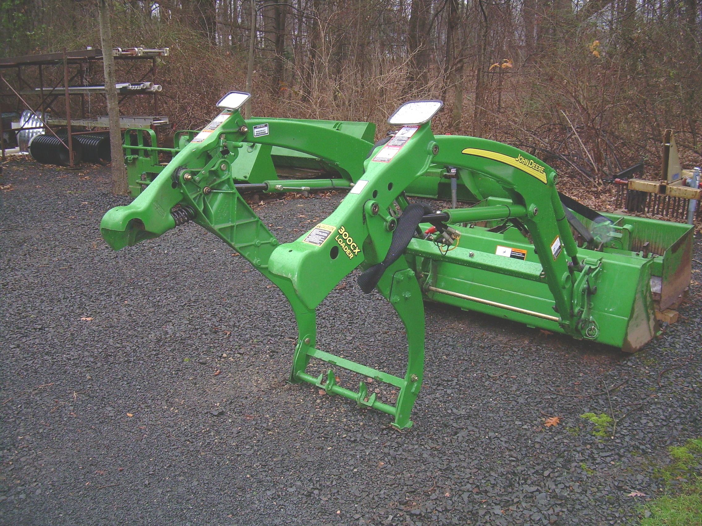

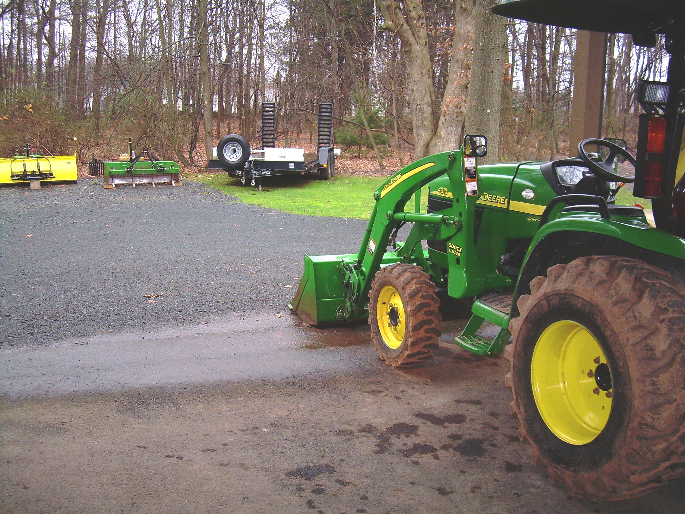

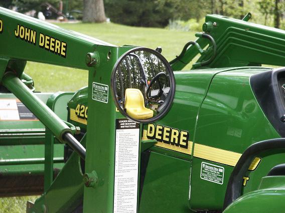

I just put one on both my loader mast and my canopy for the little time I'm in the street.
On JD there's already a handy hole on the loader masts, just bought a couple of dif types of mirrors at auto parts stores and have been experimenting.
It's not perfect but does help. On the canopy there's also a bolt right in the 2 front corners, one I used to mount an extra light and the other the mirror. The way I have them on the loader was easy to try but it would be better if they were mounted outward more.
Only a couple of pics so far, none of the one on the canopy.

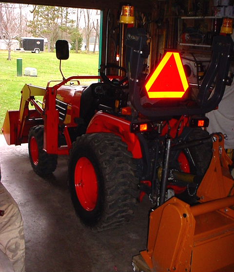

I mounted mine on the bracket that spans the FEL arms on my little Kubota B7510. I understand that many don't have that bracket. The idea of a magnetic mirrors sounds good to me.
