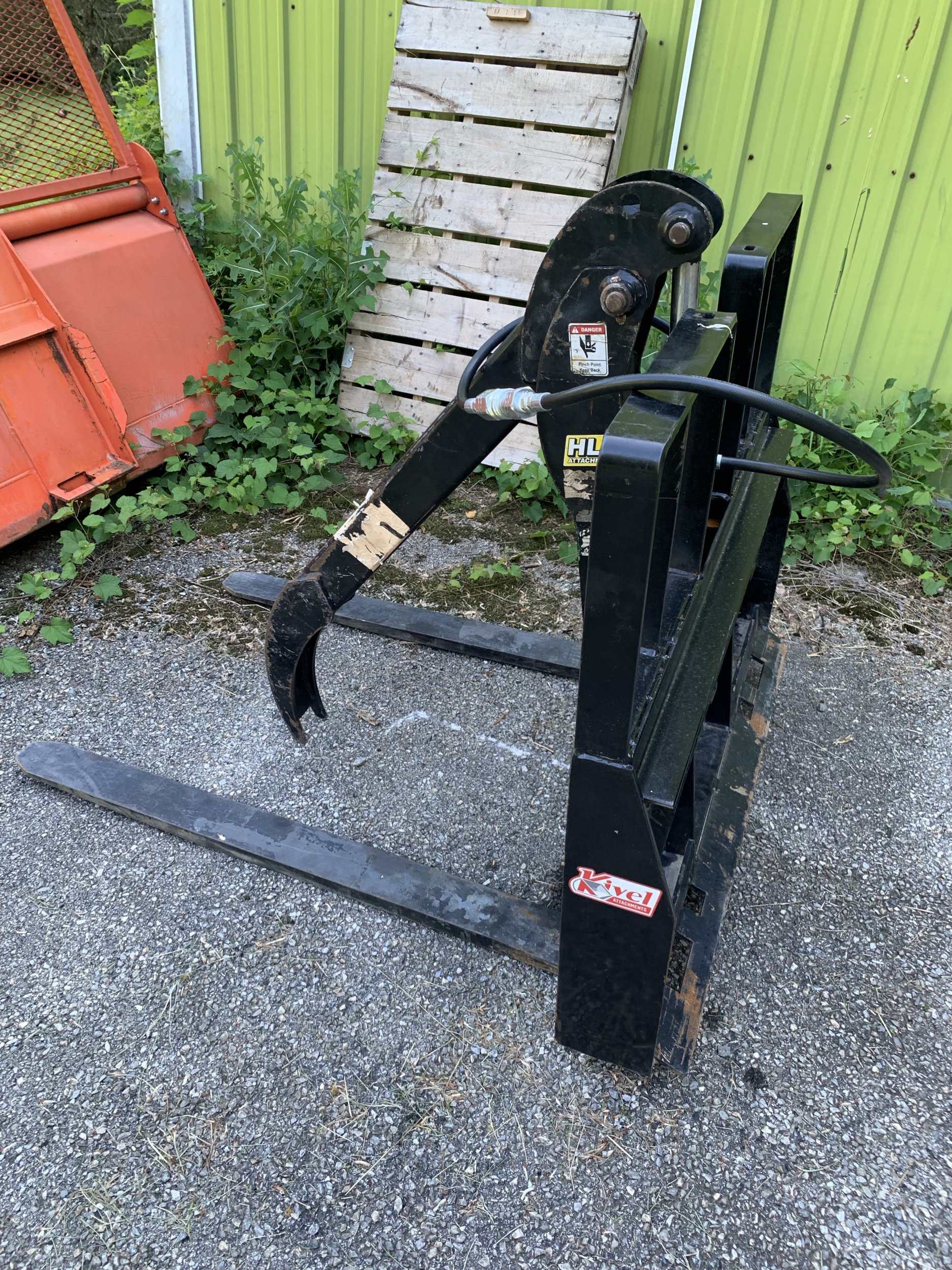

Any idea who made this grappler
   / Any idea who made this grappler #1

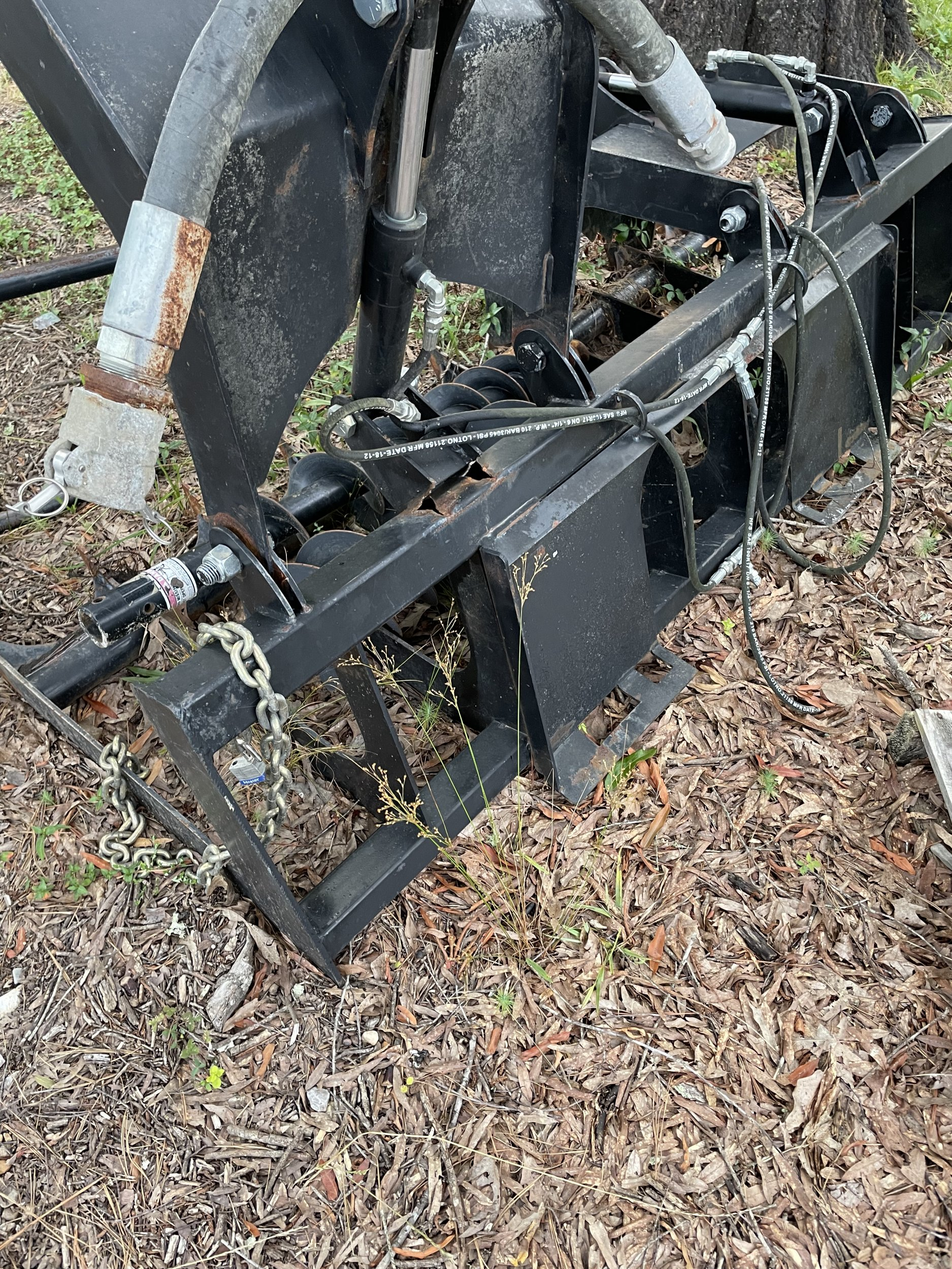

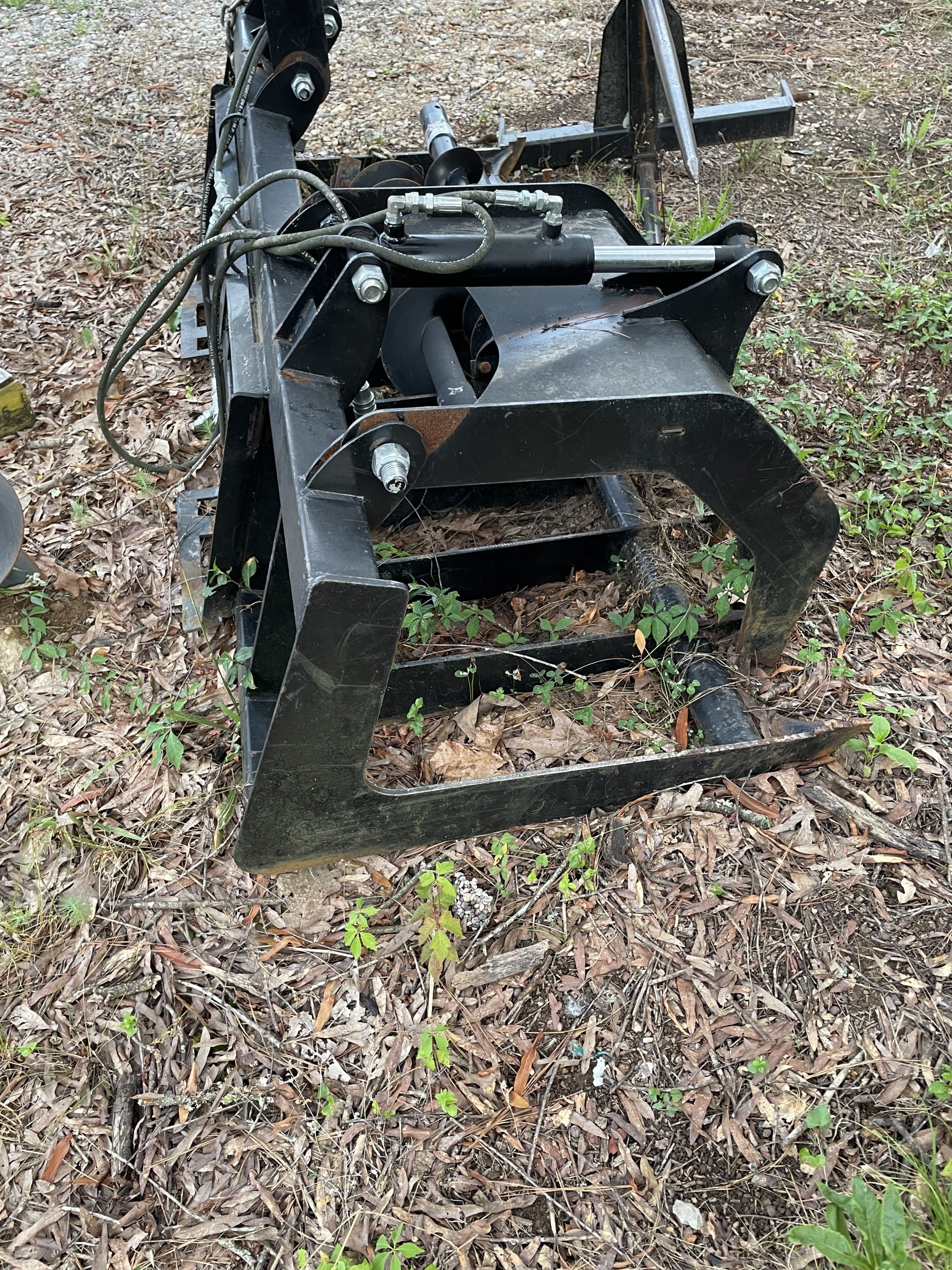

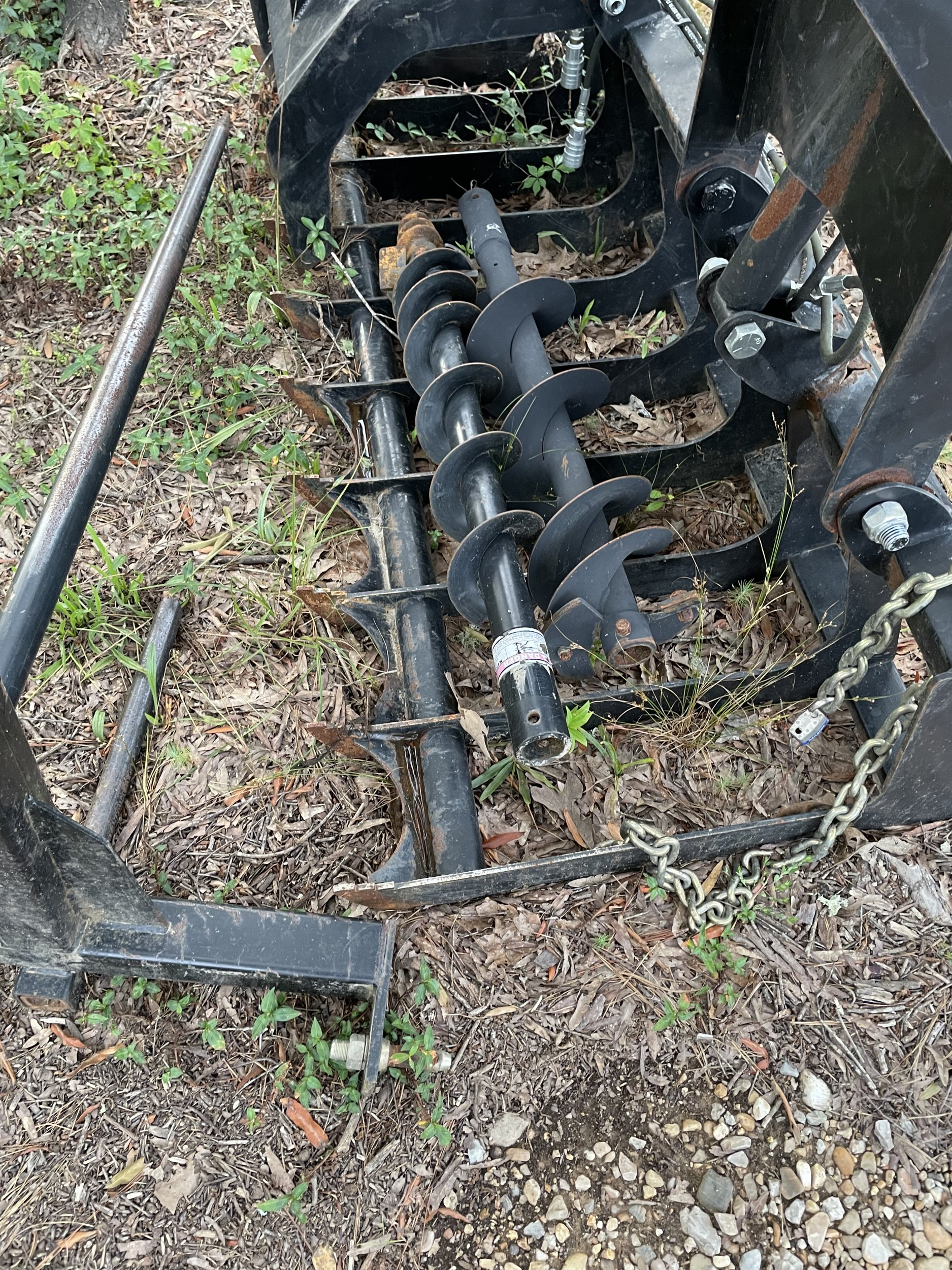

It needs welded on one side but it’s priced cheap. Just trying to see who makes it and thought someone has one like it.
   / Any idea who made this grappler #3
There seems to be a lot of unbranded/no name skid steer implements being sold, usually at auction.
The torn tube looks pretty thin, like made from light gauge metal. I would pass.
   / Any idea who made this grappler #4
No idea who made that grapple. I don't think I would want to take it on as a project. One mount has ripped up and displaced. Both rams are leaking and need to be rebuilt. Notice - no bushing at the major attachment points for the dual lids. I'd pass on this one.

That is a light duty grapple that someone has abused.
I can certainly be repaired.
I bought a new $1200 grapple without greaseable pins, and changed the pins to brass, then drilled and tapped them for grease zerks.
If the greased brass pins should ever wear, they can easily be replaced.
Bolted pins are far from the only problem. It’s the quality of work that went into the whole piece. And you’d have rebuilt the whole mount to really help it. Nothing of quality rides on a 3/8” wide wear area.

it looks like the hinge holes are all elongated by the wear pattern, and that let the top go over center, then someone tried to close it to rip off that cylinder mount.
