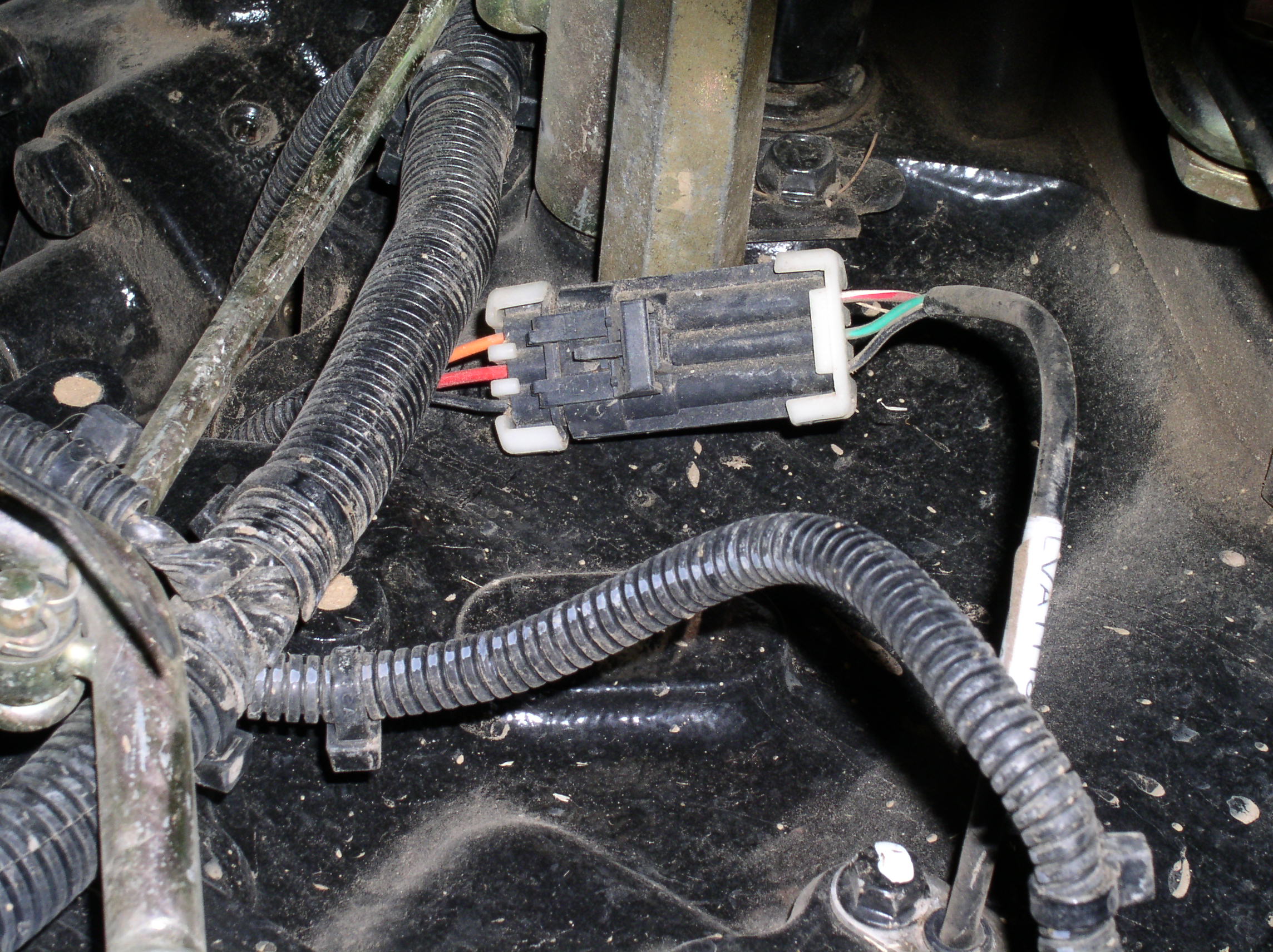

Hi,
I was plowing snow when out of nowhere I got a Err 06 : No signal at MFWD speed input.
The traveling speed display now read 0 mph. I no longer see the error tough and error light is off.
Does any one know where is the MFWD speed sensor so I can check if it's disconnected? I'm on ice chain so maybe vibration got thing loose.

The MFWD speed sensor is located on the side of the transmission on the right side. Look under the foot platform, I think toward the rear of the platform. There should be a 6"-8" wire coming out with a 3 pin connector.

Yep..had it happen to mine too with only 2-3 hours on the clock. Speed sensor....someone on here posted the attached pic. Real easy to change, my dealer knew what it was right away and gave me a sensor (In stock) to take home and replace it.
The sensor is at the bottom of the pic...little white dot on the head of the bolt...
Took 5 mins to replace, only tip I was given was to rub some Vaseline on the O-Ring on the sensor...remove the old one and have the new one ready as hydraulic oil will pour out of the hole...remove & replace.

Thanks all, you were all right, it was the sensor!
Took me about 4-5 min to change. I'm glad you did post this pic so I could locate it! :cool:

Today I followed the advice here and found the 3-pin connector to the sensor had separated, probably from the pressure of deep snow pushing against it. It clicked together easily and I routed it a bit higher for "next time". Easy stuff. Oh, I used an old flat carton from a storm door to put under the tractor so I didn't have to lie in the mud. That's a keeper! Thanks again for the good information.
