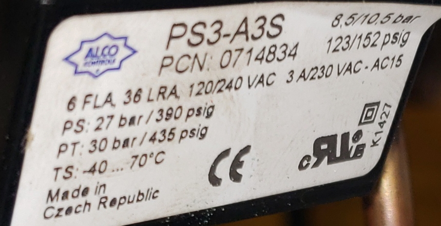

I got a free Quincy QRHT-25 compressed air dryer, not working. I opened it up and found that the pressure switch going to the refrigerant compressor on one of the refrigerant lines had come apart and dumped all the refrigerant out. A new pressure switch costs $300 and I don't want to invest that much into something that I can't reasonably expect will work afterwards. So, can I reasonably expect that installing a new pressure switch, pulling a vacuum and recharging it with R134-A, will result in a working dryer? Or is it more likely that the loss of refrigerant ruined the refrigerant compressor? The compressor does come on when I plug it in; I just don't know if it would compress refrigerant if there were any refrigerant to compress.

My first guess on it would be to plug where the switch was and pull vacuum. Can't substitute another pressure switch?

Did you price the switch from Quincy, a refrigeration supply, or internet like Amazon? Quincy will mark up again anything you get from them. Is is a high or low pressure switch? What was the original refrigerant? If R-12 or 22 changing to 134 may not be that simple as most refrigerant metering devices are refrigerant specific. Add the cost of a dryer also.
Decision time is what would the value of the dryer be if you fixed it versus to cost to do so. It takes more than a vacuum pump to do the repair. Probably takes more refrigerant than a DIYer can buy over the counter. The cans at the auto store are very costly when you need many of them.
LOL, Ron
I'm sure I could find an alternative but my pattern recognition/intuition is telling me that this is probably one of those rabbit holes where it sounds simple but ends up taking 24 man hours find a replacement which isn't even that much cheaper.
LOL, Ron
The part number is PS3-A3S. According to the datasheet I believe it is a low pressure switch but the data on the actual label makes me question that. Also since the compressor immediately turns on when I plug it in (with the switch completely removed from the circuit) it seems to me it would be a high pressure switch.
LOL, Ron
Just realized I didn't answer all your questions. It is R134A from the factory. I wouldn't be changing anything. I don't know about oil though. Should oil be added you think? When a refrigerator system suddenly loses pressure is all the oil blown out?
I doubt this thing takes much refrigerant at all. It's a tiny system, much smaller than an automotive A/C and even smaller than a window unit. I believe it is 400W total for the whole thing.
