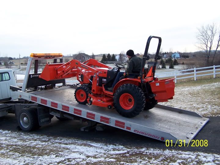

I was in the exact same position as you a few weeks ago -- making comparisons between the B3030 and the 2520.
They're both very nice tractors. I'm sure I would've been very happy with either one of them.
Be sure you take them both for a test drive. As everyone always says, dealer is very important too. That's part of what won me over to orange in my area.
Here's how it turned out for me:
The prices were about the same, but the Kubota just felt like more tractor for the same $$. And in your situation (lots of mowing), it's a fairly light tractor with a fairly high HP for it's class. Something to consider.
Good luck!
