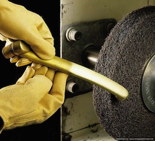

I use mine mostly for cleaning bolt threads and rust removal. I do have the shield on the grinder and I use eye protection, but I am getting tired of flung wires.
I've seen abrasive rubber bristles
abrasive bristle disc - Google Search
and gritty mesh wheels.
These would work for the rust, but will any clean rust and dirt from bolt threads without removing the crest of the thread?

No but a triangle file will clean threads real well a lot safer than a wire wheel on a grinder. Worst case a hand brush I don't like using power brushes and I work with steel for a living.
   / Any good, safer replacement for a wire wheel on a bench grinder? #3
There are different types of brushes that don't sling the bristles out as bad but none that I ever came across that were bristle throwing free. Perhaps you would be better off with a rust dissolving liquid soaking solution containing phosphoric acid.
   / Any good, safer replacement for a wire wheel on a bench grinder? #4
I've never found a better product to the wire wheel. However, I replace them regularly and only use a quality product. Check with Lawson or your local welding supply- skip the hardware store or big box stores. As you stated one flying wire is all it takes to make a bad day.
The angle grinder wire wheels seem to be a bit safer as they send product away from your body instead of toward your body and down.

I either use an angle grinder with a brush designed for its high RPM, or a lesser, "regular" brush chucked in an arbor in the drill press on its slowest speed. The angle grinder throws a few, but as noted, usually away from sensitive areas. The drill press also sometimes throws a few, but at a low enough velocity to not be too dangerous. I always use a full-face shield.
