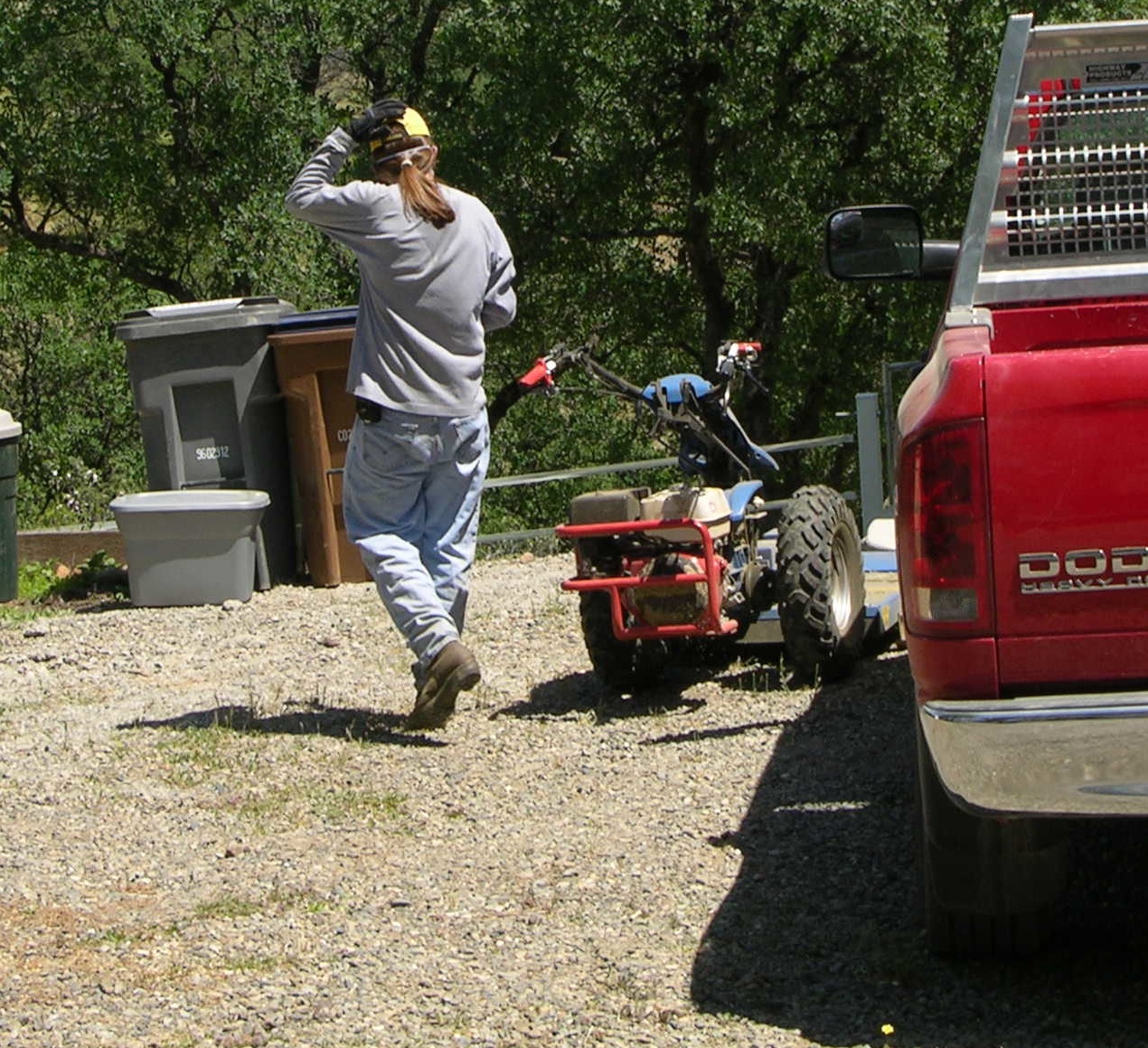

When I bought the BCS I had about 3 acres to mow under a bunch of oak trees on some steep terrain, so I got rid of the stock tires and put a set of the Dunlop 23 X 8 X 10 KT401 tires, so that I wouldn't keep dragging the engine whenever I went though a ditch. They would probably work fine in the snow, but I think that they would swallow chains, and might be a little tall to work with the snowblower. I'll have to couple it up and see what it is like, I'm going to be running a quick attach and a pto adapter, so that should put the snow blower a little further. I'm just looking for good ideas, I'll probably end up purchasing another set of stock rims and putting the stock tires on them, or buying some smaller ATV tires.
