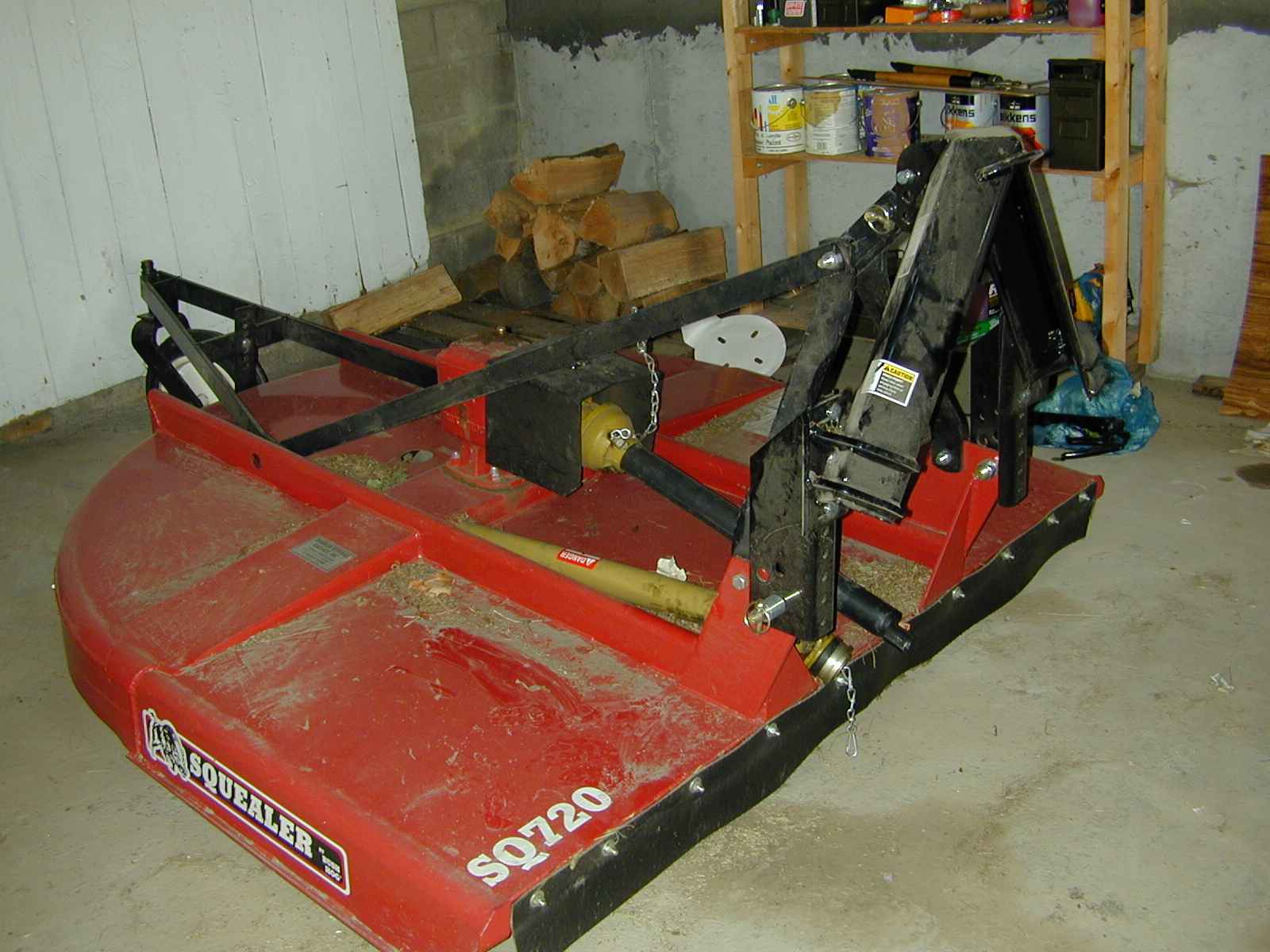

I use the Freedom Hitch system for most of my attachments. It consists of a tractor section and an attachment section for each attachment. I just back up to hook up from the tractor seat (the PTO must be attached by hand). Photo shows my 72 inch rotary mower with attachment piece (large V section).

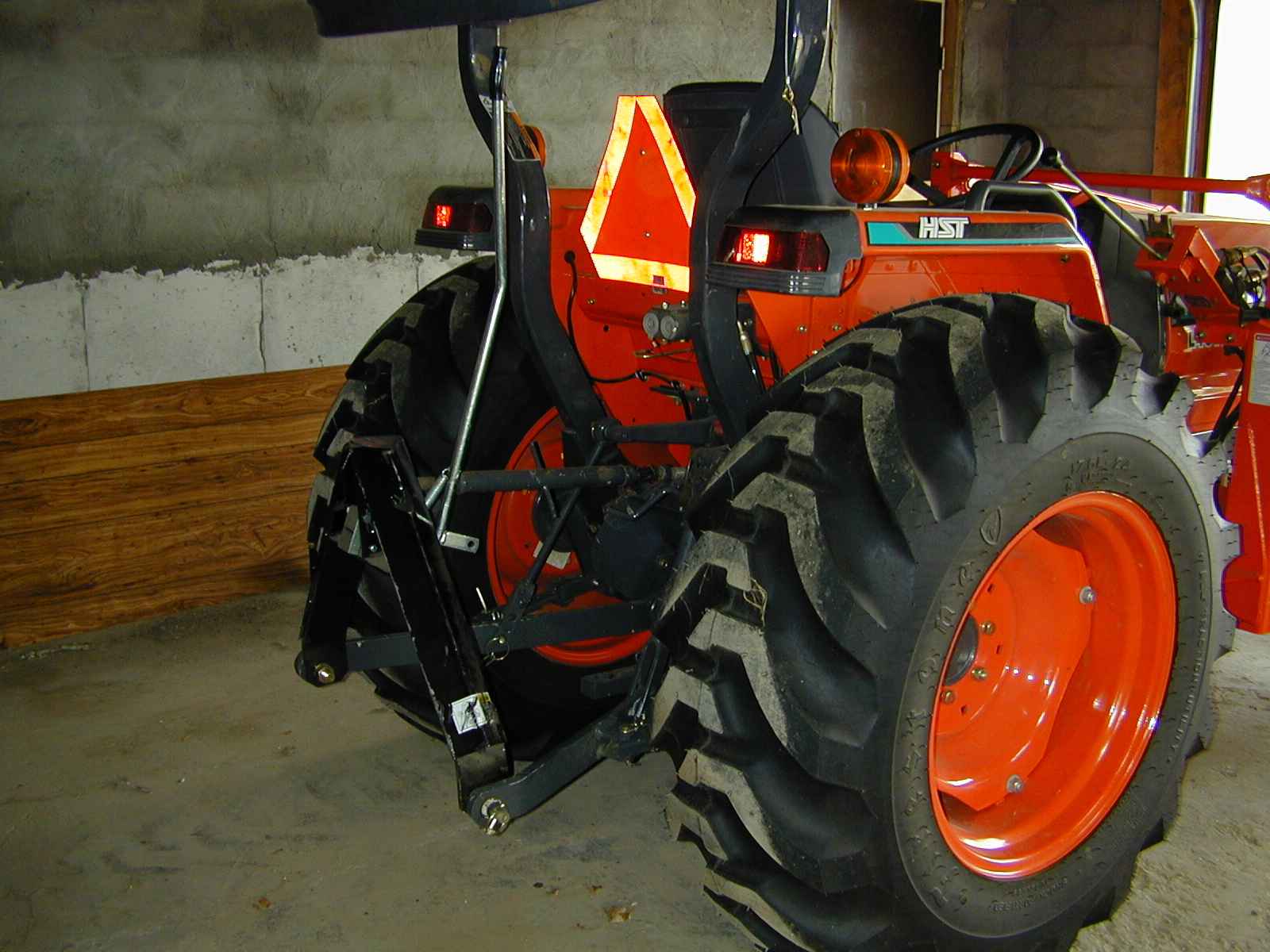

This is the tractor section photo

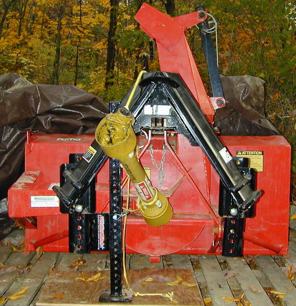

Here's my snow blower with the Freedom Hitch V piece and also shows the support piece they have that levels the attachment. (Hopefully this photo will not be as large as the last ones).
Pokbill
