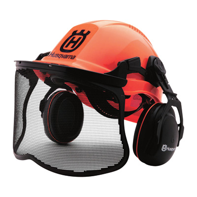

Oh, yeah, just today something hit me hard in the face while I was mowing. I think it was a piece of drip irrigation tubing that I accidentally ran over. I'm still not clear on how it ended up hitting me in the face. Maybe it got wrapped around the flail axle and whipped up and hit me in the face. But it hit VERY hard, and I was initially concerned that I might be injured. I had to stop mowing and go look in the mirror. Just a minor cut. Anyway, I recommend you avoid mowing over irrigation tubing, obviously, but it might be a good idea to wear a chainsaw helmet with faceguard while mowing. I know I will do that from now on.

You make a valid point about the bumper being down to protect from flying objects. I was thinking more about getting material into the rotor, not about objects flying back out. If the bumper is higher, the material will flow in better, but you do increase the risk of flak.
As far as your experience with the flak (my guess would be ricochet off a fencepost, tree, or wall), get yourself a chainsaw helmet. I use mine for sawing, trimming, and running mower. Long sleeved shirt, denim pants, gloves, and boots are a good good idea, too.
EDIT - should have added "safety glasses" to the list of items that should be worn. They're just another line of defense for your eyes under the mask's screen.

Yeah, maybe could have been a ricochet. As far as the bumper goes, I just followed the directions in the manual for lack of any contrary advice. I did notice that the fingers bend backward to allow material to flow in, but they don't bend forward to let things out. That is the extent of my experience with it. ;-)
I agree about the chainsaw helmet. I have one and will always wear it when mowing from now on.
