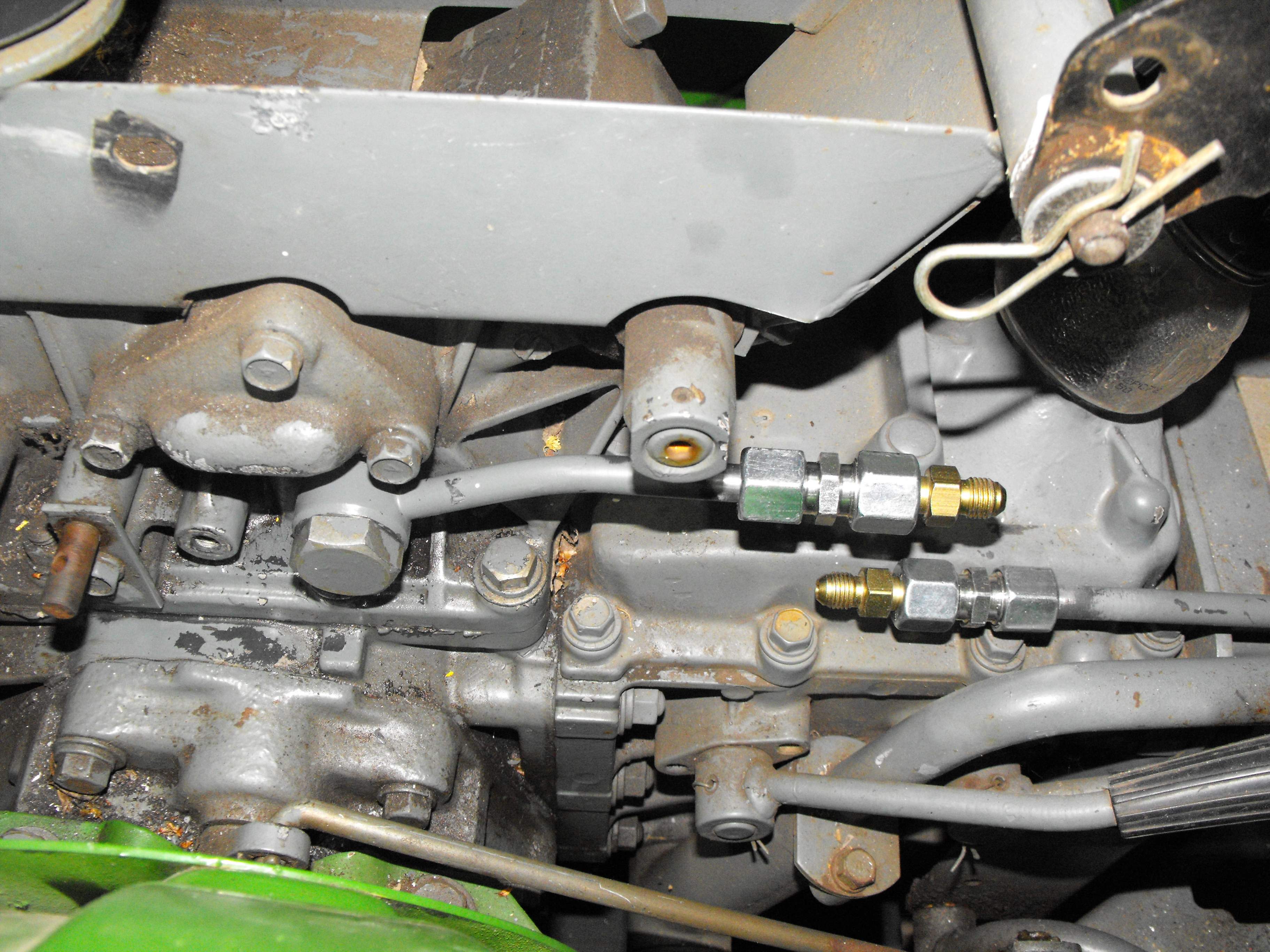

Does anyone make a top link cylinder, with a DPOCV, that doesn't rely on banjo connections? I raised the 3-point too high and bent & broke the steel line that's crimped into a banjo fitting. If I'm going to spend another $200, I want something that's serviceable. Even though I have removed the old manual top link support, which caused the problem.

Banjo connections....so this is what they're called....are these true fact factory applicatications...meaning....if you have these type fittings your stuck with using them....I'm not too sure or remember if I asked...when I was getting my new fittings...don't mean to hijack this thread....but I knew these fittings had a name but couldn't remember for the life of me...any options to some after market fitting...or custom made fitting...here's a photo of my setup

Not that I know of....They are used because they are a much lower profile than any other type fitting. Post a picture, I am sure yours is repairable.
   / Any banjo-less top link cylinders w/ DPOCV? #5
No, you're not stuck. Banjo bolts are either metric thread or the same thread as BSPP. Take your banjo fitting and bolt to a good hydraulic shop and tell them what you want to do. A box of donuts is always a good idea too. Anyway, you can replace the banjo fitting with a port type male fitting. I believe your fittings will be BSPP. You can get a bspp to jic adapter in straight and 90. Any good hydraulic shop will know exactly what you are trying to do.
