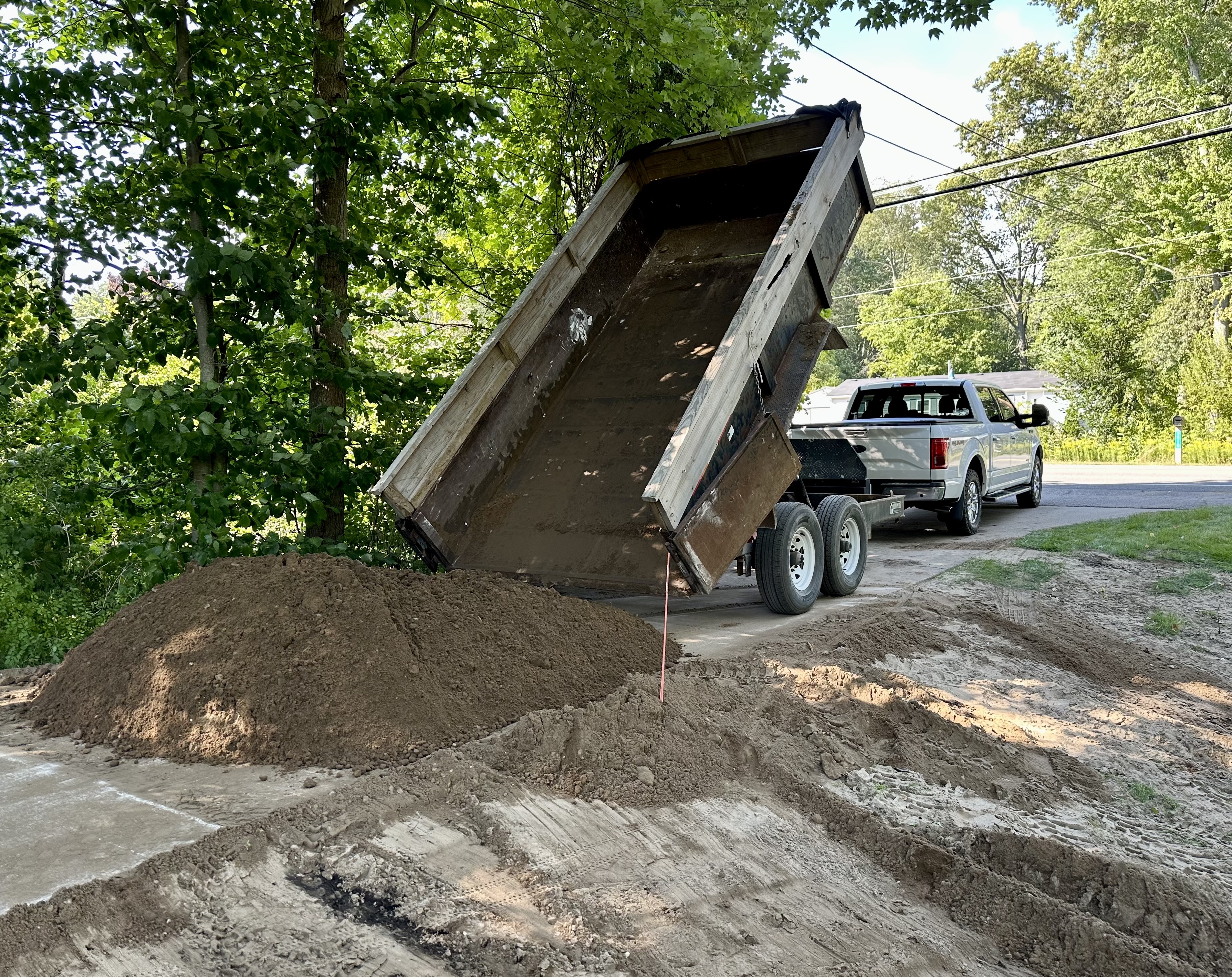

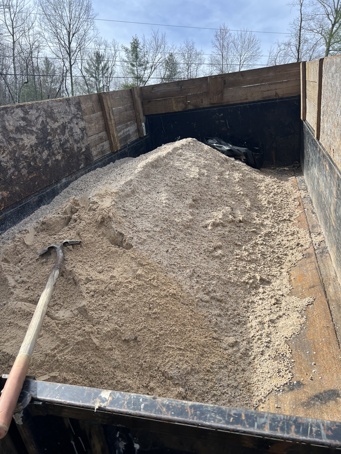

I would get the tall sides. The 2 ft sides don’t hold enough trash to make the trip worth it. Even with 4ft sides I can usually only fit 3500 pounds or so of trash. I’d definitely get the 7 gauge and I’d get a telescoping cylinder. This load of sand weighed 5.3 tons and my trailer did dump it with a scissor hoist but it’s easy to overload a scissors hoist.

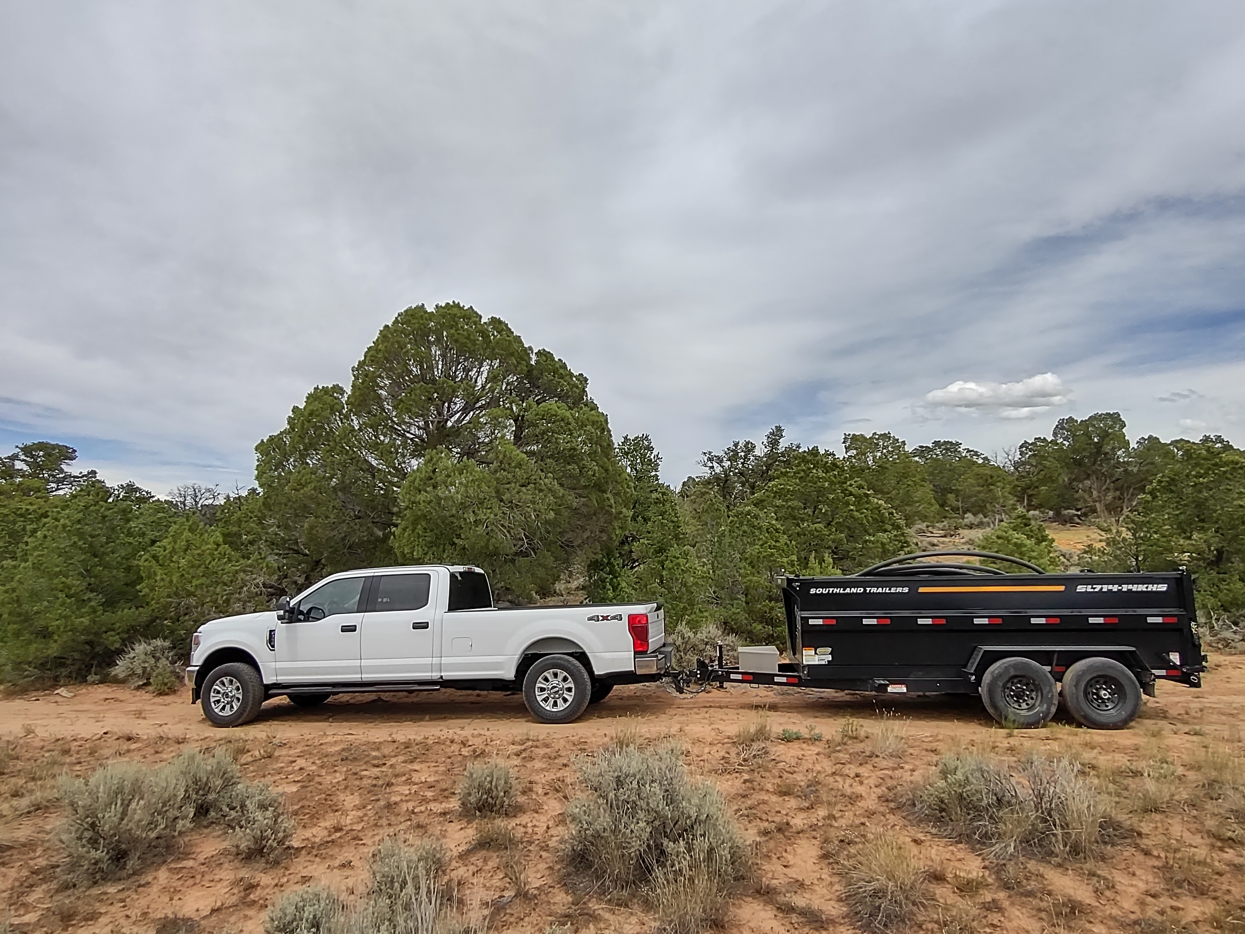

Thanks for the help guys!
I spent all day calling around to see what kind of a deal I could get. Best deal I could find was a Lamar that ticked all the boxes. It had 3ft sides, 7 gauge bottom and telescoping cylinder for $13,000 OTD.
Then, just as I was getting ready to call the guy back to purchase, the wife checked FB market place one last time. Someone just posted a 1 year old, barely used southland trailer. 4ft sides, 10 gauge, scissor hoist, for $8.5k. New they are not the best deal at $12K, but this one was too good a deal to pass up.
So the total for the truck and trailer is $45,300 + sales tax. I'm pretty happy with that, given the truck still has 15 months & 10K miles on the factory drive train warranty. It doesn't look like it's ever had a trailer hooked up to it and the bed looks almost new. Hopefully, it has plenty off life left in it.
