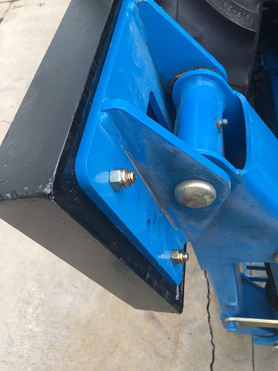

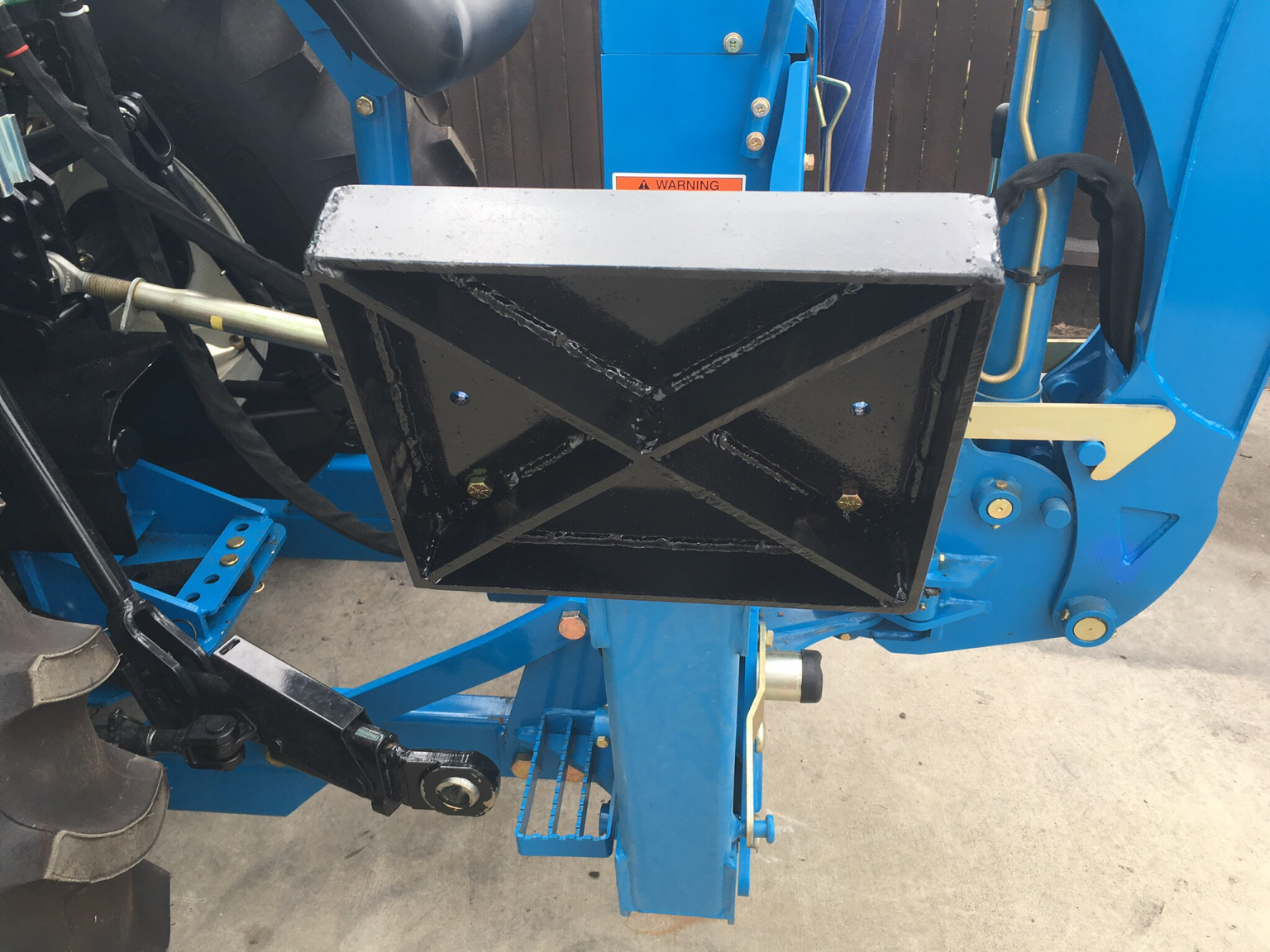

The backhoe stabilizers don’t come with feet. You can buy them if you look hard enough, and they are like $150. So I made my own.

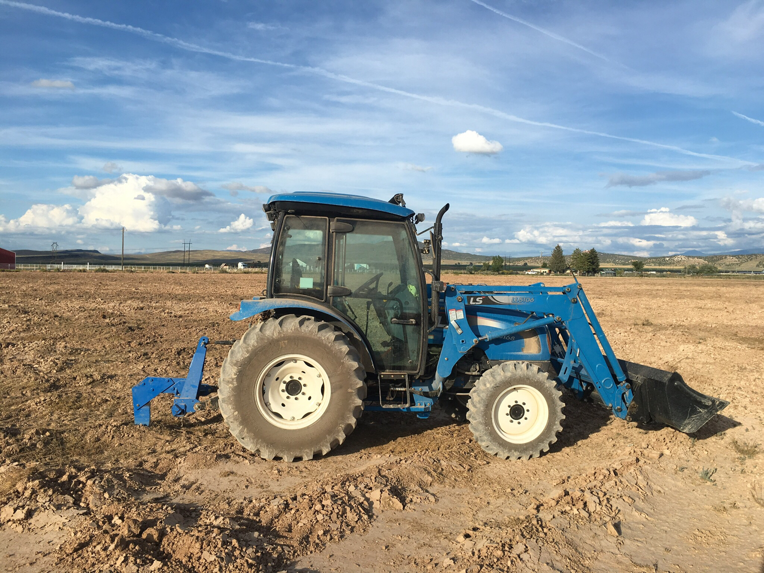

Here she is the day I picked it up and the stabilizer feet I made.
